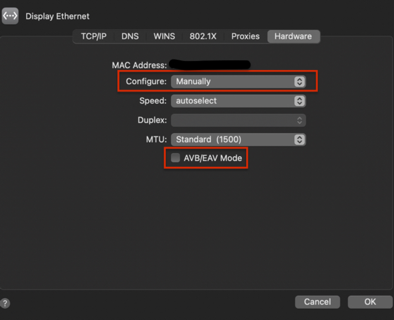

I’ve been running on DHCP for two months now with the Apple Thunderbolt to GigabitEthernet adapter with AVB/AEB disabled. I haven’t had a single disconnect since I disabled AVB/AEB.

I think I finally found the fix for this issue. I needed to disable the AVB/EAV mode. This is a relatively new standard that reserves the Ethernet bandwidth for latency / jitter sensitive audio/video traffic to provide low-latency and low-jitter medium for that traffic. However, the Ethernet switch that the Ethernet adapter supporting this standard is connected to must also support this standard in order for this feature to work. Almost no consumer-grade Ethernet switches support this standard, and not even all Cisco enterprise-class switches support it. For example, Cisco 3560 Series switches (or lower-end / older switches) do not support this standard. This standard is supported in Cisco 3650, 3850, and 9000 Series switches.
So, when I disabled this standard under the Thunderbolt Ethernet adapter and re-enabled DHCP, the Thunderbolt Gigabit Ethernet adapter (built into the Apple 27" Thunderbolt Display) connected, obtained DHCP, and has been working for a week now without any issues. Please see the attached screen shot to see how you can disable AVB/EAV in macOS System Preferences -> Network.
I tried this with my Apple Thunderbolt 2 Ethernet adapter using an Apple TB3 to TB2 adapter and initially my M1 Pro MBP got an IP address via DHCP, but after unplugging it and re-plugging it back in, my MBP just started using a self-assigned IP address. I tried your fix with setting Configure to Manually and disabled AVB/EAV Mode, but it had no impact. Nothing else was connected to the MBP at the time. It will only use DHCP if I have it set with a manual address, so it behaves no differently than my TB3 CalDigit dock ethernet ports or my USB-C Anker ethernet adapter unfortunately. Hoping for an official Apple fix soon...
