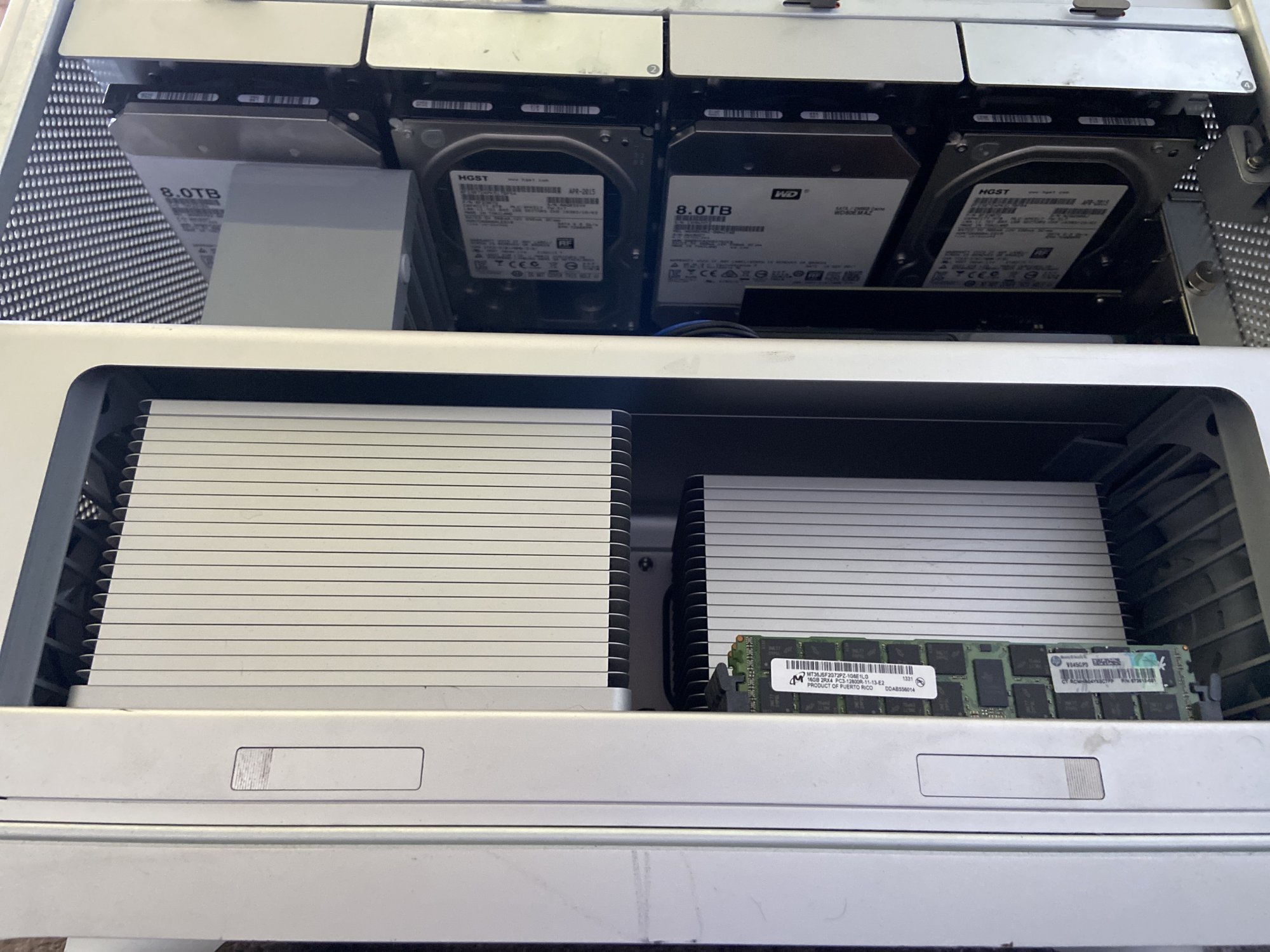

I opened up the computer today to check what I have to order along with the new HDD and see that I had already done what you suggested. A SATA power splitter connected to the lower optical bay, and a new SATA cable from the "lower" SATA socket on the backplane PCB. In addition I had installed another SATA cable from the PCIe SATA card, underneath the power supply (and the backplane PCB I think), but alas it's too short.
It was too much of a hassle to remove for now (I even unmounted the power supply but I also have to remove one of the PCBs which it goes underneath (the backplane PCB I think) but believe it's roughly 50cm long, so I've ordered a couple of 70cm SATA cables to replace it (attaches to the SATA PCIe card's two internal ports).
This means I can have up to 3 SATA storage devices in the lower optical drive bay! (provided I split the power cable again with yet another Y adapter)
I already had an Orico 5.25" to 3.5" adapter bracket (which can take two 2.5" drives), but now I've replaced it with a Sharkoon 5.25" BayExtension bracket which can take a combination of a 3.5" drive and two 2.5" drives. Or four 2.5" drives.
So for now I can attach the new 10TB HDD on top (with two screws as the bracket doesn't have the "new" screw hole scheme; but it doesn't really matter as it won't be upside down as with the Mac Pro drive trays, and the bracket also has rubber shock mounts alongside those screw holes -I've tried it with an old HDD I had laying around (with the standard 4x screws though).
And underneath I have a single 2.5" SSD.
Provided I get those longer SATA cables installed I should have a nice working solution 🙂

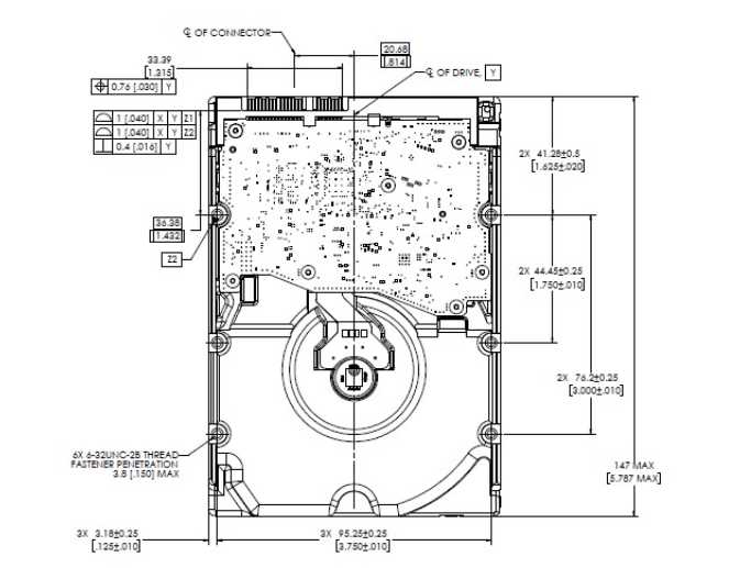

The way I see it we’re lucky to have a company that offers drive trays with the new hole pattern, you should buy them while they’re still available because they won’t be forever.
Dumb question, but why can't you just drill out the old sled to accommodate the two new holes?
edit: nevermind. looking at it now, I see it would need an extra length screw and possibly some nylon washers. still seems a bit ridiculous to pay those prices for drive sleds when you could modify the ones you have easily enough. When I wanted to stuff two 3.5 drives in the ODD, I did opt to buy an OWC sled, but that was different because I had nothing on hand that would fit in that space without vibrating.
