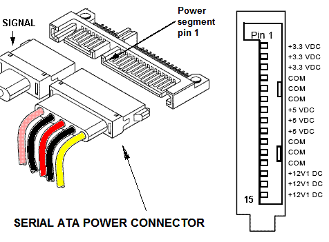

Questions that came up were if the drive would spin up at power up and stay usable after a warm boot where some drives required taping pin 3 to get them to spin up
This feature is called Power Disable and its designed to be for a hard reset for compatible modern drives by the host computer . The installation concern is when you have certain modern HDDs connected to legacy power supplies , that conflict with what they want to do with pin number 3 of the 15 pins of the power portion of the SATA connector . Old power supplies can't deal with this feature as they expect pins 1 to 3 to have 3V of juice . New drives with the power disable feature want to use pin 3 to receive a reset request signal from the computer . Thus , the legacy power supplies supply continuous 3v of juice through pin 3 , forcing the hard drive into a continuous reset condition . Which means the drive can't be used until the juice stops flowing . When you tape pin 3 of the drive , you neuter its ability to hard reset and allow its use with legacy PSUs .
What PWDIS feature drives have :
What legacy power supplies offer :
Combine the two for a double plus unfun day .
Thanks for a very clear and good explanation! Illustrations help 👍

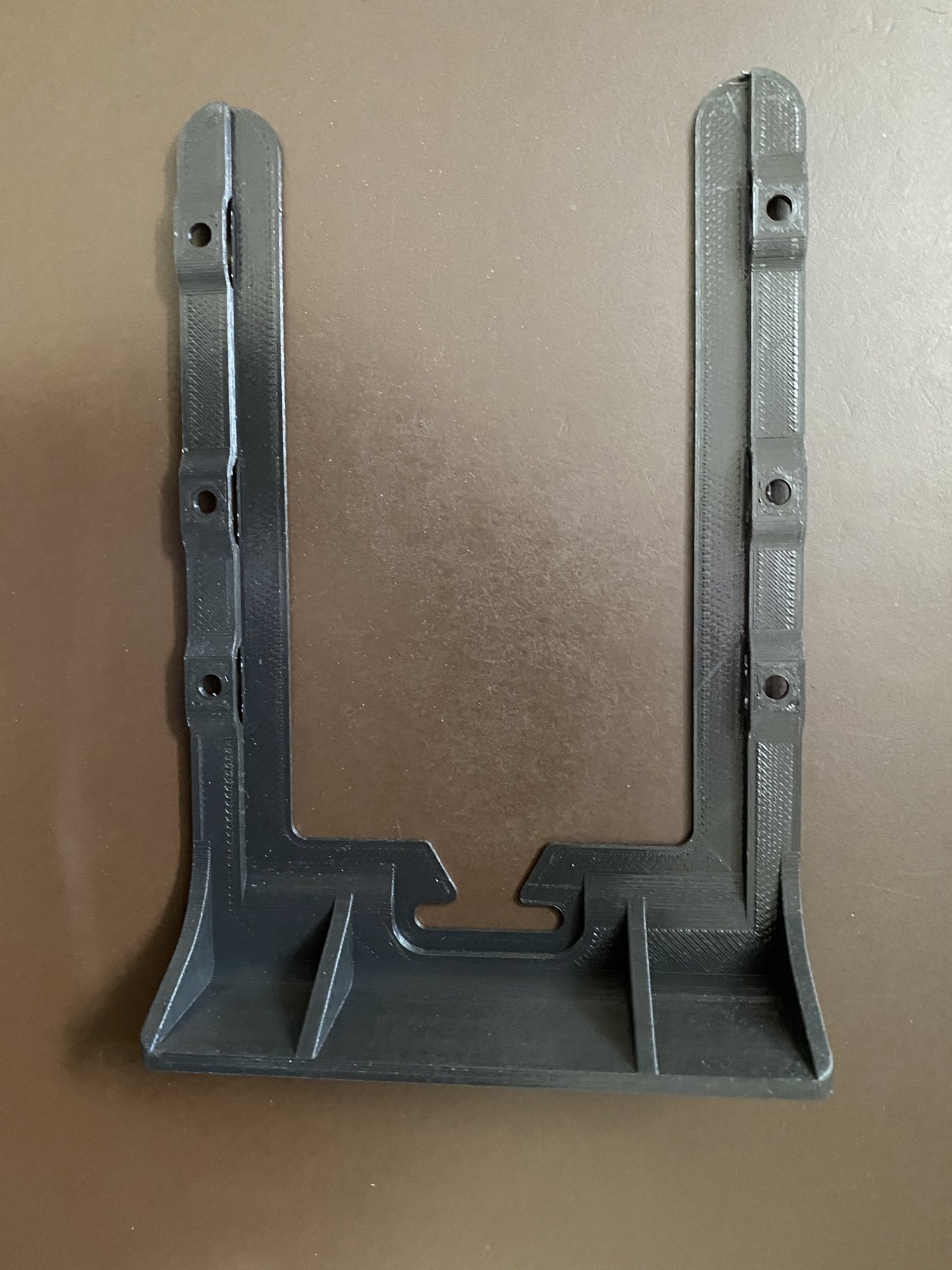

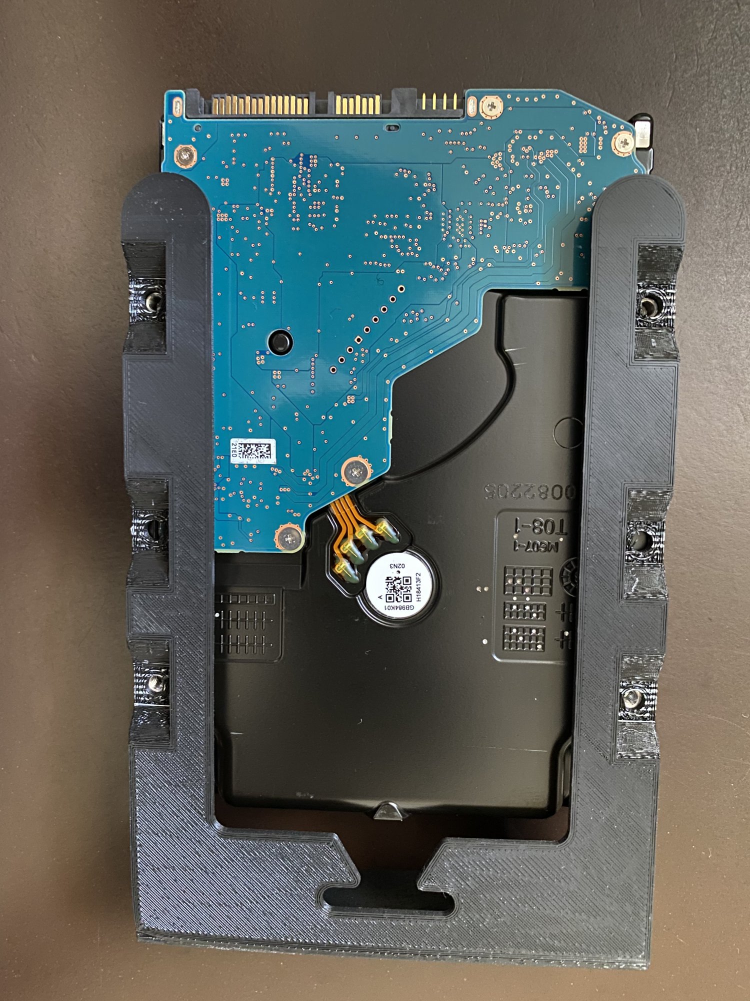

I suppose if there's a tight fit and tape won't do it there's always the option to carefully pull out the pin 3 wire/metal lug from the connector (and insulate it with tape, a shrinking sleeve or something -which allows re-attaching later if an older drive is to be used again).
I haven't decided on a 6-8 TB drive yet, but is "Power disable" a feature which is mentioned in a drive's tech specifications or something you just have to figure out by trial and error?
Your explanation and remedy then solves problem #1 🙂
Problem #2 with high capacity drives is the new screw mounting hole scheme, and that's also been solved (drill a new hole in the existing drive mounting sleds or buy new ones from OWC -and hope they've been made to spec).
With this in mind it looks like it's only a matter of finding a drive which doesn't use SMR technology, is fast, of lasting quality (and in my case at least) is relatively quiet running.

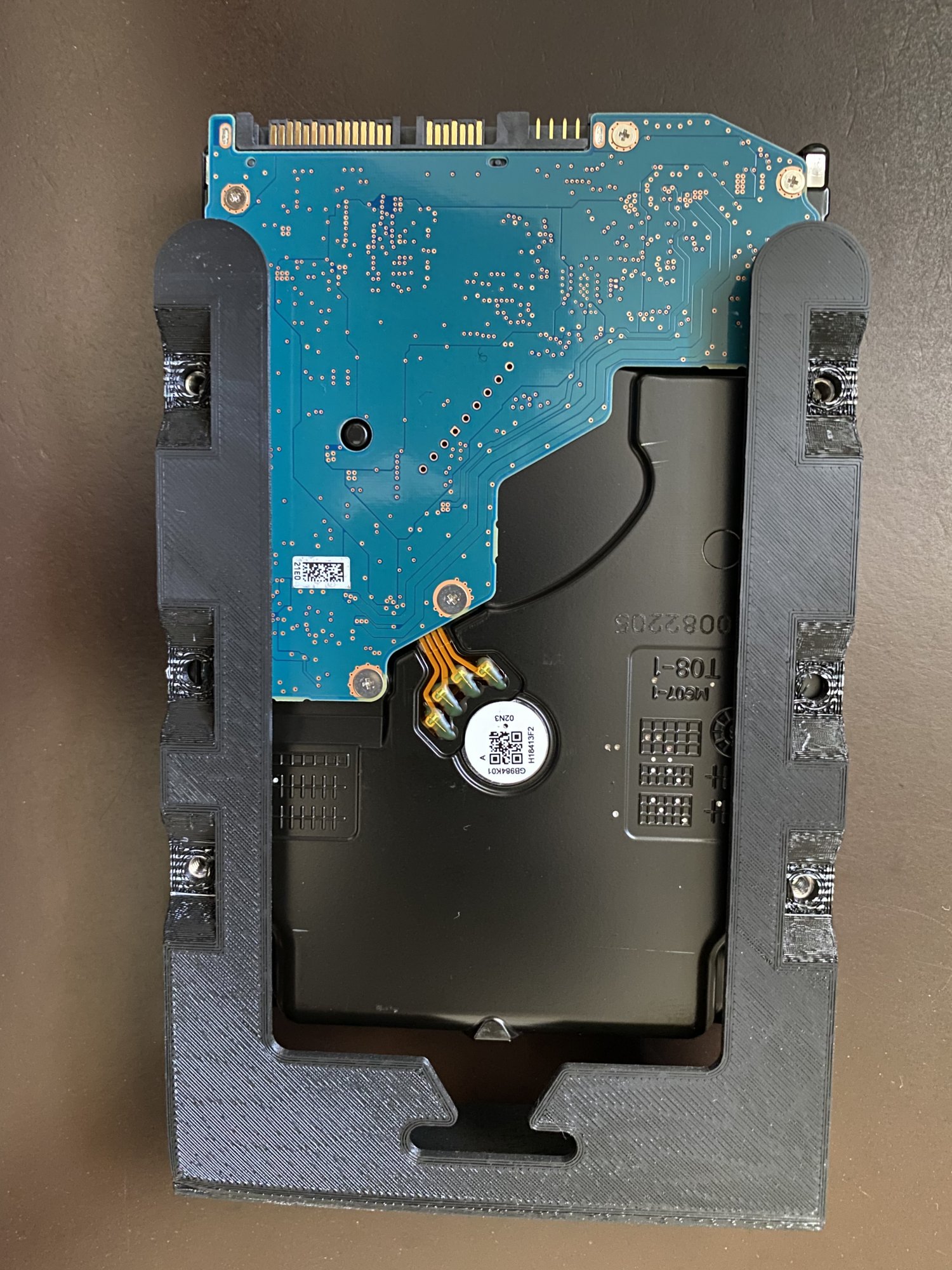

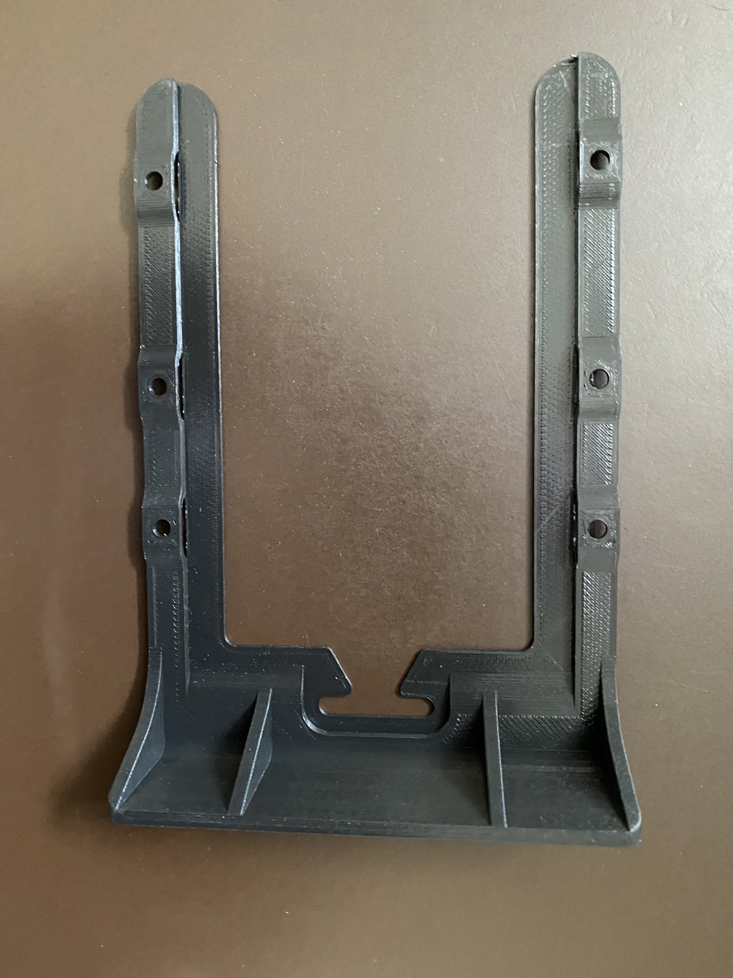

Printed the 3D model using PLA. While I don't know the long term robustness in the Mac Pro, it seems to be an option if you have access to a 3D printer.
Reactions: MIKX and h9826790
The material cost was ~0.60 cents. Print time was 8 hours, though one can speed that up at the risk of a less refined result. The model was found on Thingiverse.
All that said getting someone to print it in ABS, or at least PETG, might be more appropriate given the higher working temperature of the plastic. From a material cost it's largely a wash, though a printer you might find at your local library is unlikely to be able to print ABS.
