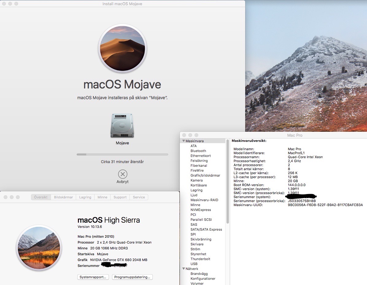

Thank you very much for quick reply! Then I will from High Sierra erase the disk with Mojave and download High Sierra from the link. From there I just start the installation and choose the empty Kingston SSD?
Correct, then follow the steps on the screen to upgrade to 144.0.0.0.0 firmware.
