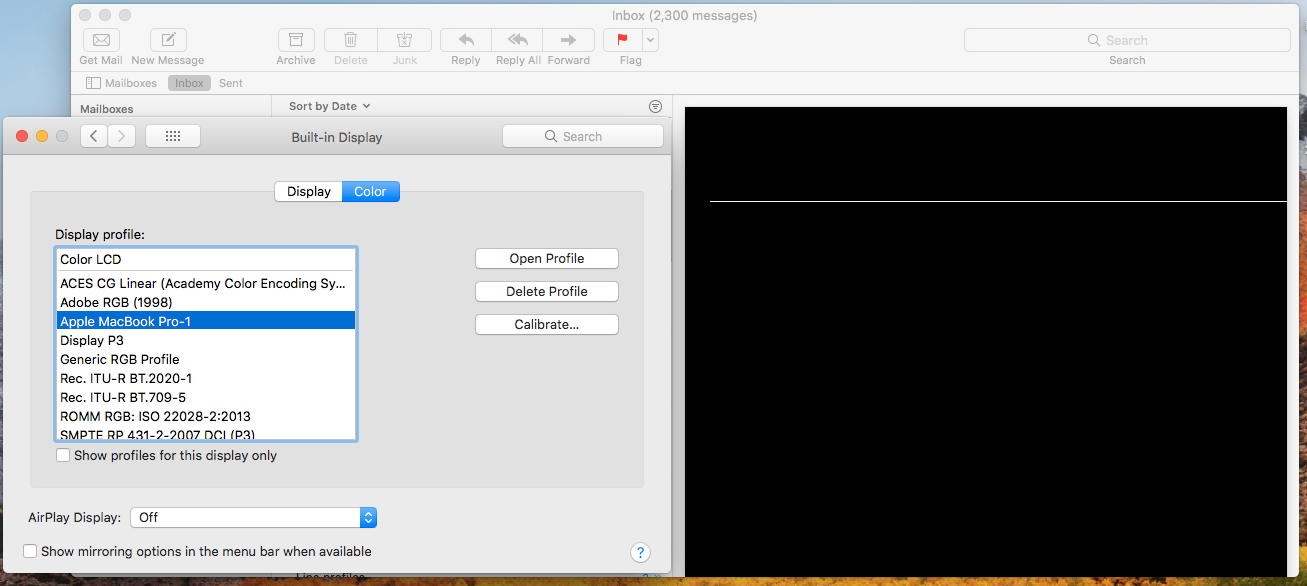

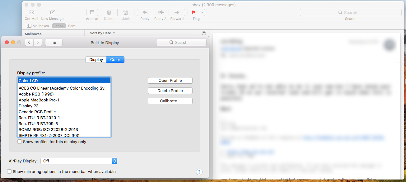

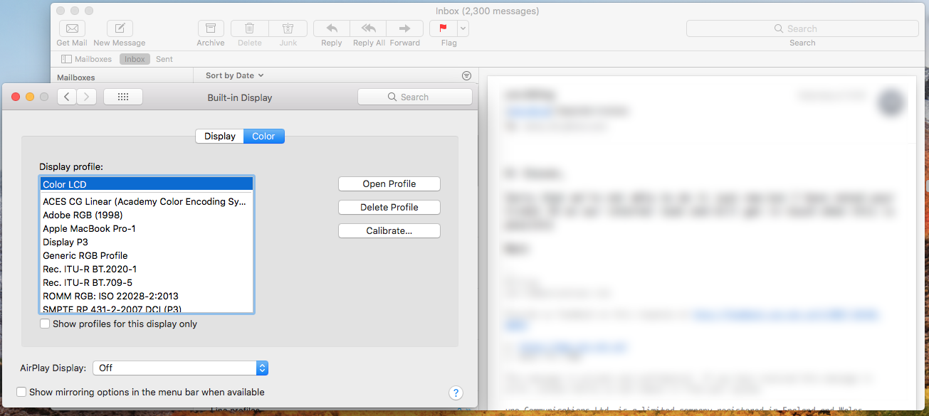

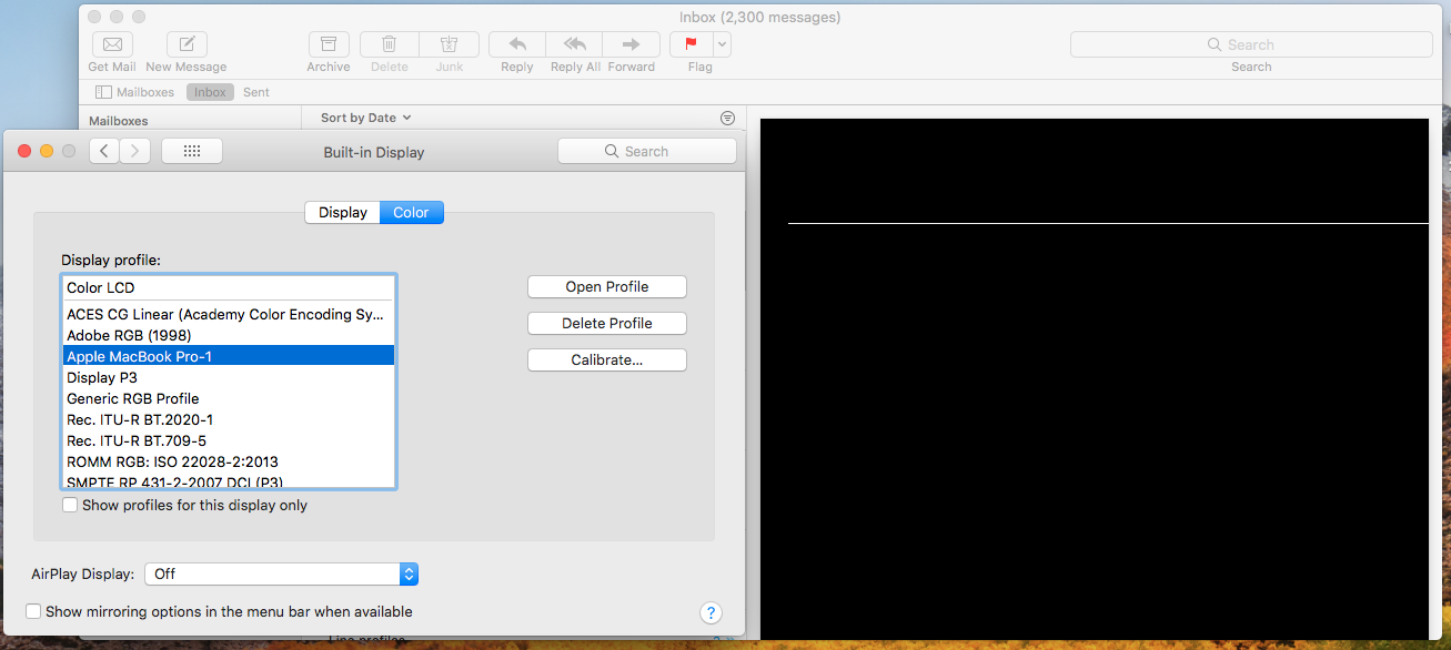

After upgrading from Sierra to High Sierra on MBP late 2011 with Crucial SSD with APFS, Mac Mail has a visual bug when displaying email message that are included in any Conversation view. They Just show black. see attached image.
My MacBook Pro has 2 graphics cards, one in-built and another dedicated GPU for software that requires higher performance. The problem only occurs with the in-built Intel HD Graphics 3000
and also with specific display colour profiles.
I found that turning off 'Automatic graphic switching' in system settings so my mac uses the PCIe GPU (AMD Radeon HD 6750M) instead of the In-built GPU (Intel HD Graphics 3000) cures the bug but I cannot keep it on this setting as it causes higher battery drain.

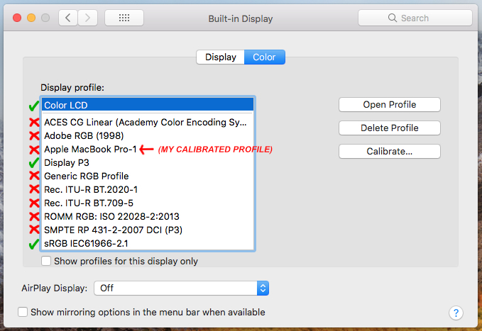

Changing display profile fixes the problem when using the Intel HD 3000 gpu but only 3 out of 11 display profiles work which doesn’t include my Colorimeter calibrated profile which I need to use for colour correcting photos and design work. See attached images of display profiles that DO and DO NOT work plus image of Mail with and without the bug.
The problem does not occur when the mac is running in Safe Mode.
Things I have tried:
1. I have run Profile First Aid in ColorSync and all profiles are OK.
2. Reset PRAM
3. Reset SMC
This is not a major bug but an annoying one nonetheless which I can work around for now. If anyone has the same problem or might know what may be causing this or other things to try, let me know.
Thanks

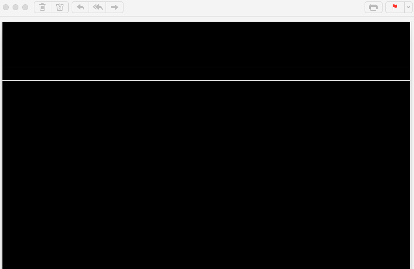

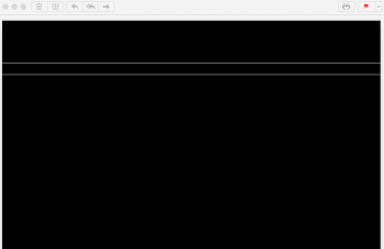

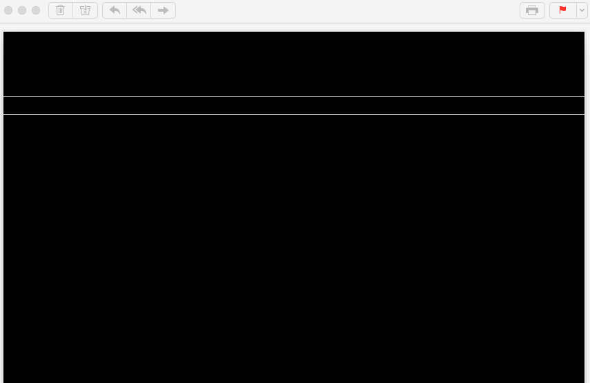

Yeah I'm getting the same issue. Changing colour profiles or having the ColorSync Utility open doesn't seem to do anything though.
It doesn't black out all of my emails and it just seems completely random which emails it picks to screw up! Really annoying actually.

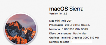

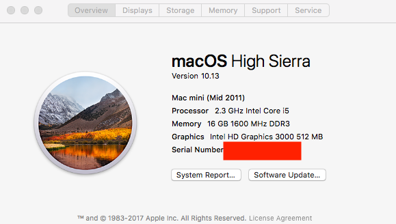

Attached my specs. I did an over the top upgrade.
Ah upon closer inspection that's exactly the case.
Ah ok. It's a Mac Mini so no dedicated GPU unfortunately 🙁

How much RAM do you have?
4GB is known to cause issues with Sandy Bridge systems running High Sierra, upgrading to 8GB fixes them.

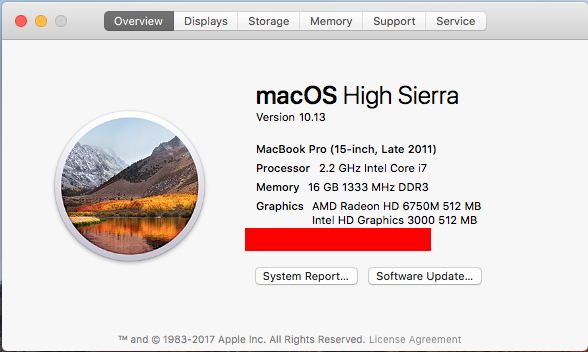

Might be that High Sierra is not fully compatible with that graphics card.
My MacBook Pro is about the same age and spec.

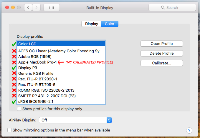

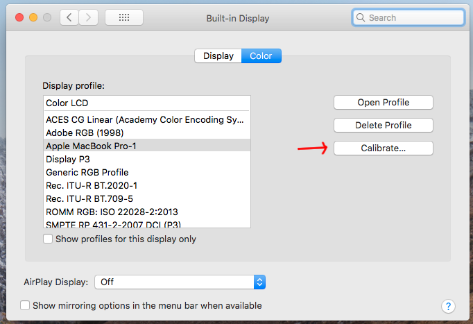

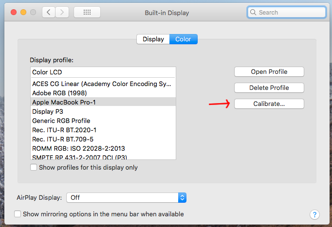

One thing you might want to try is run through the calibration within system settings. There have been reports of that fixing the bug for some people.
Screen Shot 2017-10-04 at 12.11.34.png Screen Shot 2017-10-04 at 12.13.02.jpg
16GB
[doublepost=1507116134][/doublepost]
View attachment 723366 View attachment 723367
Ran calibration and it's fixed! Thanks very much!

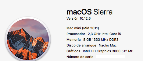

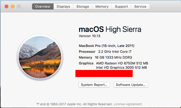

this is my mac... and i have the same problem... i made downgrade to sierra because y really use the mail app.... please if some one can fixed completly
The problem seems to be with High Sierra and Intel HD Graphics 3000.

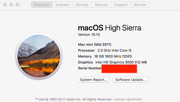

Created an account just to thank you! I was on the phone with Apple for almost an hour, and all they could tell me to do was to reinstall the OS for the 4th time...
Mac Mini mid 2011
2.3 Core i5
16g DDR3
Home-made fusion drive
My early 2011 MBP with basically the same setup wasn't giving ANY issues at all, so I had assumed it had something to do with the fusion drive. And I did NOT want to do the Terminal-Fu to separate them...
Thanks again!
