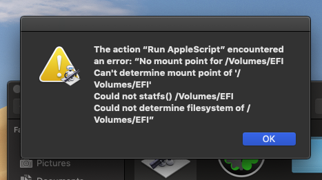

can anyone solve this

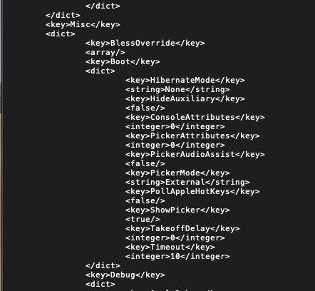

Mornin all, how do I hide drives from the bootpicker
Update::: found it in config.plist
“ hideauxiliary “ set to true instead of false
Sorted for a cleaner look

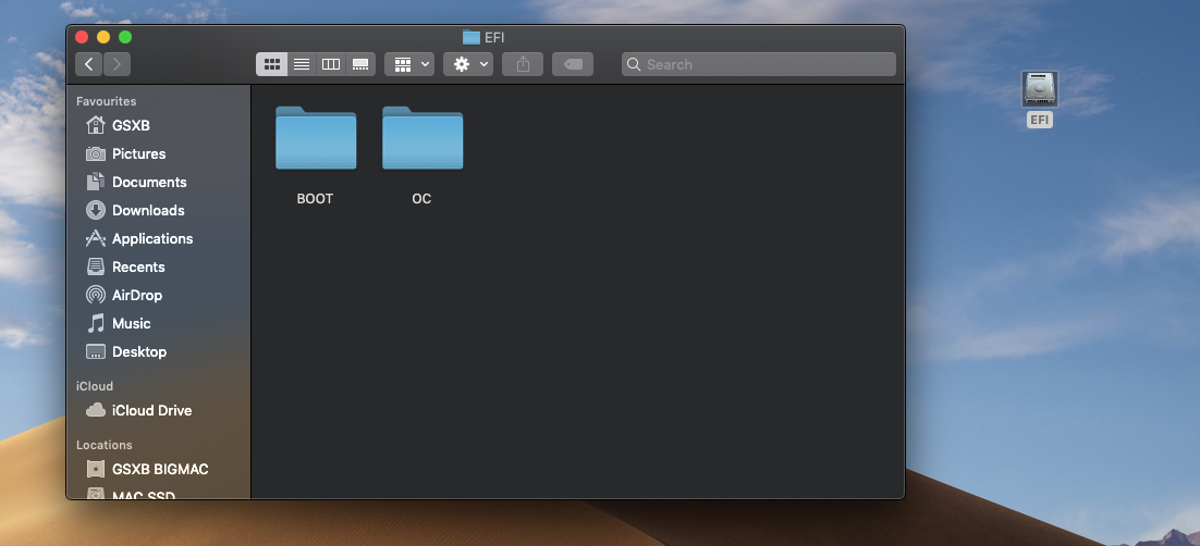

I've installed OC on the EFI of a data drive (I'm only running Mojave at the moment), blessed it and confirmed it's booting with OC using the terminal command in the guide.
However, nothing I do gets me a boot picker:
  • A normal (hands off) boot just loads Mojave
  • Holding escape leaves me with a black screen (need to hard reboot)
  • Holding option (post chime) just loads Mojave
My system is 4,1>5,1 (6 x 3.46GHz) with a Sapphire Pulse RX 580 8GB
Scanning the thread I've seen hints my second hand RX 580 might be the problem if the BIOS has been messed with, but I'm getting over my head and all the solutions I can see point to using Windows. Can I confirm / fix this without access to a windows machine?
I can dig out my stock NVIDIA card from storage if necessary, but it's not immediately to hand.
