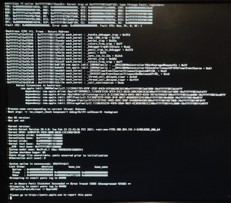

So I have updated to macOS 11.3 (20E5186d). But when I tried to update through OC id did not work. It crashed at the NVME drivers. So I continued installation from the Apple boot picker selecting BS directly. Then it went through.
Wait, do Big Sur beta updates boot directly from Apple boot picker?
As long as -no_compat_check is set it just operates as a supported OS on cMP5,1 ( Minus the update initiation).
OK, as I understand it the -no_compat_check is recommended to be disabled as per post #1 though?
Have you tried the latest build(20E5196f)?
I tried installing it, but it did not go. It crashed at NVME controllers (My BS is on an NVME drive). Never had that issue before. I could only continue by selecting the BS option in the bootpicker not the newly created Macintosh HD. It "appeared" it was upgrading BS, but after booting I realized it did not go through.

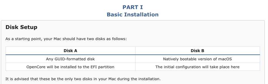

Hello good nigth
I want start with this tutorial, and like to create a video to how do this step by step too.
To start i want to understand what this part means:
see
before do all this step, i want understand all that i will do.
My mac pro 5.1 hasta catalina installed, but not opencore, and i want to do a clean install , erase all and follow this steps.
Can somebody help me?
Regards
Julio
