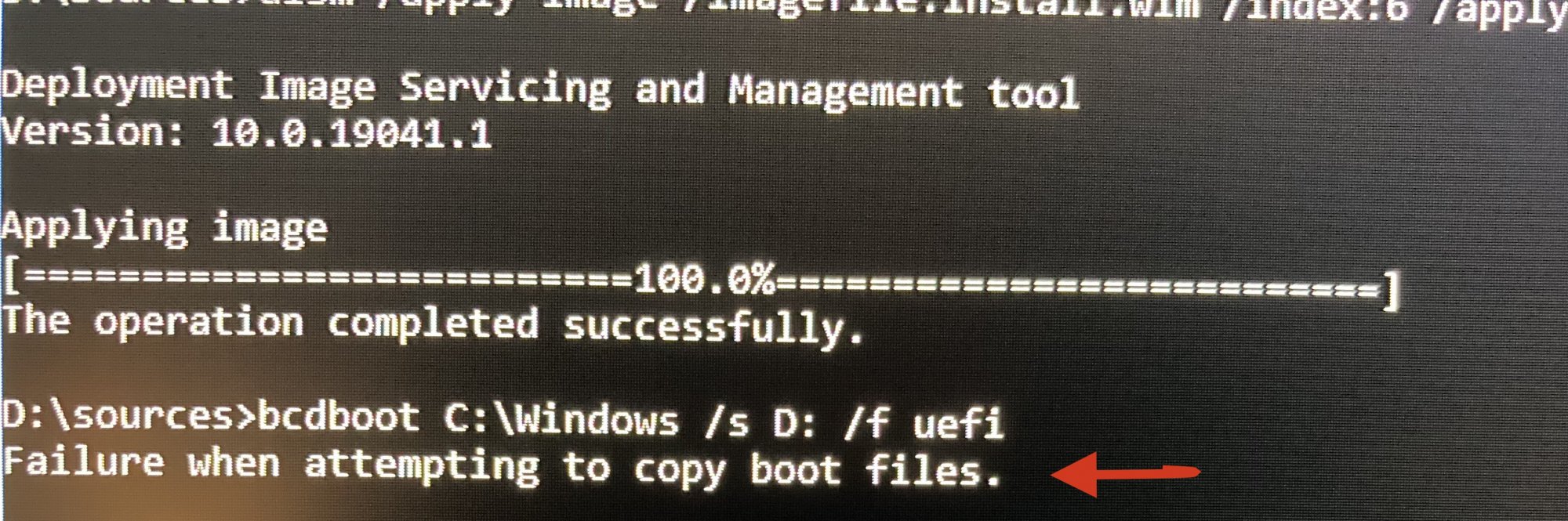

In the Windows installation part of this guide, there a section called "Proceed with the installation" where I'm getting an error!
I didn't even try to proceed beause I'm not what would happen.
Any ideas why this might be?
