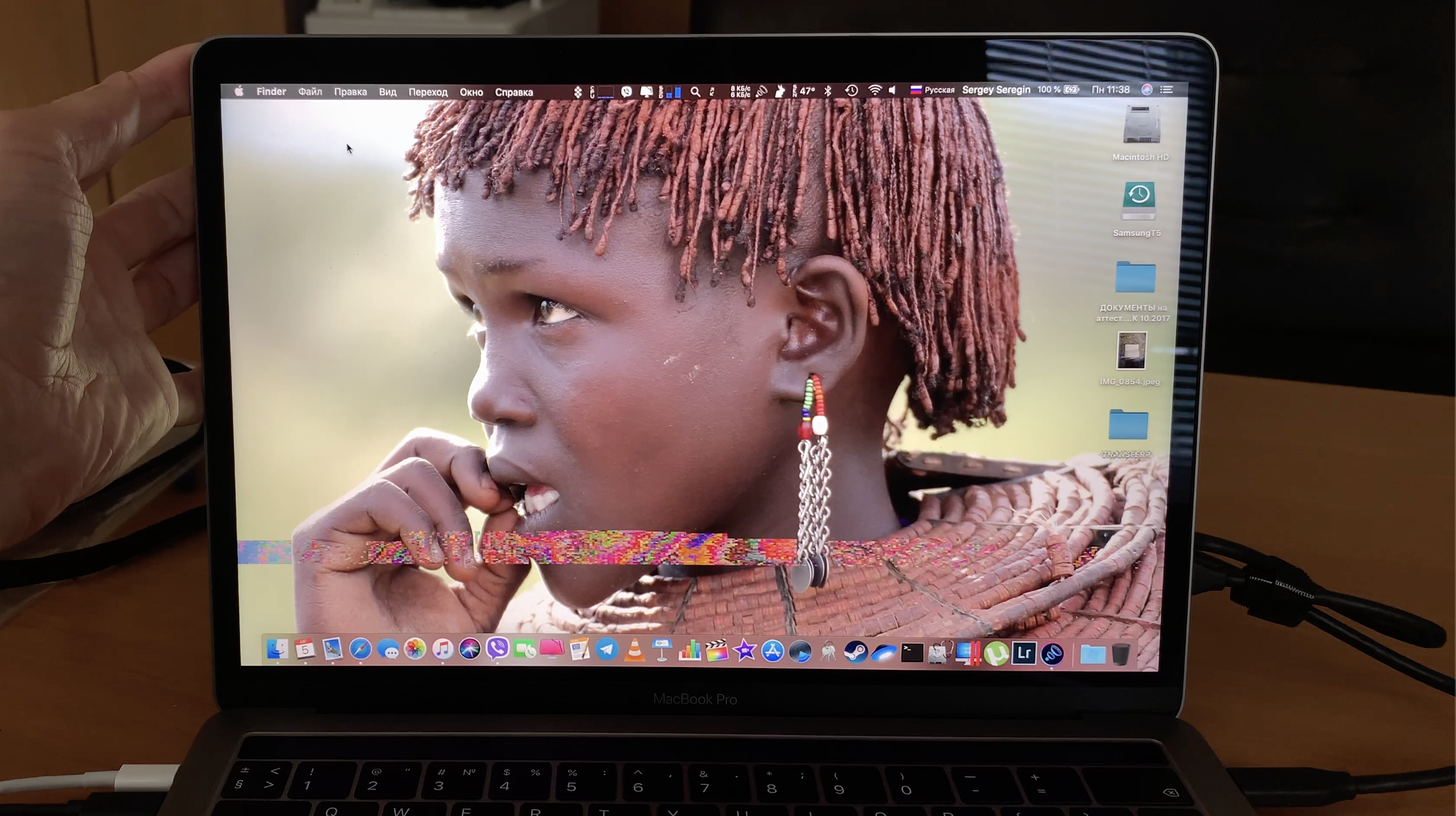

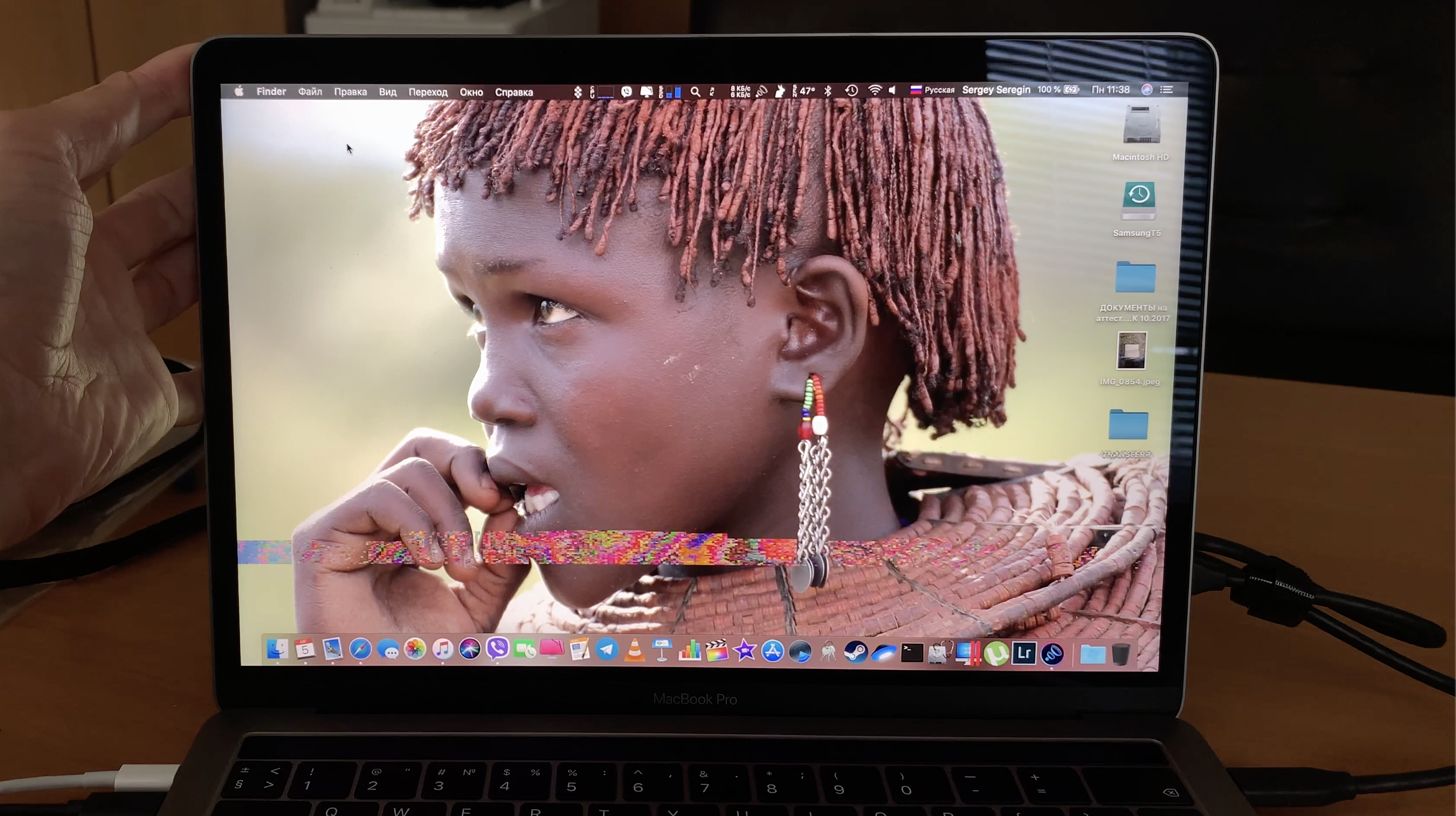

Thanks for the video. I have the same issue (only gray patterns) with my 3 months old MacBook Pro 13" 2019 Core i5 2.4 Ghz running macOS 10.14.6. I think I will send it to service.
Thats it! But service could not change anything =)

I captured the moment when my entire screen was filled with this grey checkboard. Previously these artifacts appeared in smaller regions of my screen. I can't reproduce the issue, it seems appear randomly.

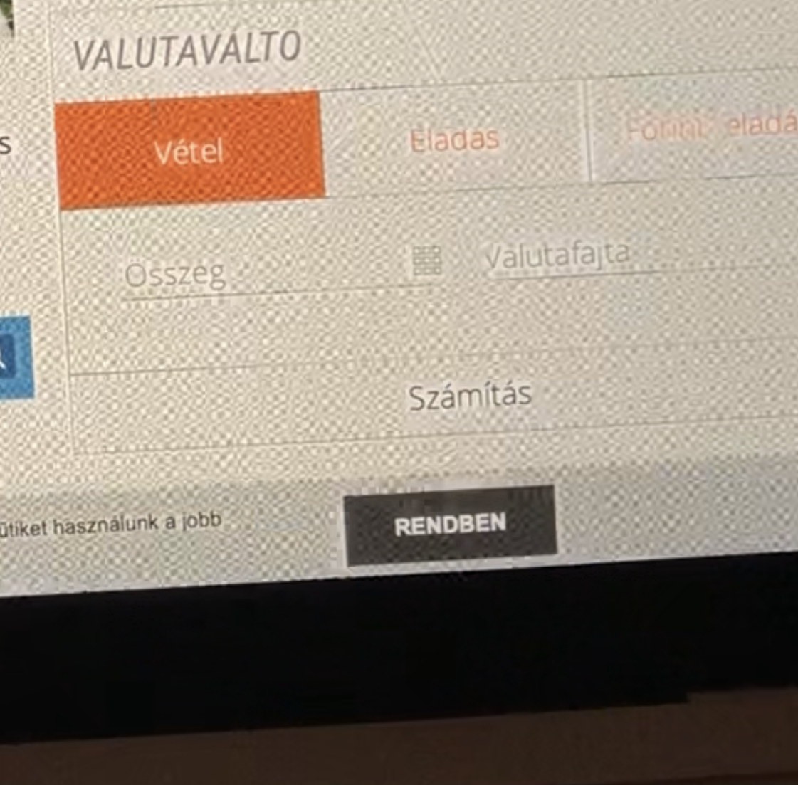

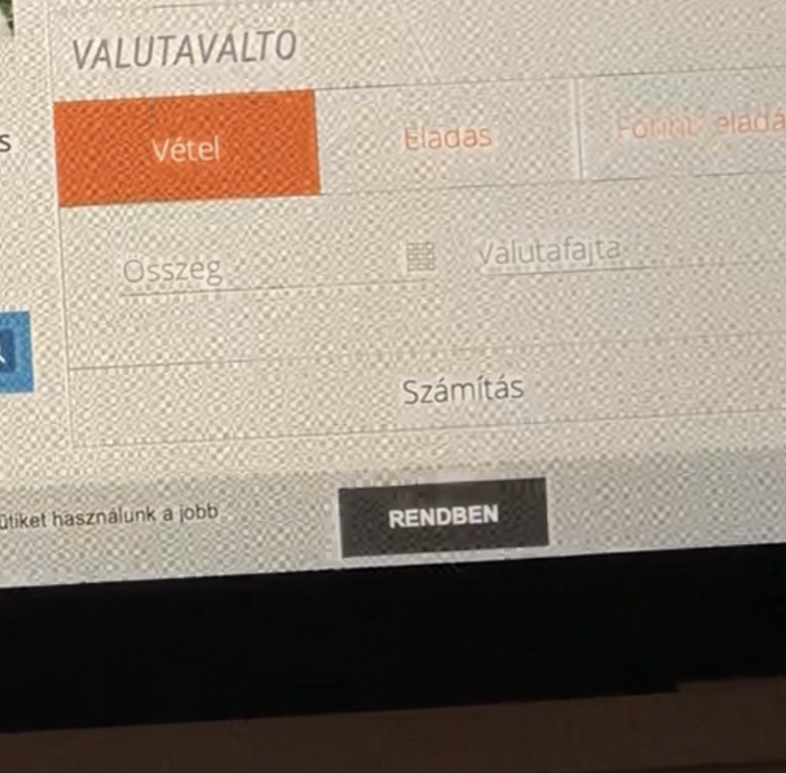

I think the problem is nearly similar, I don't want to repeat myself. The same grey checkers appeared here for a fraction of a second with random timing, non-full screen, just as seen on the videos, for many (30+) times. Maybe the full screen issue is different, but the original fault is also here if you want to differentiate.
