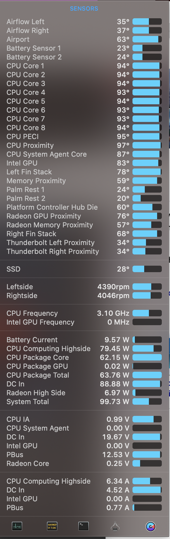

Doing a blender benchmark with CPU and the power is pecked around 90-100W. I was trying with some demanding games it definitely went over 100W.
