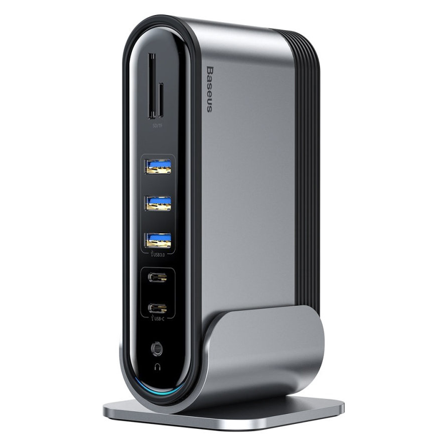

I use this new Baseus model.
No Thunderbolt and only supports 30hz on 4K displays. Seems pretty limited for all those ports.
Edit: Come on bro: "
  • Power supply adapter (12V/3A output) not included with this model.
    • use your own laptop power supply for best results (45W or higher).
