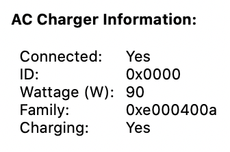

Aside from what rex450se asked, can you also verify the power of AC adapter in the system information report while the power supply is connected via the dock?

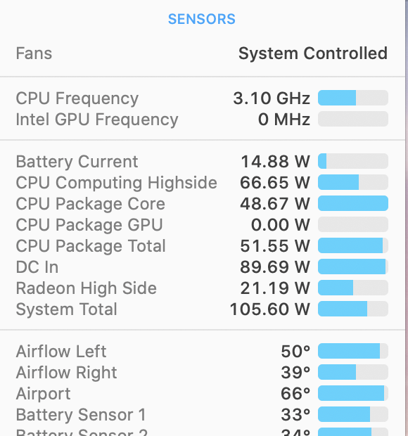

After checking system information for the detected wattage, it's important to verify that it *actually* delivers the wattage by running Cinebench or something that causes the MBP to use ~100W and then checking the "DC In" sensor in iStats Menu. For example, the Razer Core X shows "100 W" in system information, but only delivers 88W, even under the most extreme load.
I suspect that it is because the dock does not supply power continuously. I use Anker Atom PD4 which supports 100w maximum. But if 100w is too much for the device, it will charge at a lower 88w, instead of somewhere in between 88 and 100.

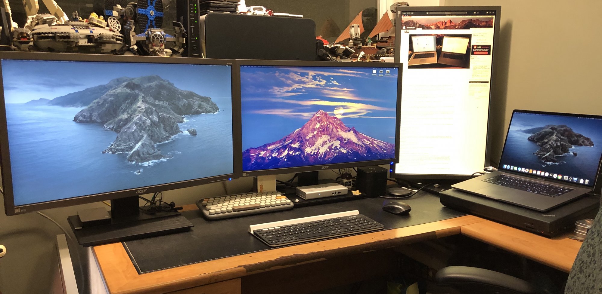

Huh. Mine runs reasonable. I'm running three 4K displays (two to the dock and one plugged in to a TB3 port on the other side of the computer,) and it idles at ~40°C in lid-closed mode, and maybe 60°C when playing a 4K/60 video on YouTube. The fan starts to become audible when playing a 4K/60, but even a 4K/30 it stays quiet.
(Picture taken with lid open so the laptop is more obvious for the photo.)

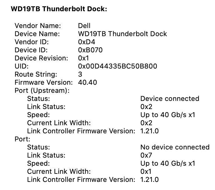

Some information about the Dell WD19TB dock. I plugged it in and it worked, no nonsense with drivers or anything else, so that was refreshing. The downstream TB3 port is reported to be 40gb/s instead of the half-speed that some docks give you (though I think all Titan Ridge docks should give full 40gb/s). Charging is reported to be 90 watts which iStat seems to confirm with DC in. It is amazing to see a laptop spike up to 140 watts when starting a Handbrake conversion. It held up over 105 watts of total system power for a full 5 minutes so even the Apple supplied 96w charger is going to have some trouble there.

Running an hour long handbrake transcode that is using 85-93% of the CPU, while connected to an external 4k display (about 20w draw from Radeon card) now. I started at 100% battery using the Dell dock. I'll let you know the percent battery after the hour long transcode is done.
