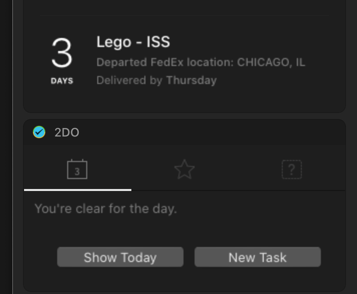

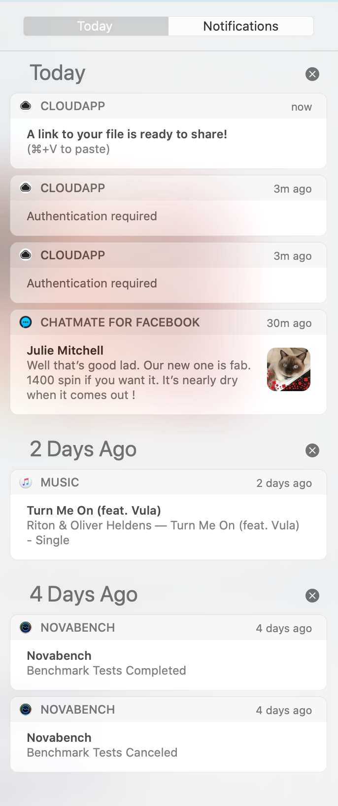

Can anyone with the CalDigit TS3+ please help me confirming this? I'm having a weird issue with blurry text, only when I connect the mac to the CalDigit TS3+ dock.
The notification center's widgets' text look blurry, like in this screenshot (you probably can only see it in your retina/4k displays I guess).
This happens:
- When I open the notification center in laptop's retina display. I have 2 FullHD monitors connected to the docks and of course they look fine there (they are not retina/4k anyway)
- Only with this CalDigit dock. I have another simpler Belkin dock (with 2 HDMI connected to 2 FullHD monitors, 2 USB-A, and an ethernet port) at work and this does not happen.
I would think this is a software (Catalina) issue, but am also confused that it's fine with the Belkin dock.
