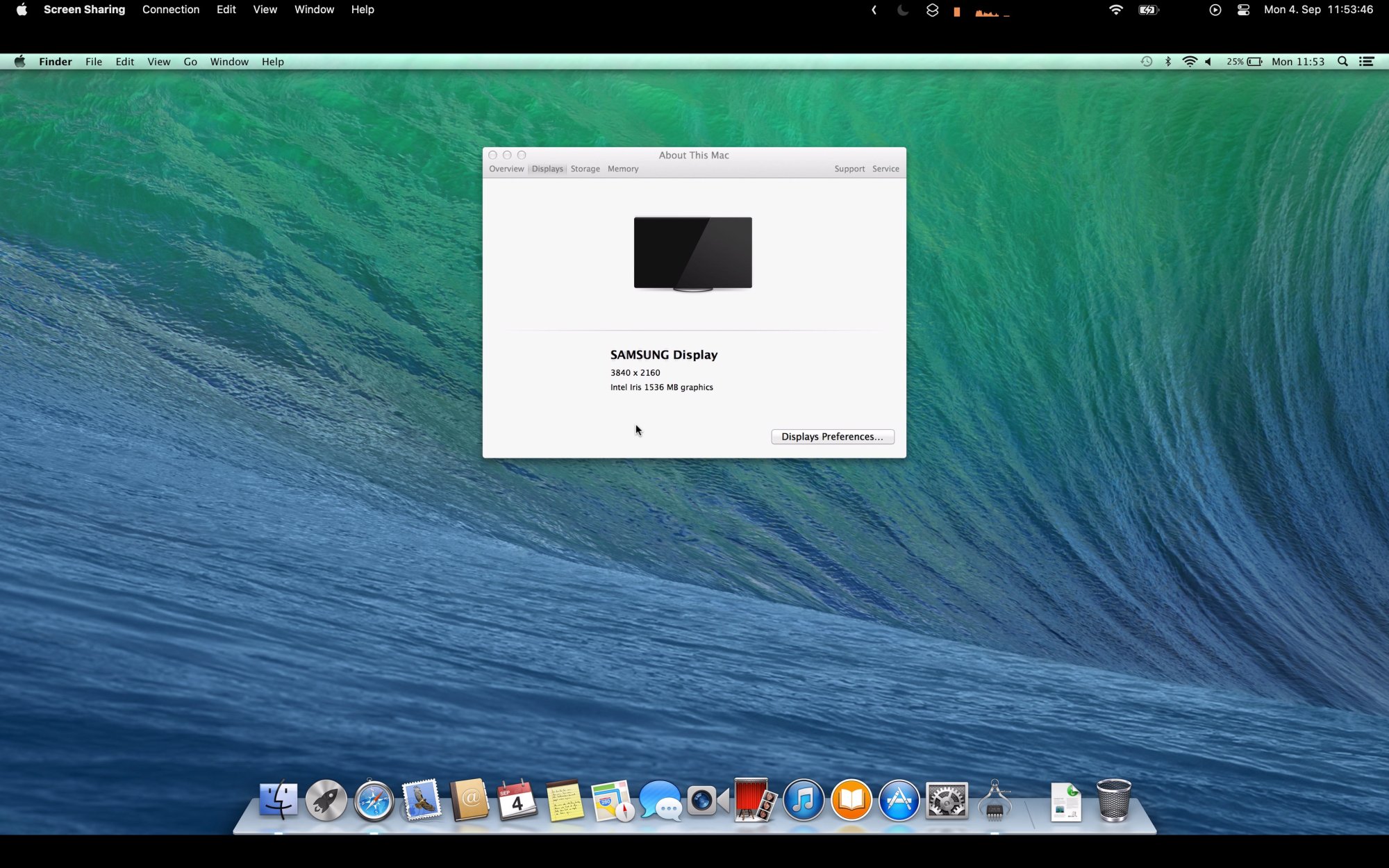

I have MacBook Pro that doesn't recognise its own display...
It used to work fine, but at some point the display just turned off, like off off. No backlight, nothing on screen, in Big Sur in Control Center the brightness is greyed out.
But it sometimes does work. Having it run out of battery and sit for a week or more, turning it back on it works, logging into my account it (often) works. Recently my sister logged into her account (it was supposed to be a family laptop) it died after a few minutes after it worked fine for days on my account.
Its a 2014 13" MacBook Pro, it ran Big Sur until today.
Restarting doesn't fix it. Resetting PRAM/NVRAM or SMC doesn't change anything. No malware, nothing insidious, no software or hardware modifications. Deleting her account didn't change anything. Erasing the disk did change anything. Restoring to Mavericks without any data didn't change anything.
Connecting it to an external monitor works fine, so does Screen Sharing. But then, even if no external monitor is connected, in System Info it doesn't show the built in screen, just the most recent external one.
Diagnostics (on Big Sur) didn't reveal anything, so did EtreCheck. I once opened it to clean it and disconnect and reconnect any cables related to the display. Nothing. The camera works fine, though.
If it just straight up didn't work at all that would be unfortunate, but that it does work until it suddenly forgets its own display is so weird and I couldn't find anything about this or similar issues online. Any help would be appreciated as I want to give it back to my sister for school as her Windows laptop is slow and falling apart. And running Windows :p

So I still have this problem, with Mavericks, without any restored data. The display worked fine for days on one account but died after logging into another.

Does it then still work when you log in to the other (normal) account?
How long did you use the second account before you lost video? Immediately? 2 minutes (just like last year)? longer, but less than 10 minutes? several hours?
If you lose video, and then you can't get it to reboot into the working user (similar to what you reported last year), then I still suspect it will be hardware--probably the logic board.
It worked fine when we used it to connect to a scanner to scan some 200 pages from a book, which took many hours and was done over many days, including shutting the lid, putting the Mac to sleep, turning it off and back on again. I wasn't present when it turned off, I guess it happened within 1-2 minutes, because my sister told me she just logged in and wanted to use safari and then it all went black.
I can boot and log into all users, the Mac just forgets its own screen.
I have restored it completely and reinstalled Mavericks, but it still struggles, Sys Info only displays the most recently used display and not the internal one. Will run Hardware Diagnosis tomorrow and see if it shows anything. The camera still works fine though, green light any everything.

An intermittent problem will probably not show up in Diagnostics.
But, you might look through your Console logs, which might show when the video was lost.
(note) I would not expect Safari in Mavericks to be very usable (or reliable) now.

No, I just wanted to check if it’s still present on mavericks. I never intended to use it, I’d like to return to Big Sur with this machine.
I’ll try looking though the console, although I never used it before 😄
