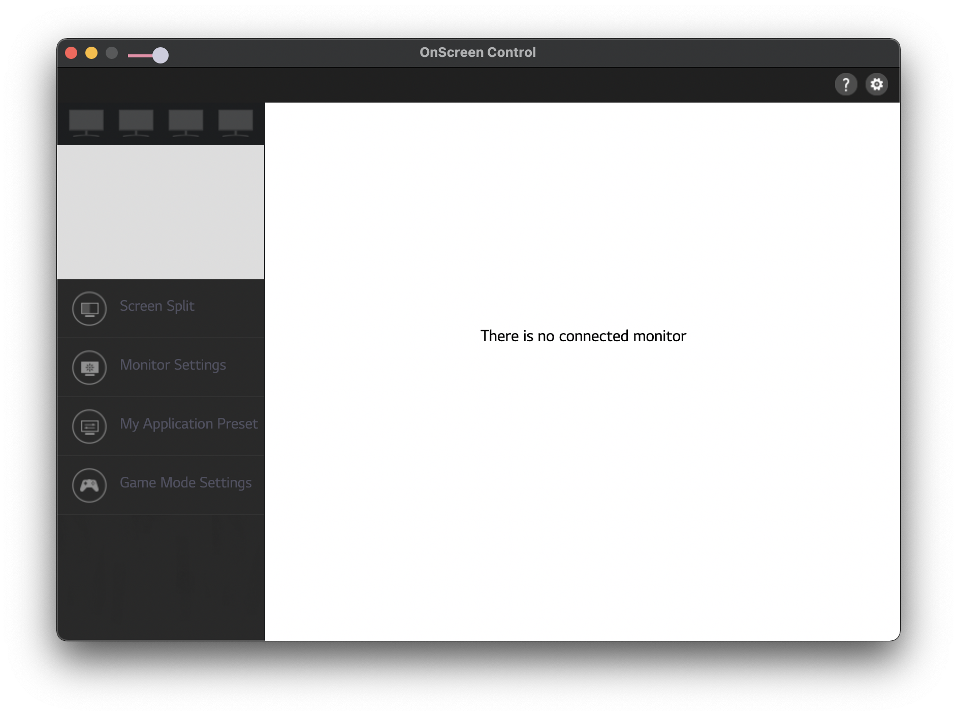

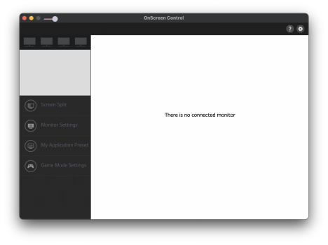

anyone still have issue with onscreen control lg app? i am still getting this screen

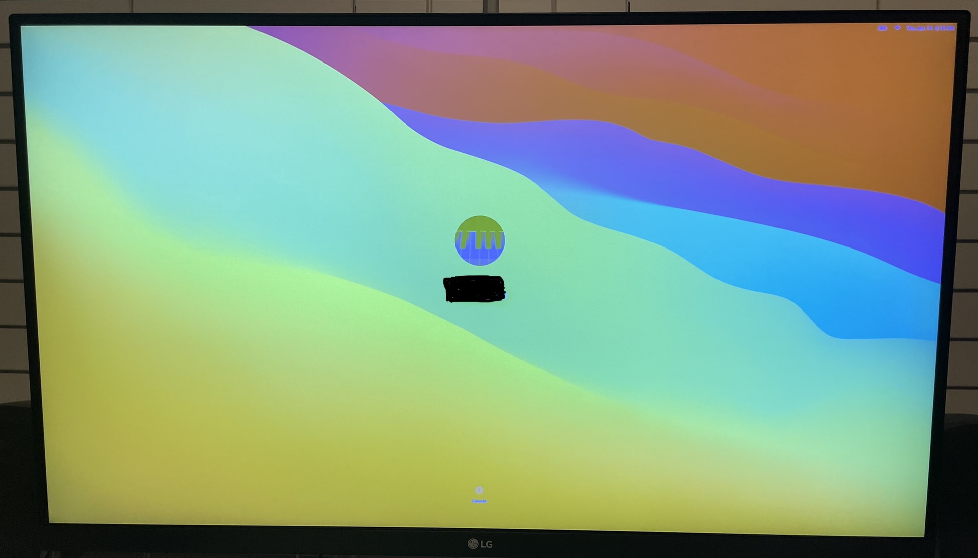

Using the official Apple AV adapter. This happens after coming back to the laptop after not using it for awhile during the day or overnight. External monitor is an LG UL600.
That's exactly what my LG 27UK670 monitor looked like.
