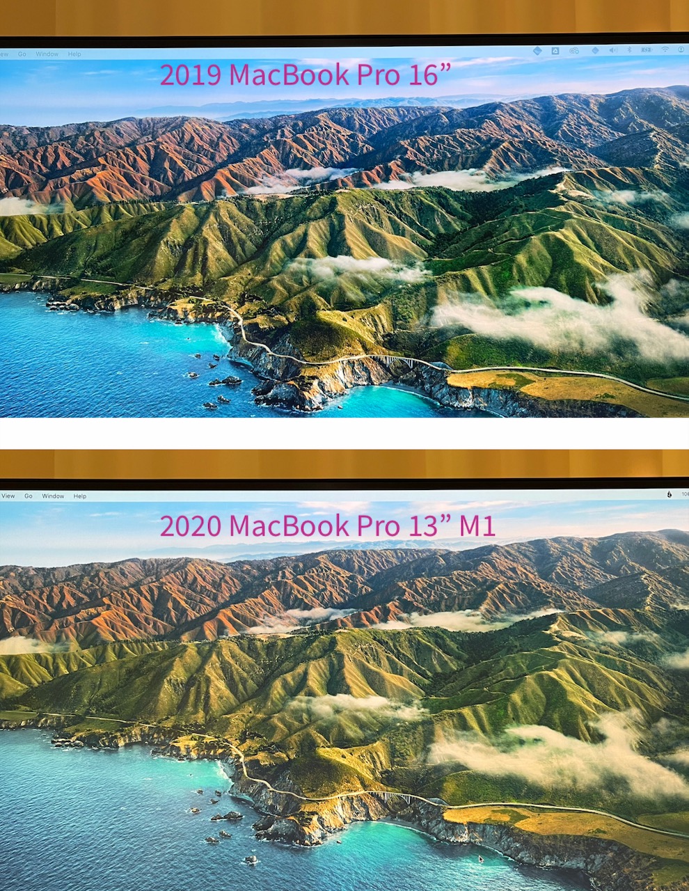

I've experienced the same issue on my LG 27UK850-W monitor. Here's a side-by-side comparison with my 2019 MacBook Pro 16" connected via USB-C, and my 2020 M1 MacBook Pro 13" connected via the same cable with the same settings and color profile.
I've tried adjusting contrast/brightness/etc on the LG monitor directly, as well as calibrating a new color profile in MacOS Big Sur 11.1 on the M1 MacBook Pro, but can't achieve the same picture vibrancy and contrast as with the older MacBook Pro. I've submitted a bug report to Apple about this as well and am hoping for a fix soon.

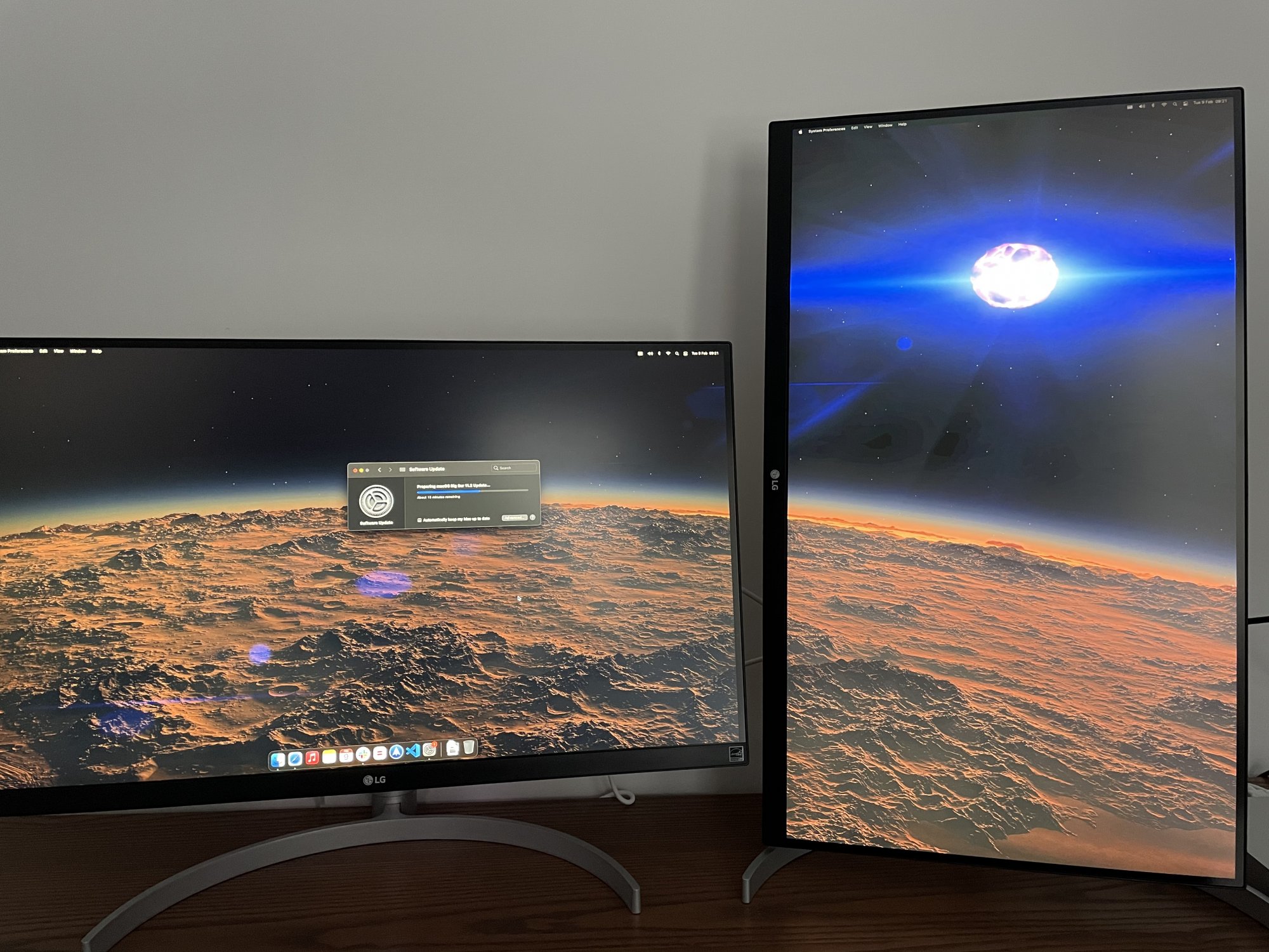

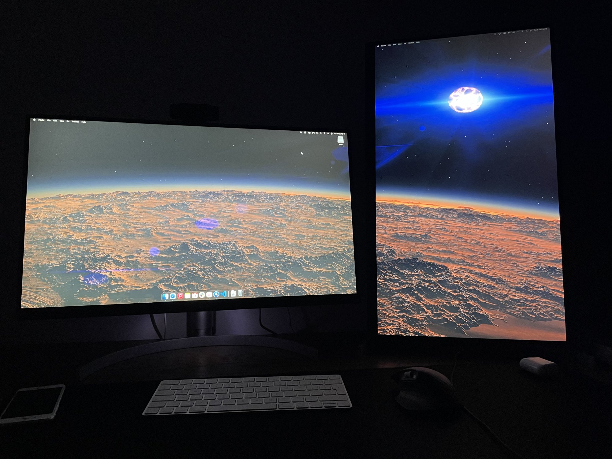

The above fix does not work for me :(
Ive tried USB-c dongle from satechi to connect both monitors via hdmi and the colors are exactly the same to me, but then I notice huge mouse lag on the monitor with USBc-hdmi.
as you can se below:
1. With Dark room, night. The horizontal monitor is via USBc, the vertical via hdmi. Horizontal is washed out.
2. Light, day. The vertical is via USBc, horizontal via hdmi. It looks like the vertical is 256bit color 😂
Edit: Its actually hard to see on the photo the issue the vertical screen has.
