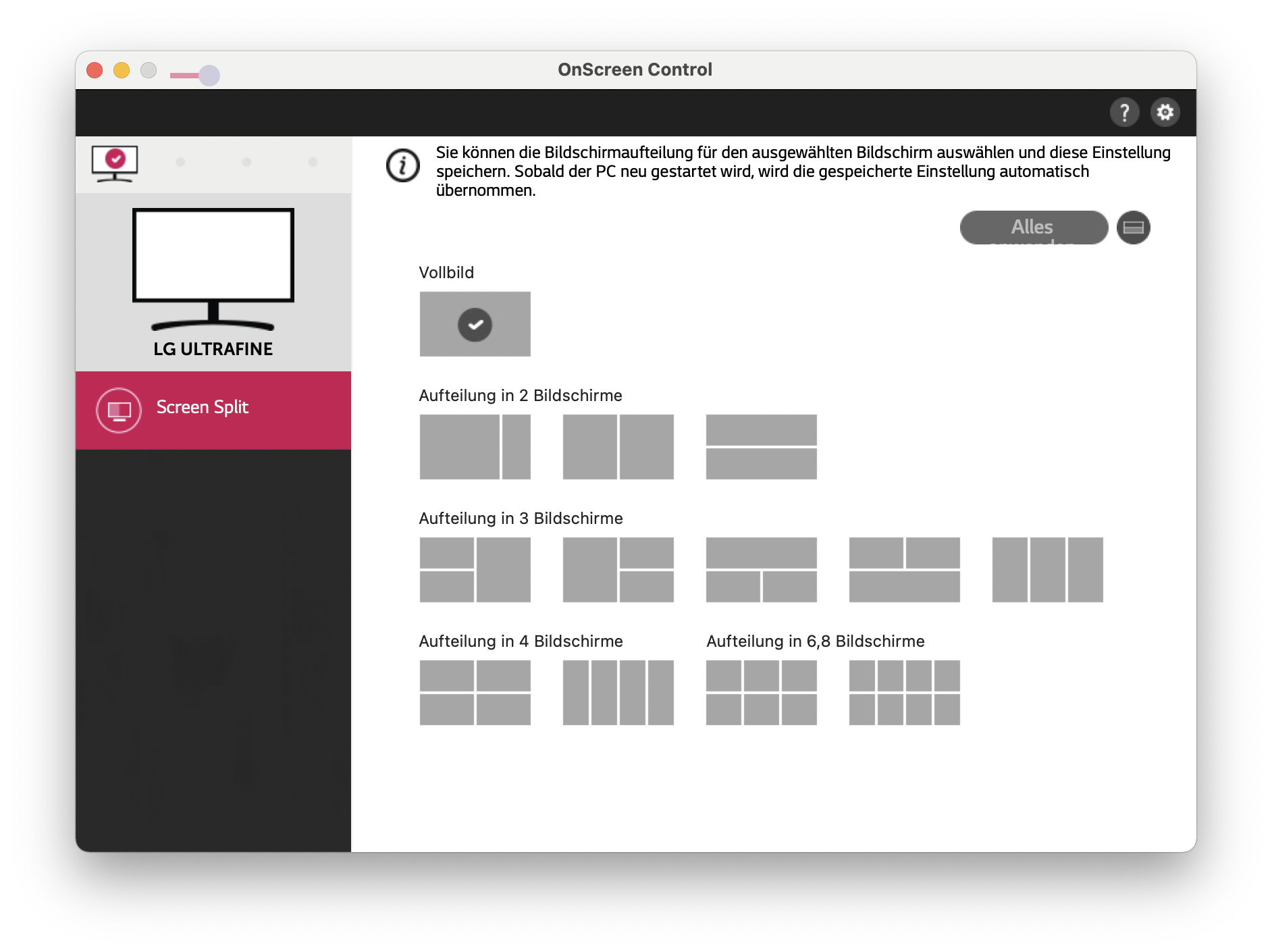

anyone still have issue with onscreen control lg app? i am still getting this screen
I'm also experiencing some problems with OnScreen Control.
It freezes for few second after start and then all functions except Screen Split are gone.
I can't control brightness/contrast or anything else with this app.
I have 27UP850 connected via USB-C.
Yep. I read somewhere that LG will release a new version late this month 🤞
Any news about new version with fix?
I'm running latest OnScreen Control 4.64 from LG support page.
