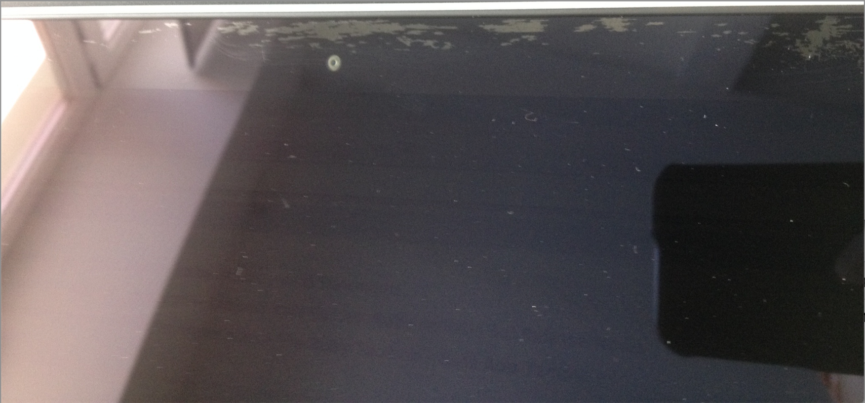

Here's damage of my MBP 13'' Retina screen:
attachment.php
I took it to a Apple Certified Service and "almost" got it replaced under warranty. The thing is the issue occurs only on the black frame not over the lcd matrix. The service contacted Apple technicians to get the permission to replace the display but in the reply Apple sait that this is "estetical damage"!! 😡
Once this starts happening over the LCD matrix I *might* get it replace.
Funny thing is the reason why it happens that Apple KNOWS about!! In the factory there was a huge batch of Retina displays that have the glass piece glued in the wrong side 😱 I think that ScratchGate is the right name for this thing!

I lost my microfiber cloth that came with my rMBP and bought a new one ; guess what ?! The new one is yellow (not black like the original) and after wiping my screen with it (only water) it had black marks all over it.. You guess it. The coat is coming off.
This is bad. Really bad.

My screen had similar marks but just touching the actual display area, I took it to an Apply store and they replaced my screen.
I must be lucky - I've bought my 13" rMBP in November and I clean it A LOT with microfiber cloth. My friends are even starting to make fun of it.
My screen looks normal - no scratches. I hope I won't break my luck with posting this here, but still I've got 2 years more of AppleCare.

The same nonsense happened to me. I went to three Apple stores, and they each refused to replace my screen! Ugh. I called Applecare, complained a bunch, and they gave me a replacement screen assembly. So… Don't give up! Keep fighting! Every person who complains sends a message to Apple: "There's a real problem here!"
Because it's in the same area, it can't be just from cleaning. The only thing I can imaging is that overtime that area of the screen gets more wear from opening it.

No, we are not doing anything wrong. I have the same issue with the 15" rMBP 2012. I always used water and i always used the proper cloth. Once I noticed little spot and when I tried to clean it the coating came off and NO i did NOT rub hard.
Tell Apple that. As far as I'm concerned the 2014 seemed immune to my abuse 😛 coating was alive and intact after 14 days of abuse.
TLDR: MBPr screen coating is vulnerable to damage through normal use. Wipe regularly. Use protector. Or don't buy.
I have a similar problem with my 2012 retina macbook pro 15'', which is rapidly getting worse. The coating is coming off in the middle of the screen. Initially it looked like a stubborn greasy print from the spacebar. I have been wiping keyboard prints off the screen with a microfiber cloth from time to time, occasionally with the help of Hama lcd/tft/plasma cleaning liquid. I know that Apple recommends only water, but this is disingenuous, as there is no way you can get fingerprint oil from the screen with water alone, and the first thing they did at the Genius bar was wiping the screen with the similar stuff. The solution I have is free from alcohols and I've been using it for years, including on my previous macbook-pro which had an antiglare screen (i.e. no glass).
Anyway, it turned out that the worst affected area corresponds to the region between the space bar and the trackpad. But there are other spots, which are definitely from keyboard key edges. There are also several tiny holes, which I believe are described as "exploding pixels" on a couple of Apple support forum threads. It is possible that the disappearing coating started from these spots, which in turn could have been initiated by dirt particles.
I took the macbook to Apple store. I expected it to be repaired under warranty. However the guy at the genius bar told me that the problem was caused by my negligent use, and is not a manufacturing issue. I agree that it is not a manufacturing issue, but I don't think there was anything negligent about the way I use the machine. As possible reasons the genius suggested excessive pressure or rough particles trapped between the screen and the body. I am carrying my macbook pretty much every day in a soft neoprene case in my backpack, so it is exposed to some amount of pressure, but there is nothing abnormal about it, certainly less than what an aluminium body laptop should be able to withstand. As to the dirt particles, I am sure there were some as I use my MBPr pretty much non-stop in different office and home environments. But if there was a dirt particle are not big enough to be obvious I would get rid of it, and there wouldn't be anything harder than a bread crumb. There was absolutely no sand even close to the machine, ever.
I left the apple store disappointed and confused. After thinking about it for a while and reading several forum threads, I am convinced that the problem is either with the quality of the coating or the design of the MBPr. I will pay another visit to the apple store and try to explain this, but I am not sure it will help. I am afraid that I'll have to either replace the screen at my own cost (~700) or get buy a new MBPr. I'll still go for the Retina (once you get used to it there is no way back).
In any case I am a bit upset with Apple. If extra care is required for the screen to survive daily use (protector, a hard carry case, regular dusting), they should make it very clear. If this is a known problem - and I had an impression from my conversation with the Apple genius that it was - this should be covered by warranty.
Although in the future I will be much more careful, I am sure that I did nothing wrong. It's nice to see that I am not alone, and I hope that there will be enough of us for Apple to admit the problem and/or do something about it.

Mid 2012 rMBP. Issue just showed up for me today. I could clearly see the coating coming off the top part of the screen as I was wiping it. I thought it was a smudge and wiped it again making it even worse.
Maybe it's due to oil buildup from continual handling throughout the months and years. To the user within the 14 day return window, you obviously won't wear it out that soon. I would say it would take at least a few months.

That's what I'm starting to think. It always seems to be at the top of the display, above the actual LCD itself, near the camera. Somebody in another thread admitted that it is either very close to or the same area that he finds himself touching when he is pushing the display open with his finger.
I have a 2012 15" rMBP that I ordered on release day. To this day, the surface of the display looks flawless, and I am pretty darn anal about cleaning it (microfiber + 50/50 water/alcohol mix). When I read that other thread, though, it occurred to me that I try my DARNEDEST to never touch the surface of the display if I can help it, even in the camera area. When I push the display open, my finger is touching the aluminum edge + the rubber gasket around the edge of the glass, NEVER any part of the actual glass itself.
