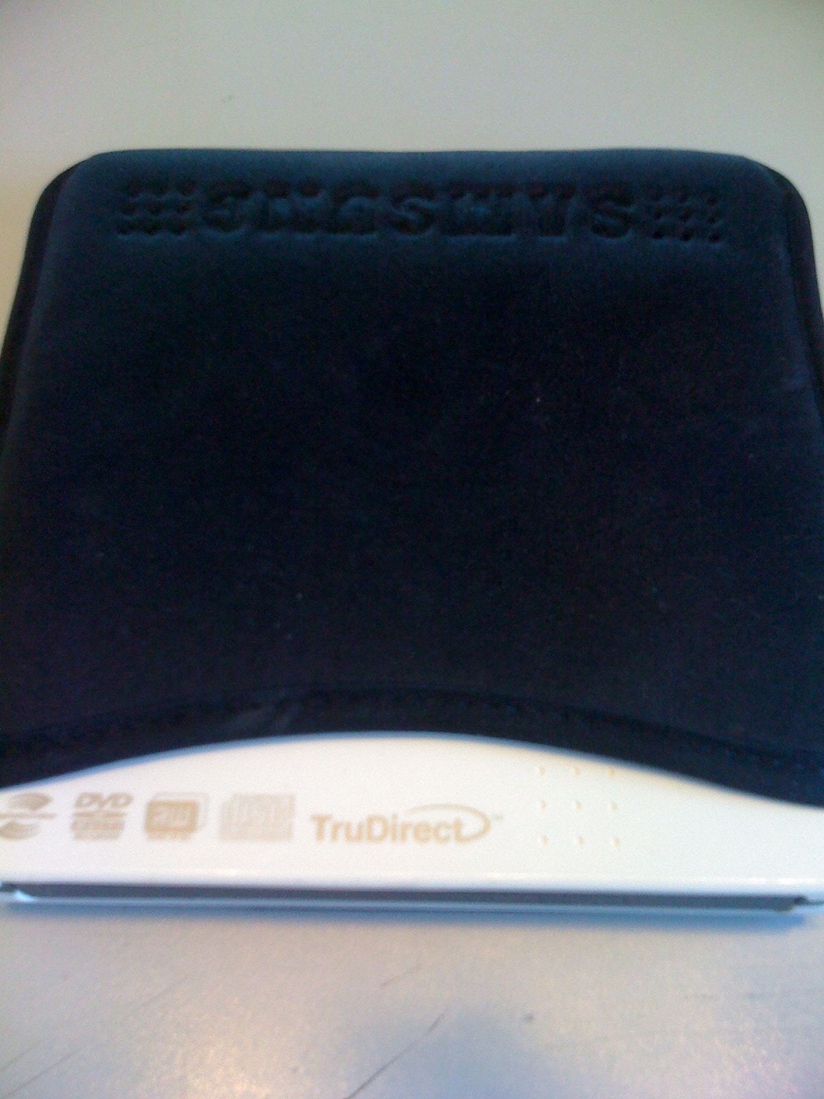

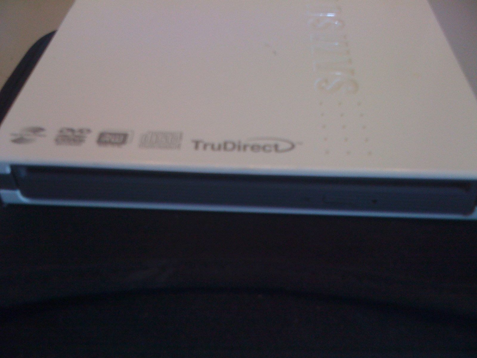

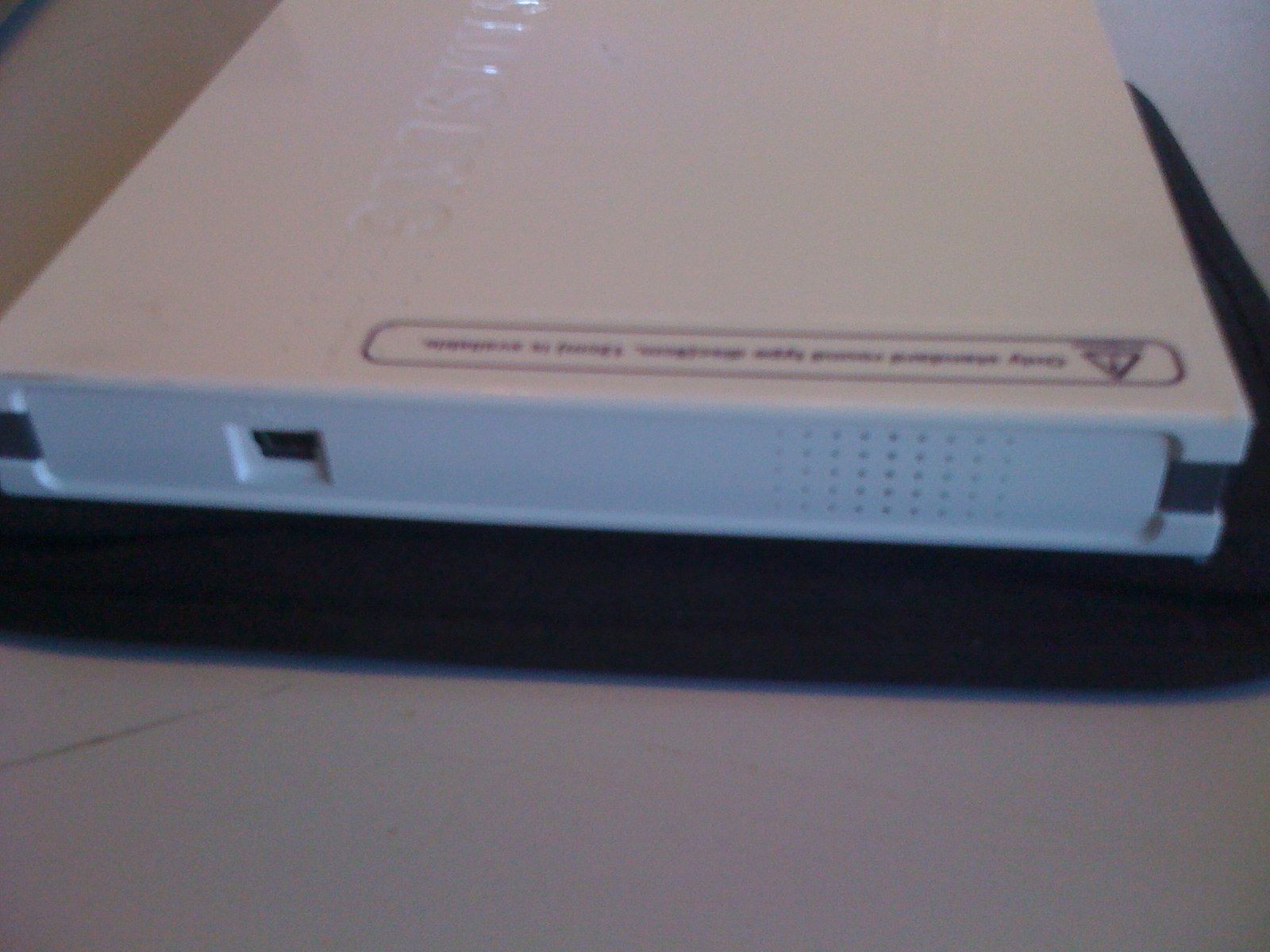

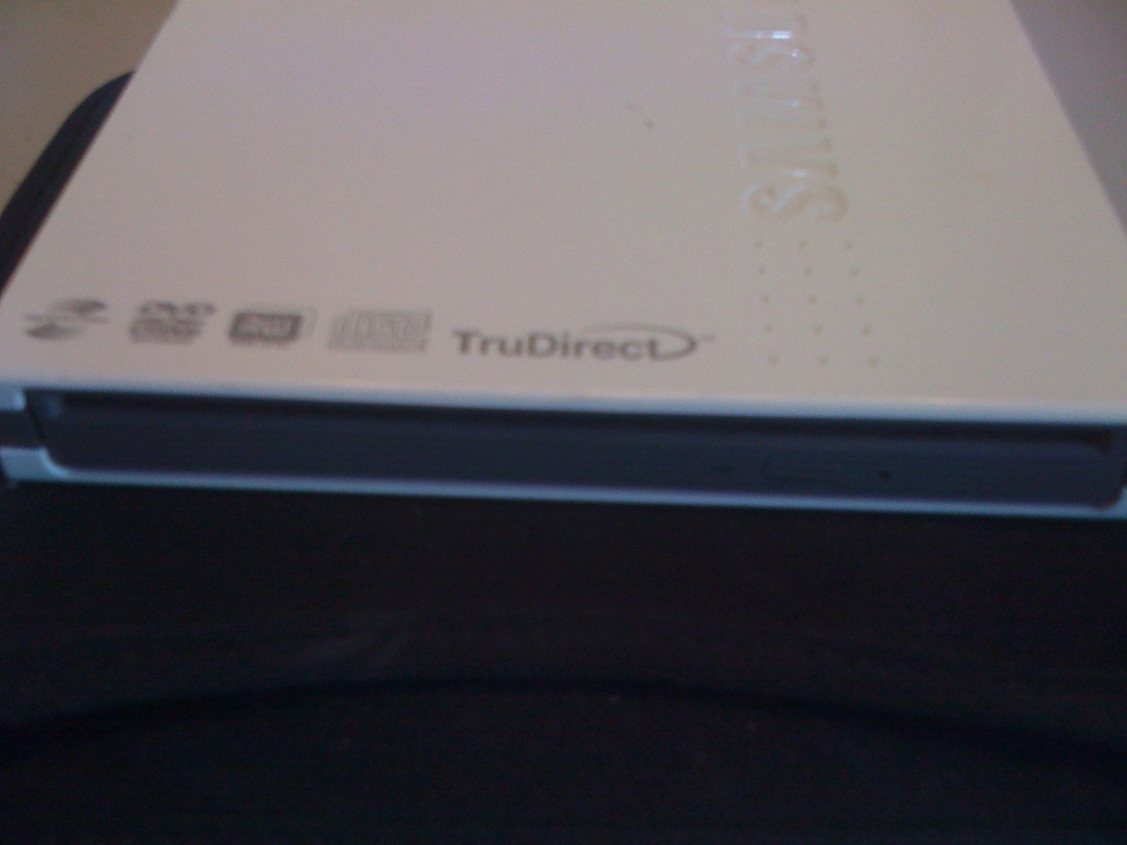

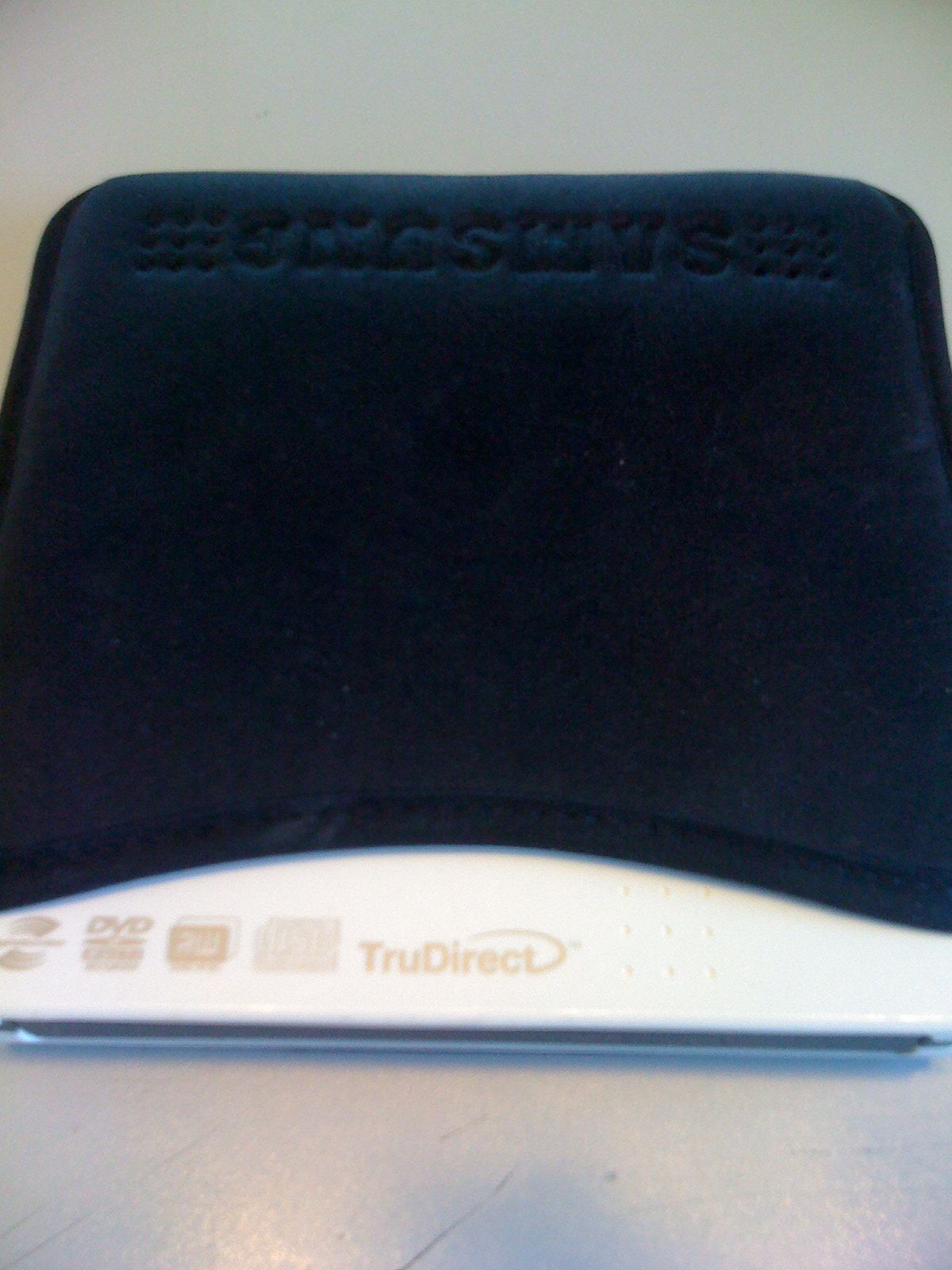

yep, i bought an external optical writer with lightscribe...its slot load...got it from new egg cheap 72$ us
ill post a picture of it shortly,
im rocking dual x25-m SSD's now 😀

here is the optical drive i purchased which is 10x better then the internal LG one.
