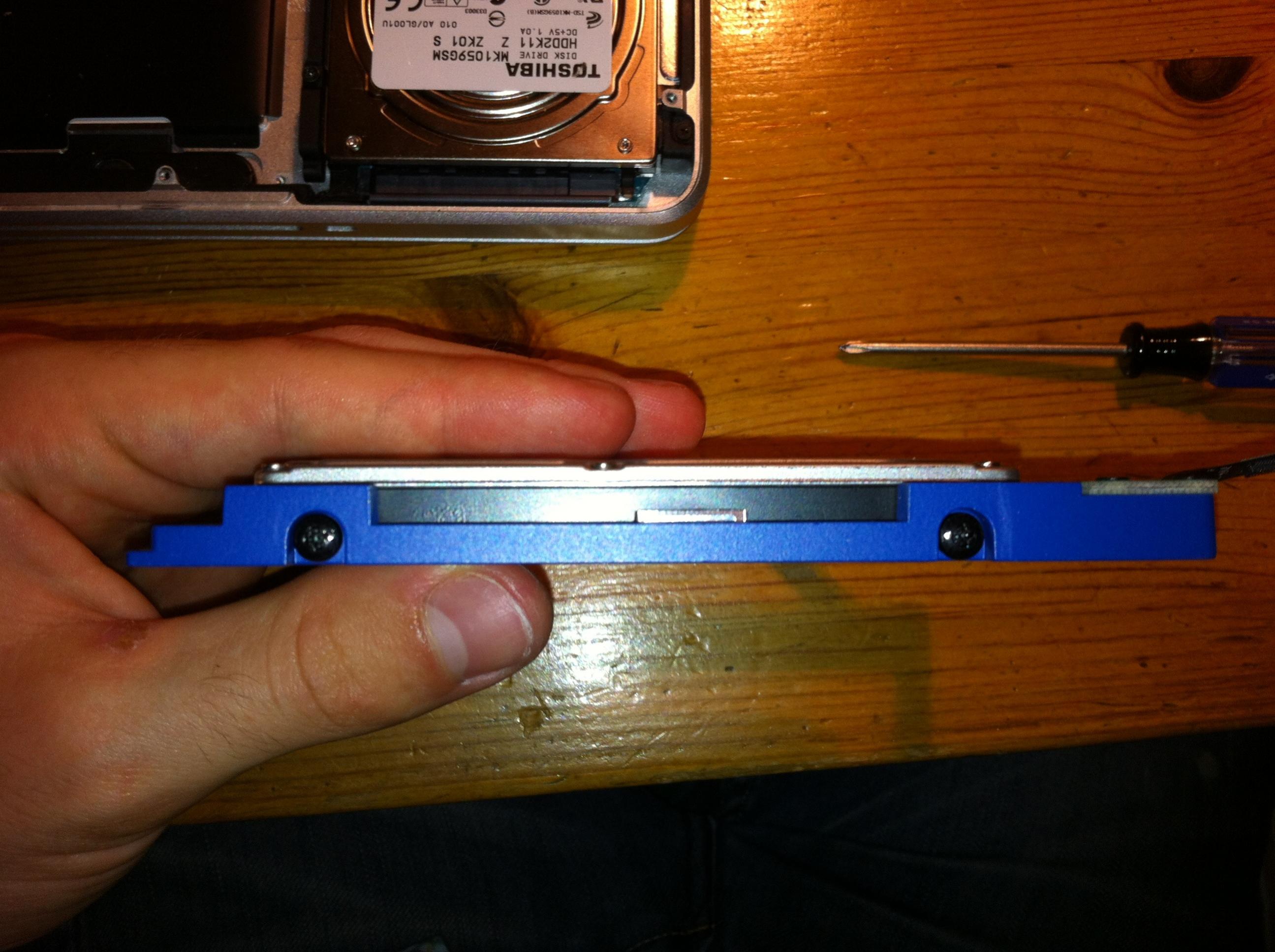

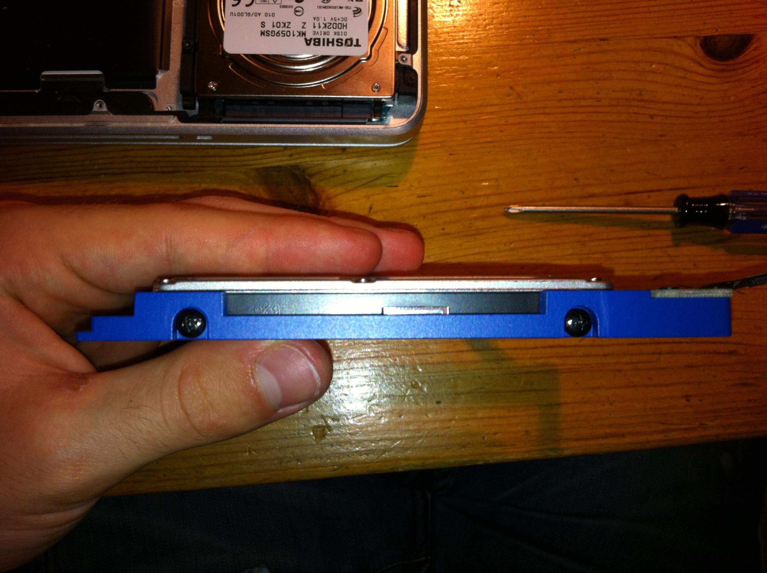

The real problem is its to big. maybe they sent me the wrong one. but it seems to be for the 12 mm one. here is my 750GB Apple Toshiba drive that my comp came with, a 9.5mm, in it. see the extra space?

Huh, interesting. That certainly does look like its made for a 12.5mm optical bay. Some people with non-unibody MBP were putting 12.5mm drives in their optibay caddies, so this is probably made for that. The nimitz will fit your uMBP fine though.

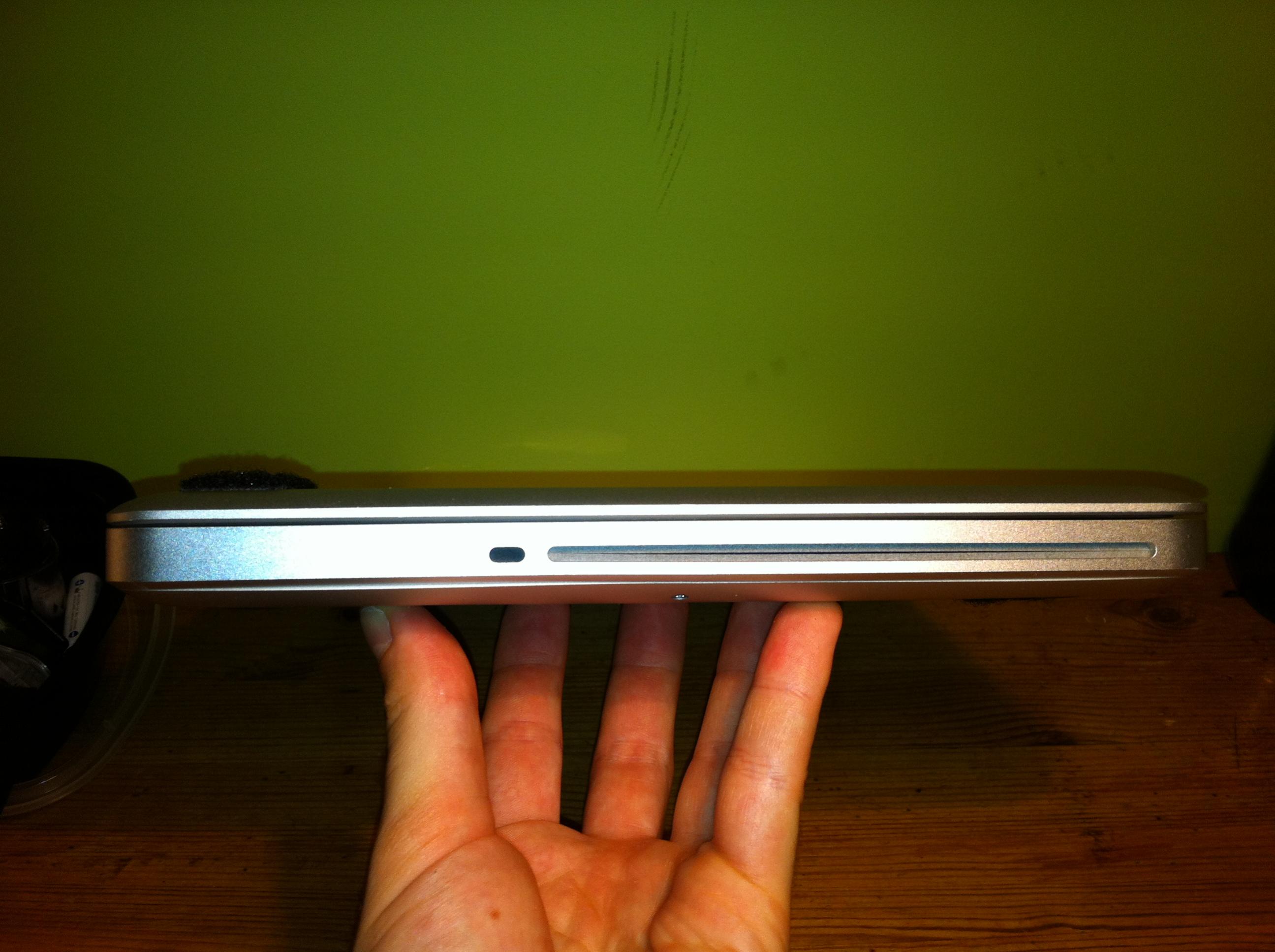

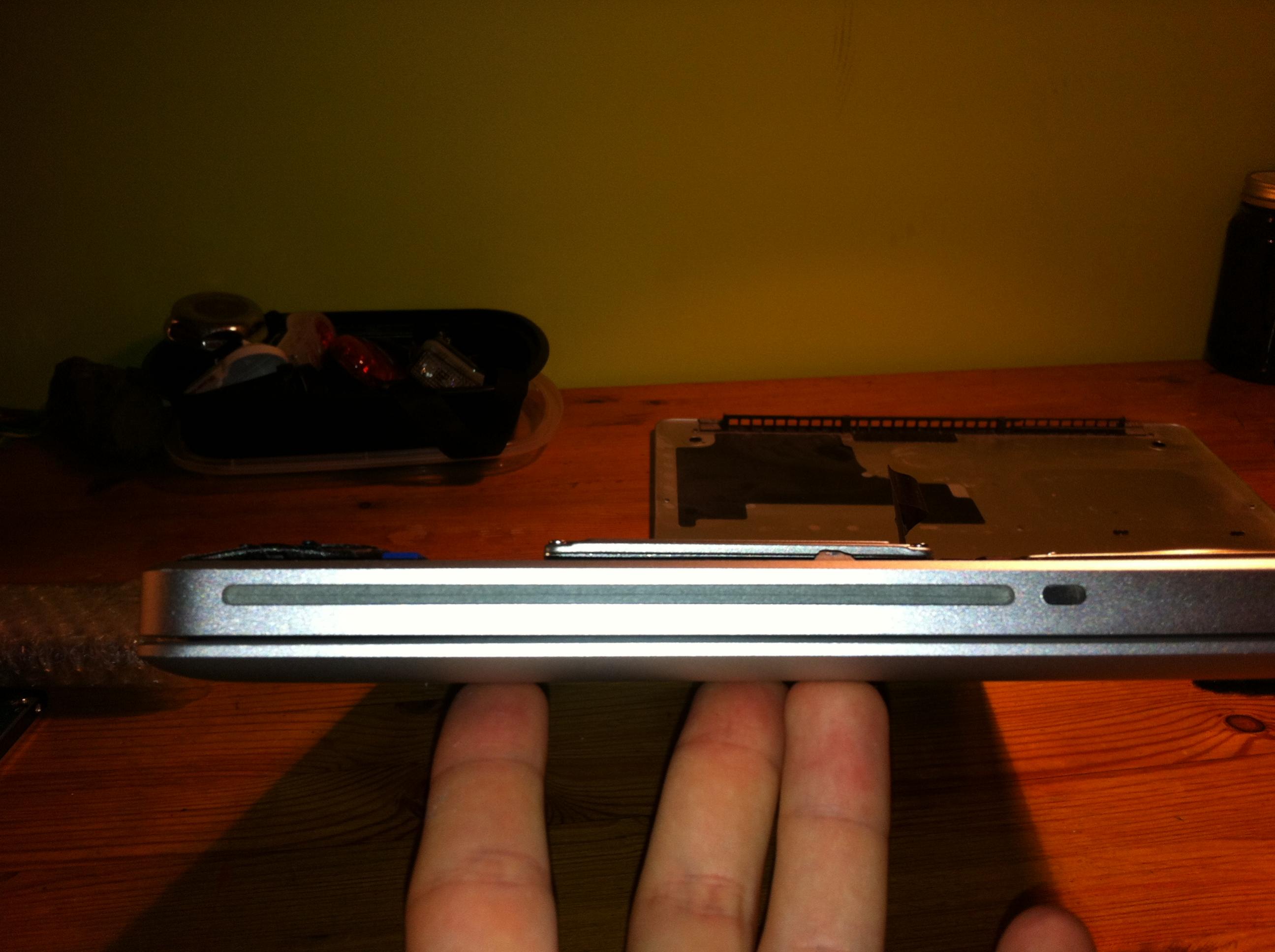

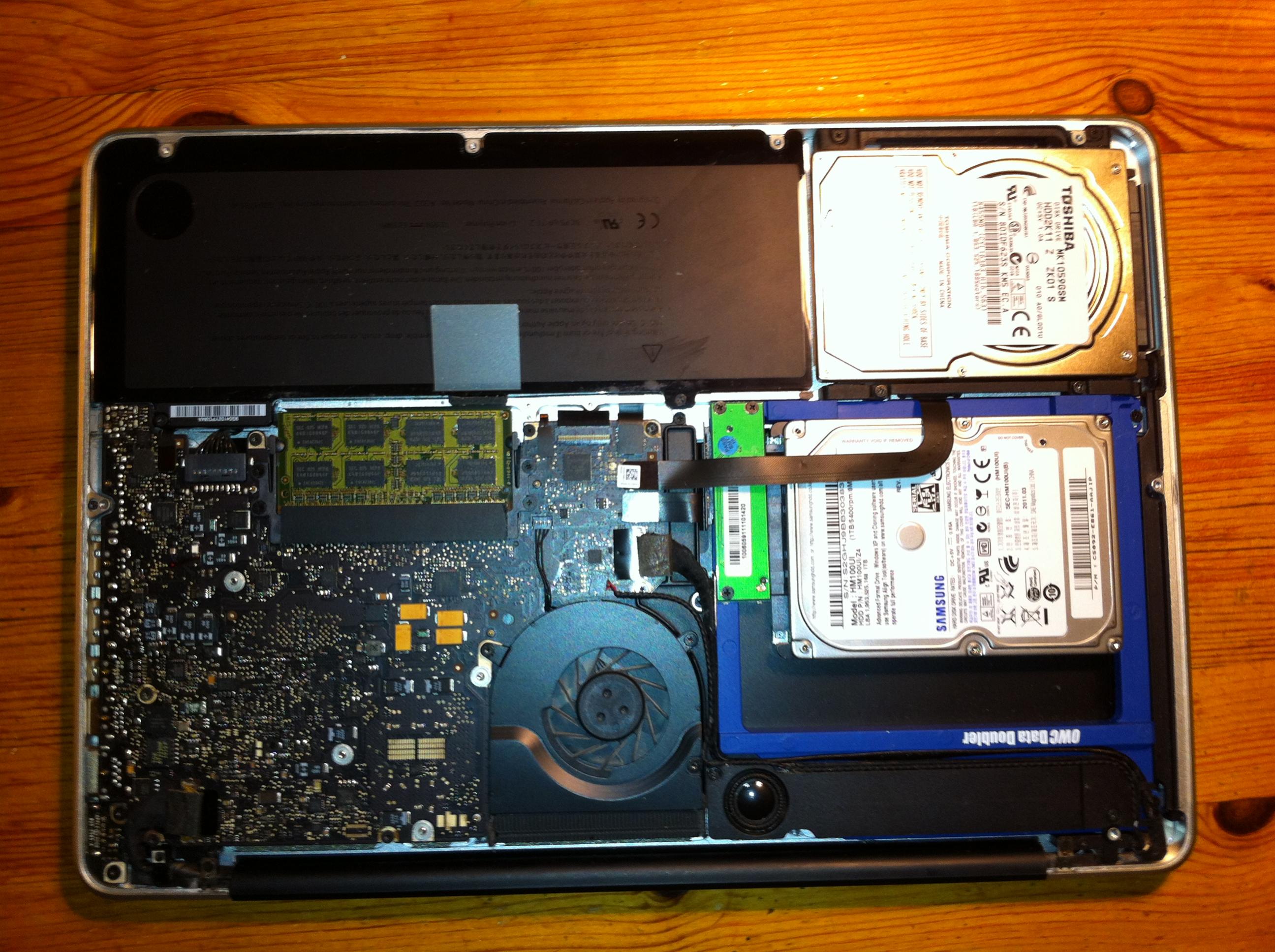

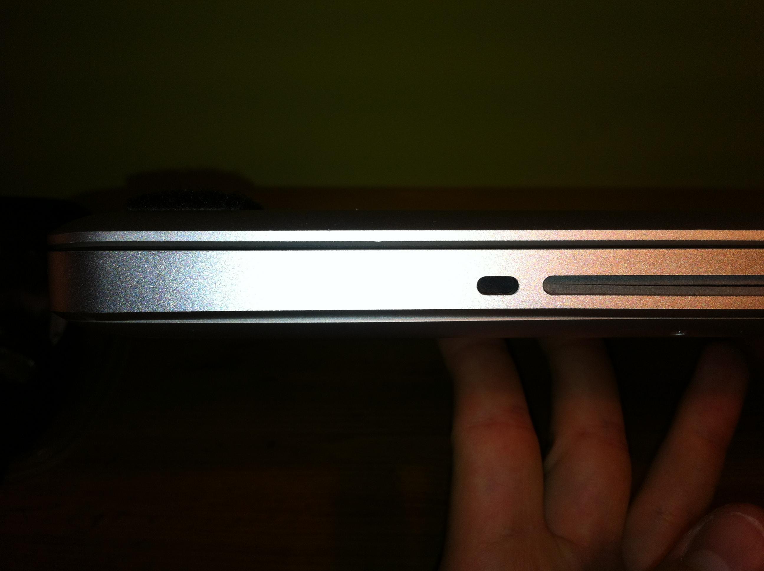

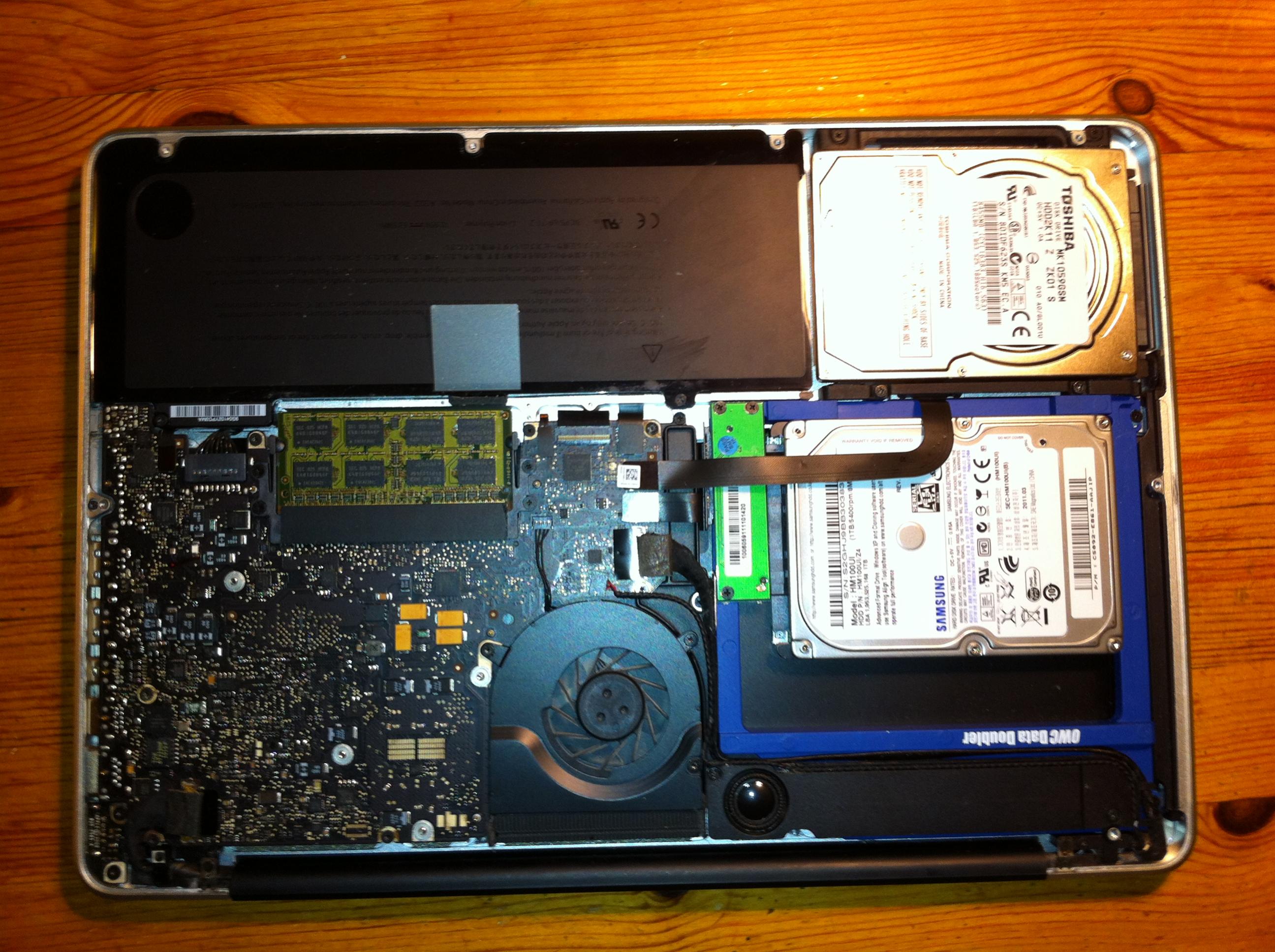

-So while swapping out the 500GB Momentus XT that I had in my OWC optibay for the 500GB WD black I'm running now, I decided to try a 12.5mm drive in the optibay slot. I took my 1TB 12.5mm Samsung drive which I use as backup and installed it in the optibay, and put on the bottom panel. And it fit really pretty good! The screws went in nicely, they pulled the panel inward more than normal, but that's to be expected with the thicker drive standing out a little bit. The screw on the side (right next to the drives) went in with, predictably, the most difficultly, but it wasn't so bad. In the end there was a nearly imperceptible bulge, if I can call it that, that was significantly less than 1mm. I tested to see if the computer would wobble on a flat surface and it didn't. Now, it might not be good for the lifetime of the drive to have it making direct contact with the bottom panel, but the setup seemed entirely run-able.
This was on a 2010 13" uMBP with the OWC DataDoubler.
Of course, right now there is no storage advantage to be won by running 12.5mm drives, as 1TB drives are available in 9.5mm, and 1.5TB drives in 12.5mm aren't available yet.
I just wanted to share my findings, if someone needs more storage space and has a 12.5mm 1TB on hand, I think this setup works well.

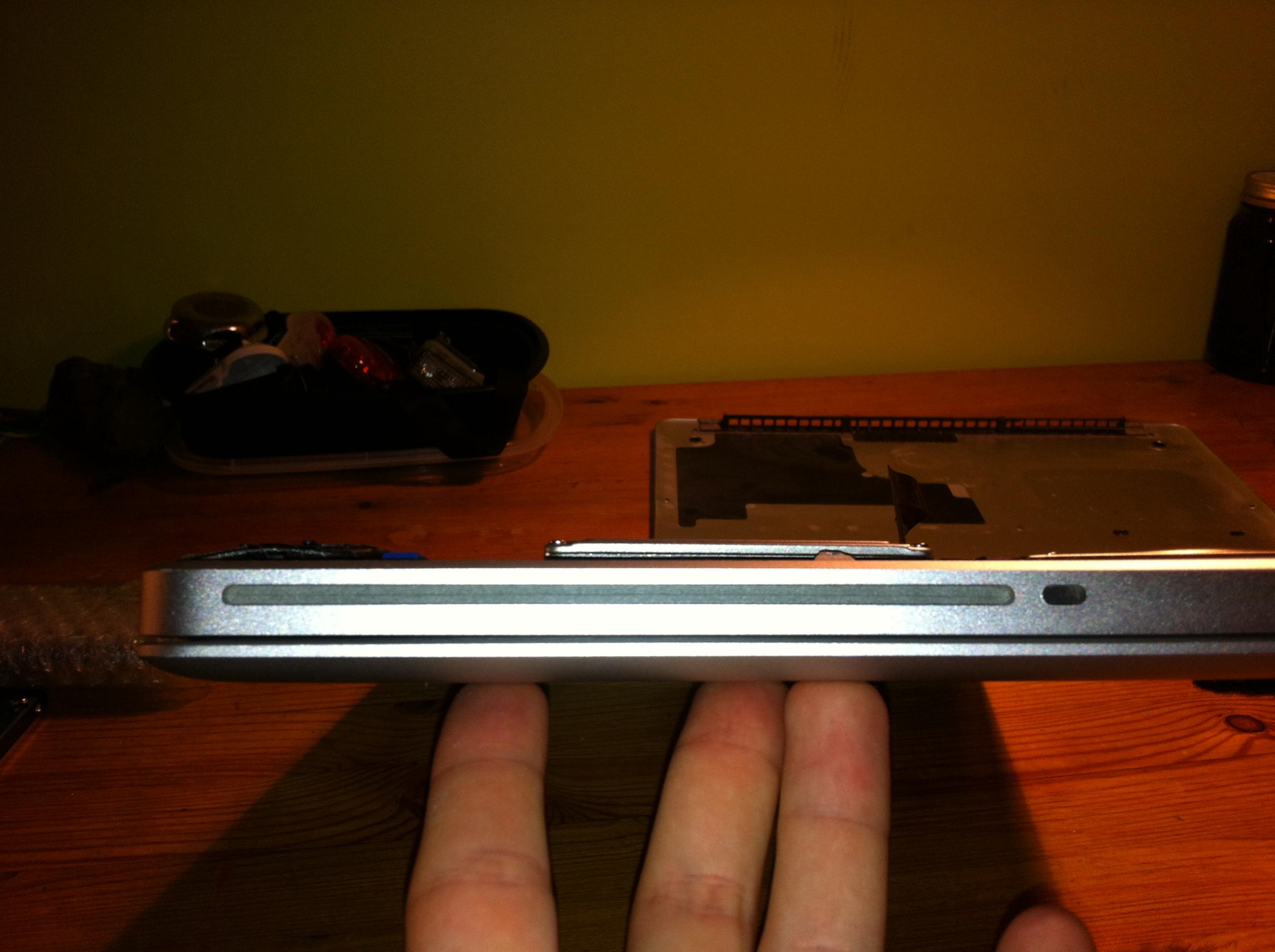

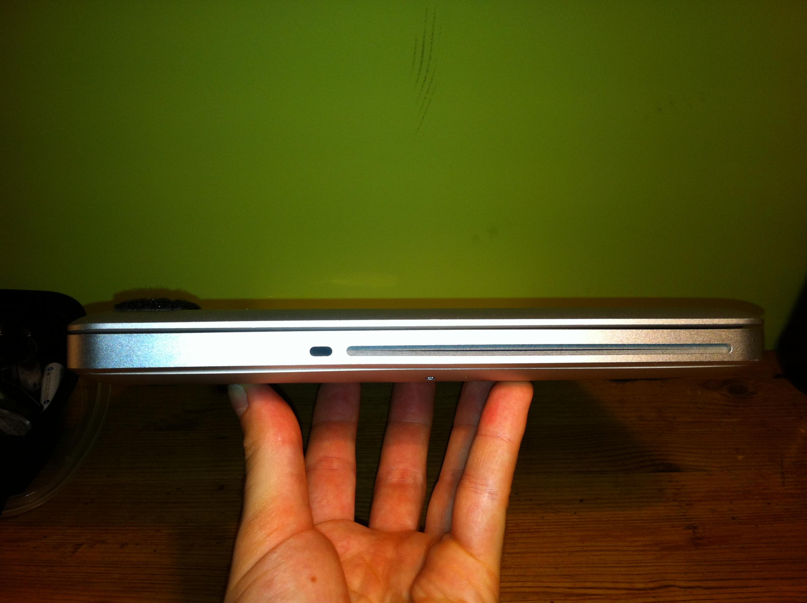

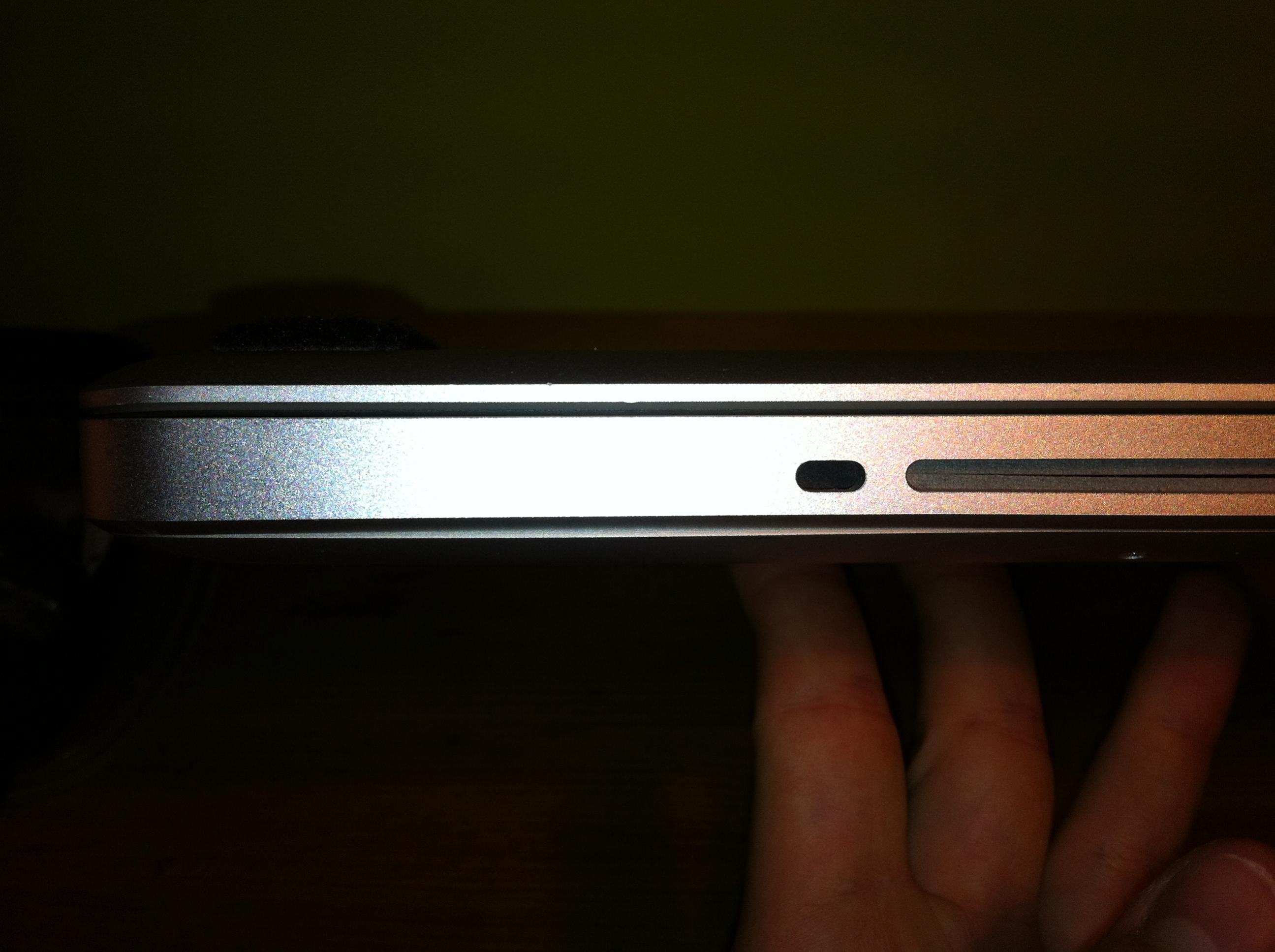

Also, here are the photos of the 12.5mm drive in the OWC optibay:
