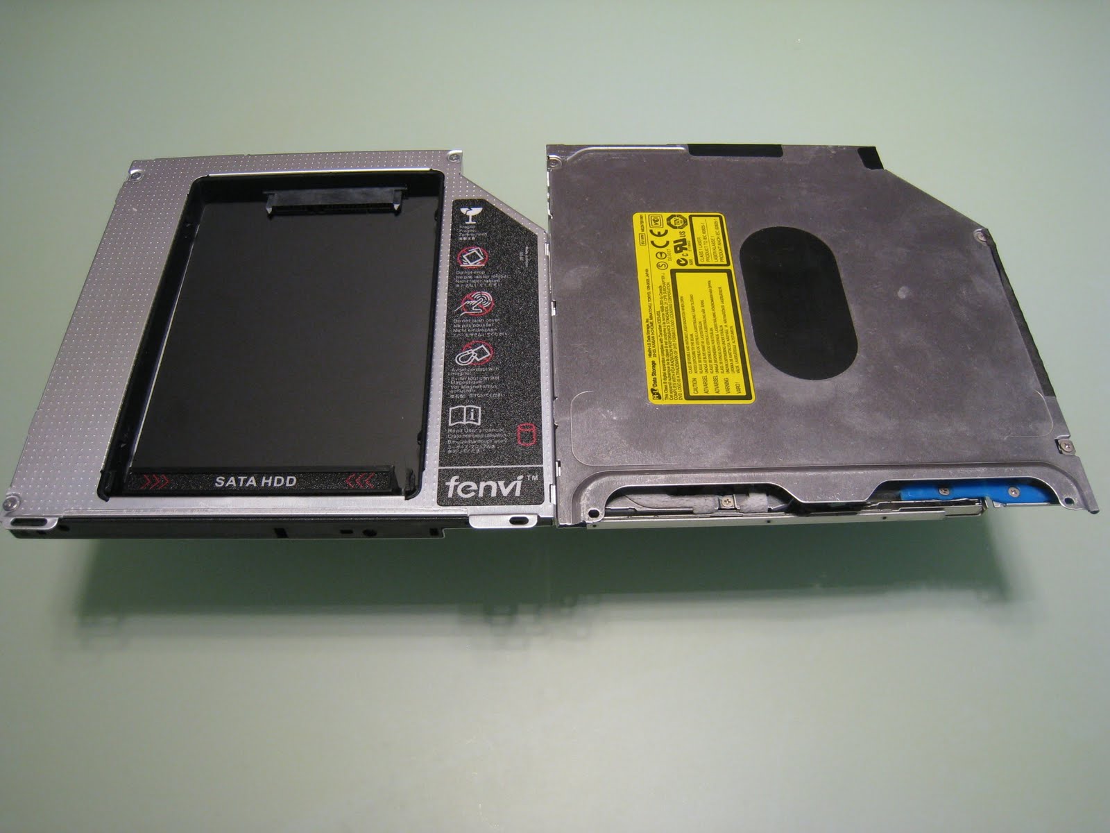

New Optibay from Fenvi providing two extra mounting holes. for anyone whom is interested.
http://www.ebay.co.uk/itm/swap-supe...Computing_LaptopAccess_RL&hash=item2eb69f22ad
I just got today in my mail the Fenvi optical bay caddy from 'Segoo' on eBay. I'll be installing it in the coming days. Will answer any questions if needed 🙂

After much deliberation I (2011 15" MBP) ordered the 'special' from Nimitz. It all works perfectly, easy to fit, despite finding out I had torx screws rather than Phillips. No more than 20 mins and it was all done, well worth the minimal cost!
Thanks for those that contributed to this thread, lots of reading but lots of help.

Where are you located? I have an extra Fenvi one (same as this) that I'd be happy to send you for free. I'm in the Miami area, but Priority Mail should get anywhere in the US within 3 days... PM me with your address if you're interested and I'll have it out in the morning. Thank you for your service, and stay safe over there!
