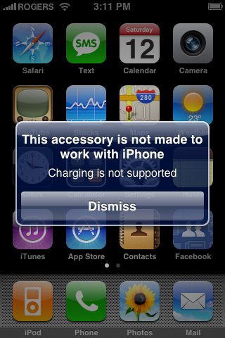

Can't use iPhone 3G with accessories
When I plug my original iPod FireWire charger into my iPhone 3G, I get a message saying that the accessory isn't supported, and charging is not supported!
Also, when I plug my iPhone into the FM transmitter I was using with my iPod touch, I get the same message.
What is the reason for this, other than wanton greed on Apple's part? I guess they need their finger in the pie of everything that can be used to enhance the user's experience of iPhone.
Apple is turning into something ugly.
This has always been the case... FireWire charging has never been supported on the iPhone. The transmitter will not work because of the GSM interference. There is a new model that will work with the iPhone, however.

Oh Sweet I got my new 3G iPhone. Awww... man my battery died from all the 3G sweetness... I know I'll plug it into my car charger that worked so well with my original iPhone.... WTF is this.... "This accessory is not made to work with iPhone. Charging is not supported." Now I have too go back to the apple store and shell out another $40?
I am so F'ing mad! It is incompatible with my car charger, a universal dock I have, and my insignia ipod boombox (which has a made for ipod licensed sticker on it)!

I get the same error message using an aftermarket car charger that worked fine w/ my original iPhone.
Pure Apple greed is to blame.
