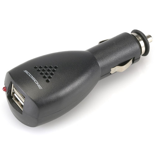

Yup I found that my previous car charger which worked fine on my old iPhone will not charge the new 3G, I get a message on the screen that it is incompatible. Also my AC USB charger doesn't work, it puts out 400ma and another one that I have puts out 500ma and works fine. So apparently the new 3G phones have a higher charging current requirement than the older iPhones.
If you keep your car charger in just one car, I'd recommend doing what I did -- spend $20-30 on an inverter that provides 120VAC wall plugs. It's not the most electrically efficient system, but that way you can plug in a wide variety of things to it -- an iPhone charger, a notebook computer, etc.

Just as an update, I spent an hour or two on Sunday pm wandering round Currys Commet and Halfords. The only thing I could find that would charge my iPhone 3G was the expensive Bose Speaker system, but at twice the cost of the phone I wasnt buying!. The Belkin with Cleartune for car would also charge, but it still warned that it wasnt compatible and I should turn on Airplane Mode to continue - and no I wasnt doing that either - kind of defeats the point of having an iPhone!
Most shops were not aware of this problem and were not amused with apple, they all have lots of speaker systems lined up hoping to make a killing.
On the plus side, all recent Apple chargers work, the one for my Nano is fine and i bought a spare charger and cable for work (just in case) from tescos for £18.99 - its identical to the one supplied with the phone in the uk :)
I tried a cheaper belkin car charger - without the radio tuner part - that wouldnt work either :-( interestingly I found one of the adaptors that gives a usb socket for your car - and that didnt work even with a genuine apple usb cable that I know charges the device with a real charger - though interestingly the phone didnt complain, it just never saw it.

My car charger (Griffin Power Jolt) charges both iphone and iphone 3g no problem.
