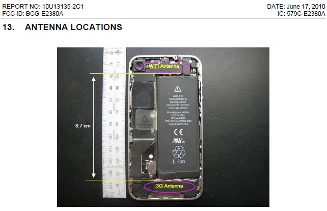

What's interesting to me is that Apple's pictures given to the FCC still show the 3G antenna as being at the bottom.
Furthermore, their SAR plots show all the 3G transmission as being at the bottom.
Double furthermore, the bezel lengths don't seem to add up to any even multiple of the bands involved.
So I'm a bit puzzled as to the actual purpose of the bezel as a part of an antenna system. (I'm not an RF engineer.) Some kind of a slot antenna variation? Part of an IFA type? Any experts around?
