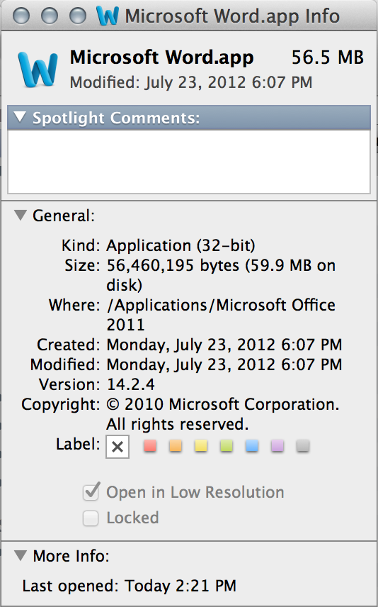

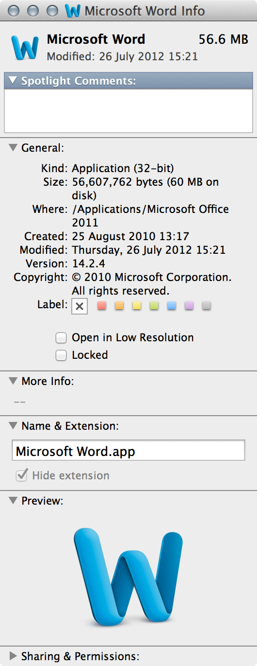

I downloaded manually from Microsoft as well. Might be worth checking the applications, if you 'get info', check that the "Open in low resolution" box isn't checked - it was checked and greyed out previously.
still checked and greyed out here... The only MS app where it's not checked and greyed out is Outlook - and I don't have a license for that (using home and student here).

see if "open in low resolution" is unchecked, it should be unchecked to work. this update works for me fine, but it's not 100% retina compatible.
Applied update direct from Microsoft, no change. "Open in Low Resolution" is still checked and grayed out. Rebooting didn't help.

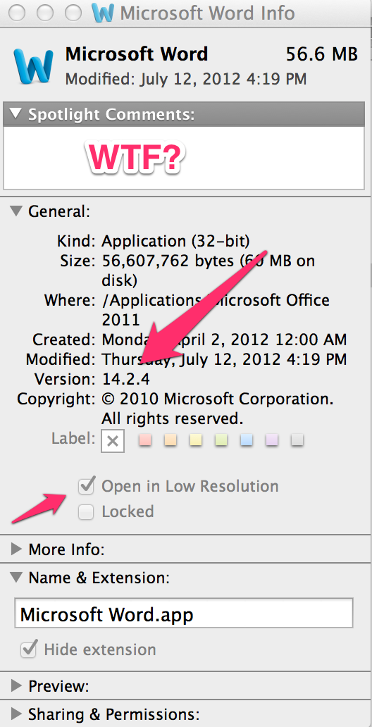

WTF? Locked in low resolution mode?
My Word looks the same and is locked in low resolution mode? What gives
  • Snapshot 9:19:12 12:23 PM.png

Edit: My Low Resolution Box is NOT checked (as you would assume.)

Looks like that box is the problem, not sure how to fix it though... Did anyone else who can (un)check the box use the previous hack of editing the info.plist file?

I completely rebooted, no change. "Open In Low Resolution" still checked and grayed. I tried manually editing the plist file. No effect. (The file *is* setting the NSHighResolutionCapable key to true, BTW.)

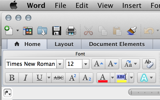

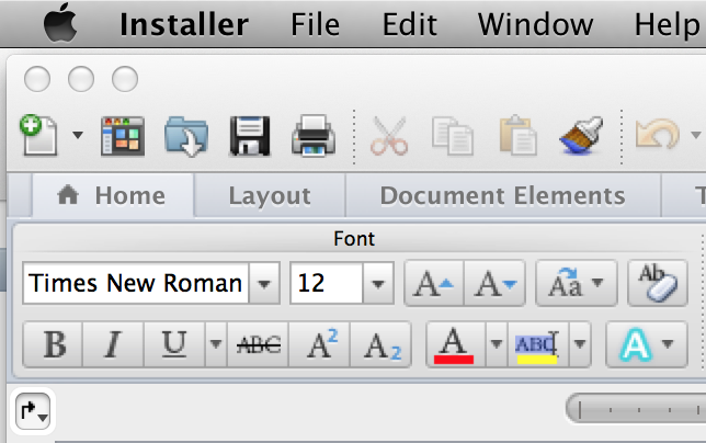

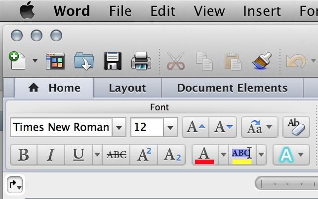

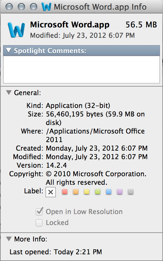

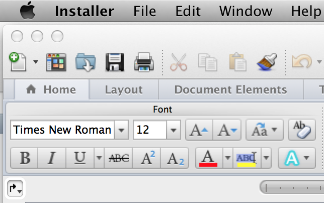

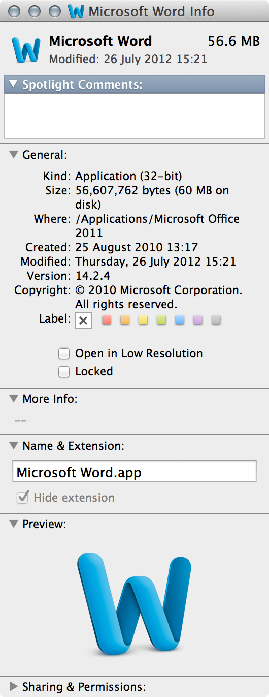

Like I said earlier -- worked fine for me. Not sure if a post a few up from mine here is right about needing to "touch" the app so OS X doesn't use a cached plist. But here's what all of my stuff looks like (attached). Obviously, the one with the Word menu is post-update, the Installer menu is right before the update, and the info window shows the data some of y'all seem interested in (i.e., the low res box).
