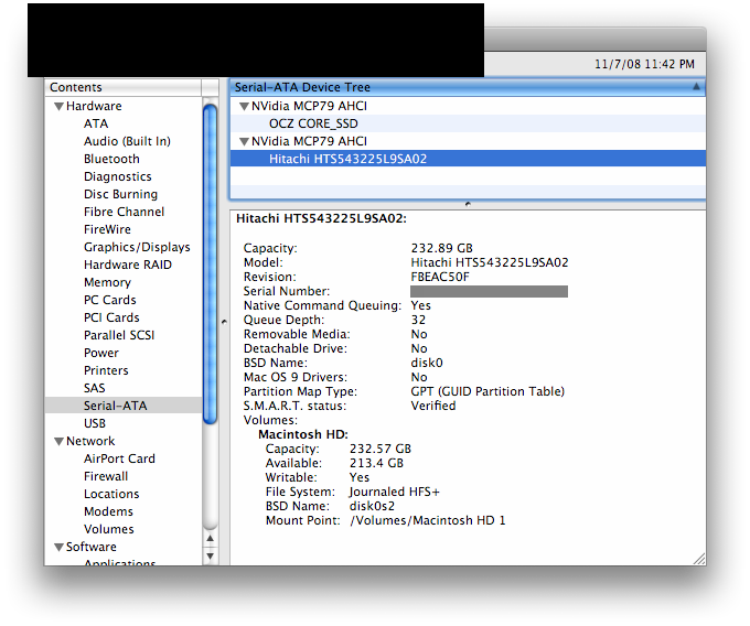

So I just discovered that I had cut the bluetooth data cable. So no bluetooth now... :-( Oh well.... Though, tonight I've managed to get the second hard drive installed hehe...
By the time I'm done with all the moddings, I'm gonna call this..
MacBook Air Pro :)

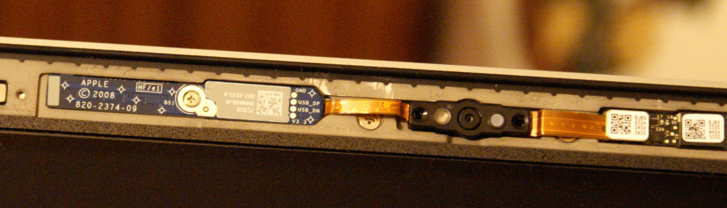

Is the bluetooth data cable a strip connector or does it use wires? I'm sure it could be repaired or replaced.
Nope not really. It's a custom cable. It runs from the isight module, to the isight camera and then to the bluetooth module. See attached picture. Bluetooth module is the one on the left. Oh well, it no biggie. I don't use bluetooth, and if I ever do, I can always get one of the nano sized bluetooth adapters.

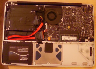

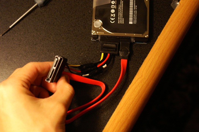

Bonus attachment - how I rigged the second hard drive :)
