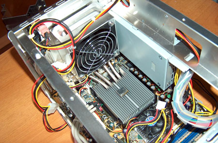

At the risk of showing ignorance...
I know that a number of people on here have posted illustrations of comparison between liquid head exchange and air heat exchange, but since the processor isn't (for obvious reasons) bathed in water, I really do not understand how it is any more effective than just blowing air.
I basically agree with the posts here which show concern about potential leaks in the system. I mean, is liquid cooling really worth it? I have seen (online, not in person) several different unique cooling rigs over the years, some of them liquid and others being air. The one I always thought was pretty neat is produced by Shuttle for their XPC system.
To wit:
The liquid cooling systems work better due to the fact that they conduct heat much better than air convects it. Ultimately, of course, they're all air-cooled... but the LC systems get the heat away from the chips more efficiently to the radiator.
Basically, as you say, they don't keep the processor in a liquid, but, in effect, the liquid is used to conduct heat away from the heat sink attached to the chip faster than air alone could.
