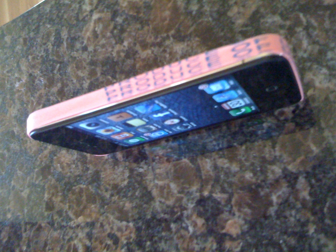

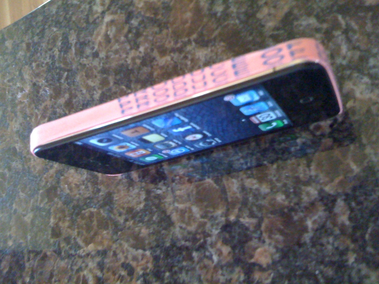

I tried the taped SIM experiment with no success. Same dropped bars. However digging around the junk drawer where I keep my tape I found a solution that really does work.
Find that extra wide rubber band that you saved from your last produce purchase and voila you have a free bumper! It really works.
Steve, for those who don't like broccoli, send them a bunch. They'll appreciate the fix.
