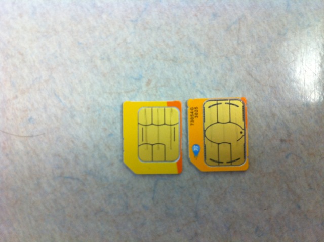

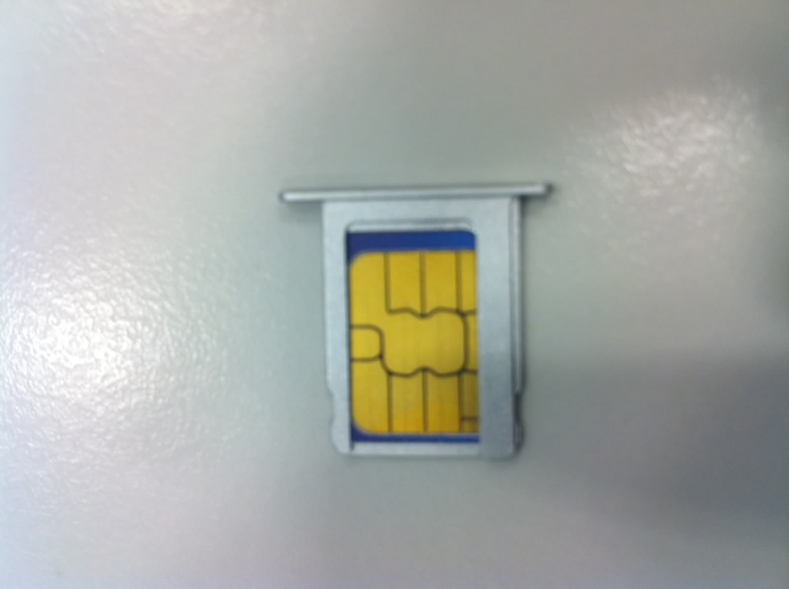

So my parents got me an iPhone 4, but when they bought it they had to activate it under their number. When they gave it to me I had to get a new micro sim card to put it on my account.
With the first sim card, there was no signal loss no matter how I held the phone. It has a smaller contact area than the new one (see pic).
Put the new one in and activated it on my account, and now holding the phone in left hand drops the signal down to 1 at work, no signal at home.
Going to go see if ATT has the smaller contact area card, cant use original one anymore.
Wow- I actually took the card out to take this pic, and after reseating it I don't drop any bars- seems to me the sim card is DIRECTLY related to the signal loss problem.

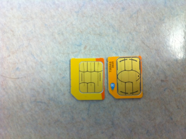

It appers that there are 2 models of SIM cards. For those who are having issues, is it possible to report which card you have? I have the one on the left, and have no real issues with the death grip.
i have the one on the right and have huge issues....hmmm....seems to me that we need a new thread with a poll and a pic of the two sims...
Love that GREEN spot in the centre of that image!
Let me guess you took that picture with your iPhone 4!
OMG!! Total fail.

I have the iPhone 4 and the iPad 3G
Both use microsim.
i have amazing reception on my iPad when using 3G never had any problems and it holds 3g signal better than my iPhone 3gs
This issue of the simcard touching the metal sim tray does not hold.
The microsim used in my iPad has a larger memory area and there is a large proportion of the sim is in contact with the sim tray.
This is my iPad 3g micro sim.
I think this proves that there is no basis in this fix.
