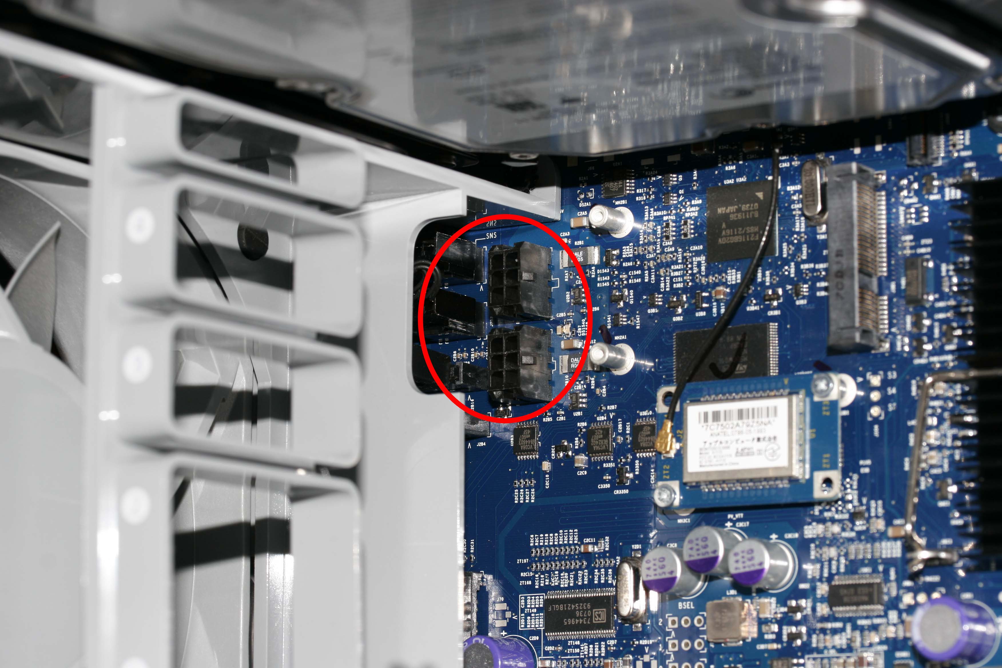

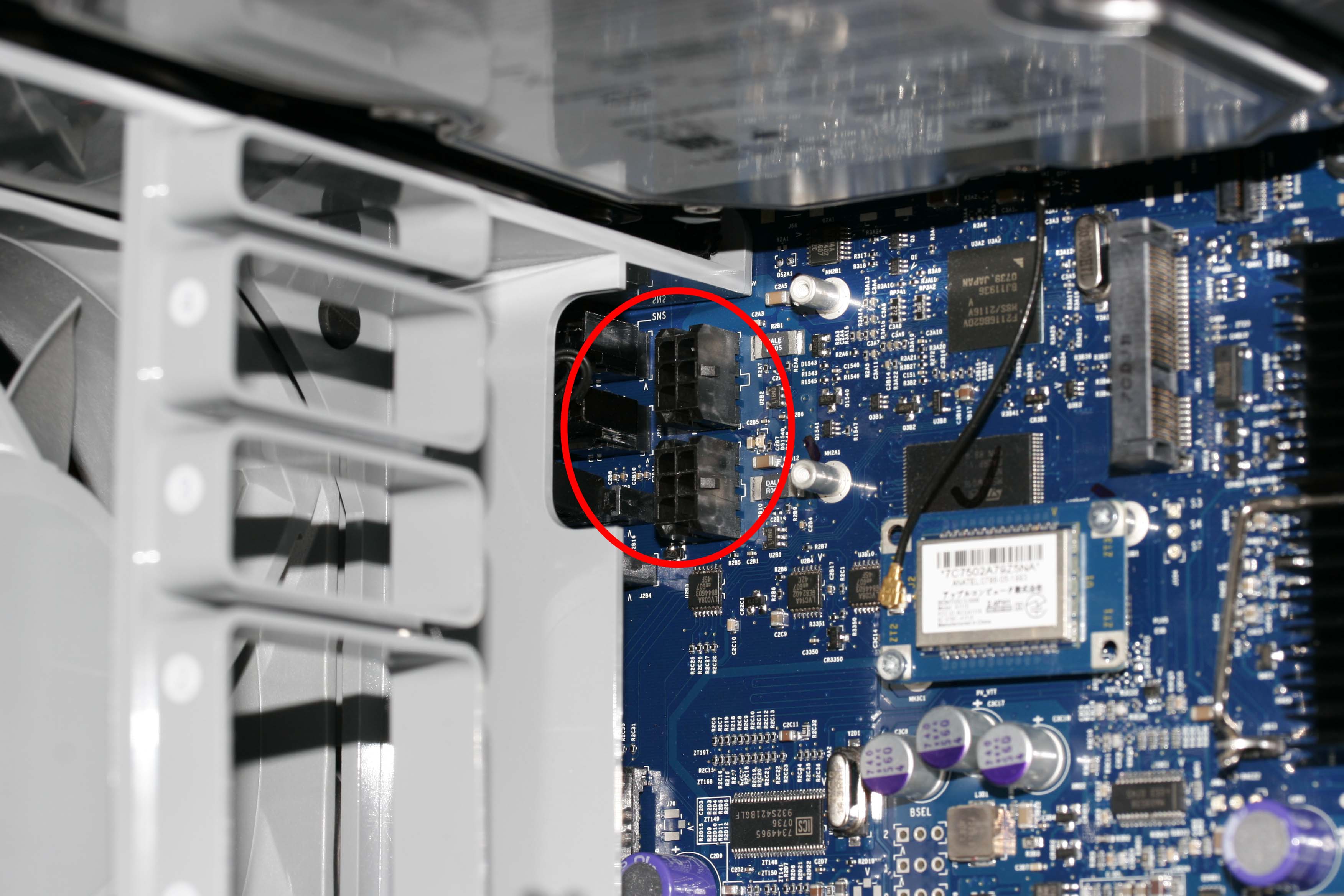

So when my 8800GT gets here, I'm going to have to plug that cable in? If so, how hard is that going to be?
Not very hard, doubt you'll have to take the fan unit out. Even if you do need to resort to that, it's only two screws. Takes about 5 minutes the first time, and 30 seconds each time after that😀

is anybody got an answer on the second connection of the 8800gt
I'm getting the 8800gt card to replace the 2700 card.
Am i going to have problems second connection?
When you put the card in, you'll reach over and grab an external power connector and plug that into the 8800 GT. It's as easy as cake, which is a lie.
