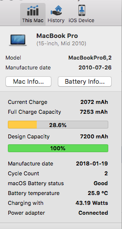

Hi. I did coconut battery and these are the results:
I don't understand why the battery lasts such a short period of time, less than 4 hours now, when it's not connected to the charge. As you can see, the battery isn't old, and I am running High Sierra. Any ideas? Thanks.
