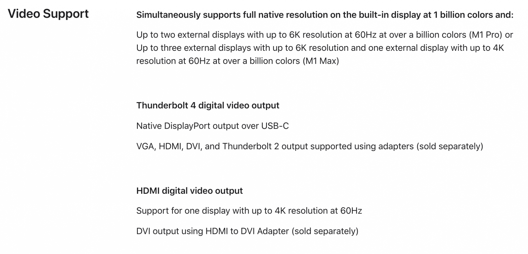

IMO this is the biggest reason so far to wait. I don't see anything on the specs page that shows 4K 120 even for thunderbolt.
Tech Spec page indicates 60Hz is max refresh rate for external displays across the board:
