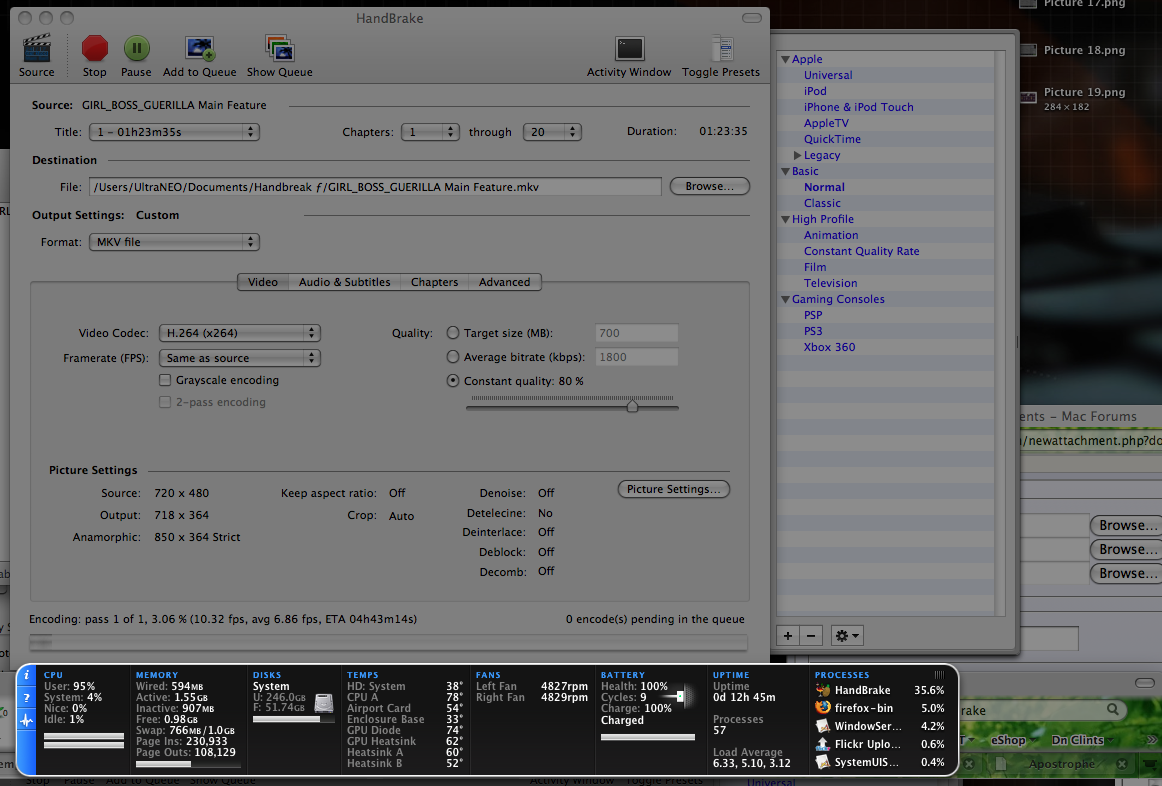

Could you please post temps of the machine under a load, such as using handbrake with h264 settings? I've done the thermal paste deal with my out-of-warranty macbook, but i'm debating on doing it to my pro. Mine gets to about 80-85C with the fans on full blast during encoding.

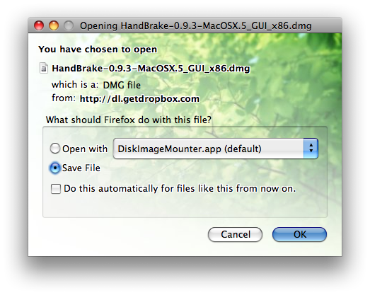

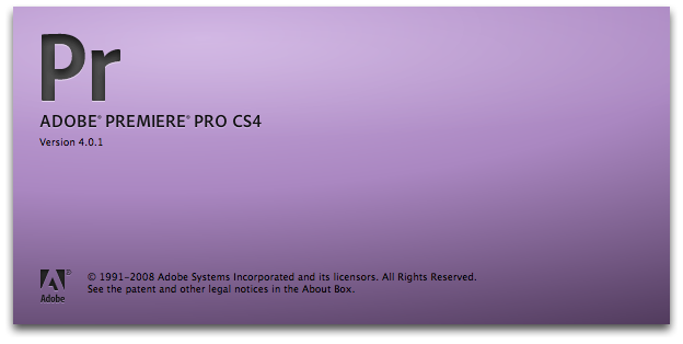

Sorry don't use handbrake. What is it? How about Adobe Premiere?
The objective isn't to make the machine run hotter, cause that would shorten it's working life.
HandBrake rips your DVDs and allows you to transfer them to iTunes for iPhone or iPod viewing. Adobe Premier is an older 2003 video editing software, that's been replaced by CS4/CS3.
Oh... I don't have any uses for it, no iPod... Though I do have Premier CS4 Suite

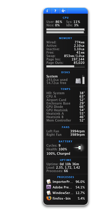

Here's a screen grab. On top of Firefox, iChat, iTunes I've opened a few more applications:-
MacTheRipper is tryng to rip a some what scratched DVD,
Adobe Photoshop CS4 doing something with effect filters on a sizable image,
LightRoom 2.2 sitting idle in the background
and Adobe Premiere CS4 is processing video for 1080i HD output.
All in all, forcing the machine to work harder!!

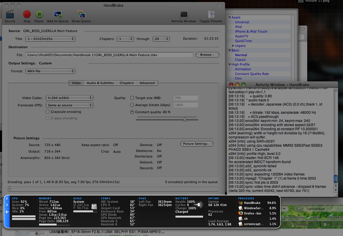

your temp running handbrake with cpu at 83%, aka 60 degrees or so, is what my core duo MBP is at with 9% cpu running only safari... I have an original core duo MBP Scorcher:rolleyes:
Just for you...
attachment.php
attachment.php
All system temps have fallen as soon as the fans kicked it...
ambient temp is 13°C :eek:
