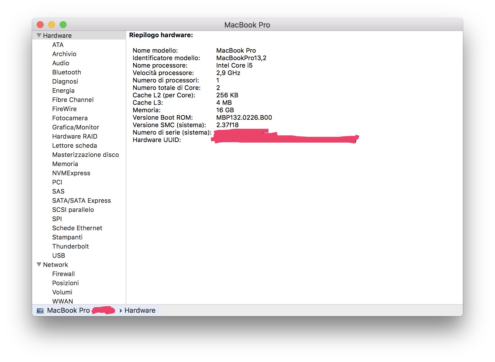

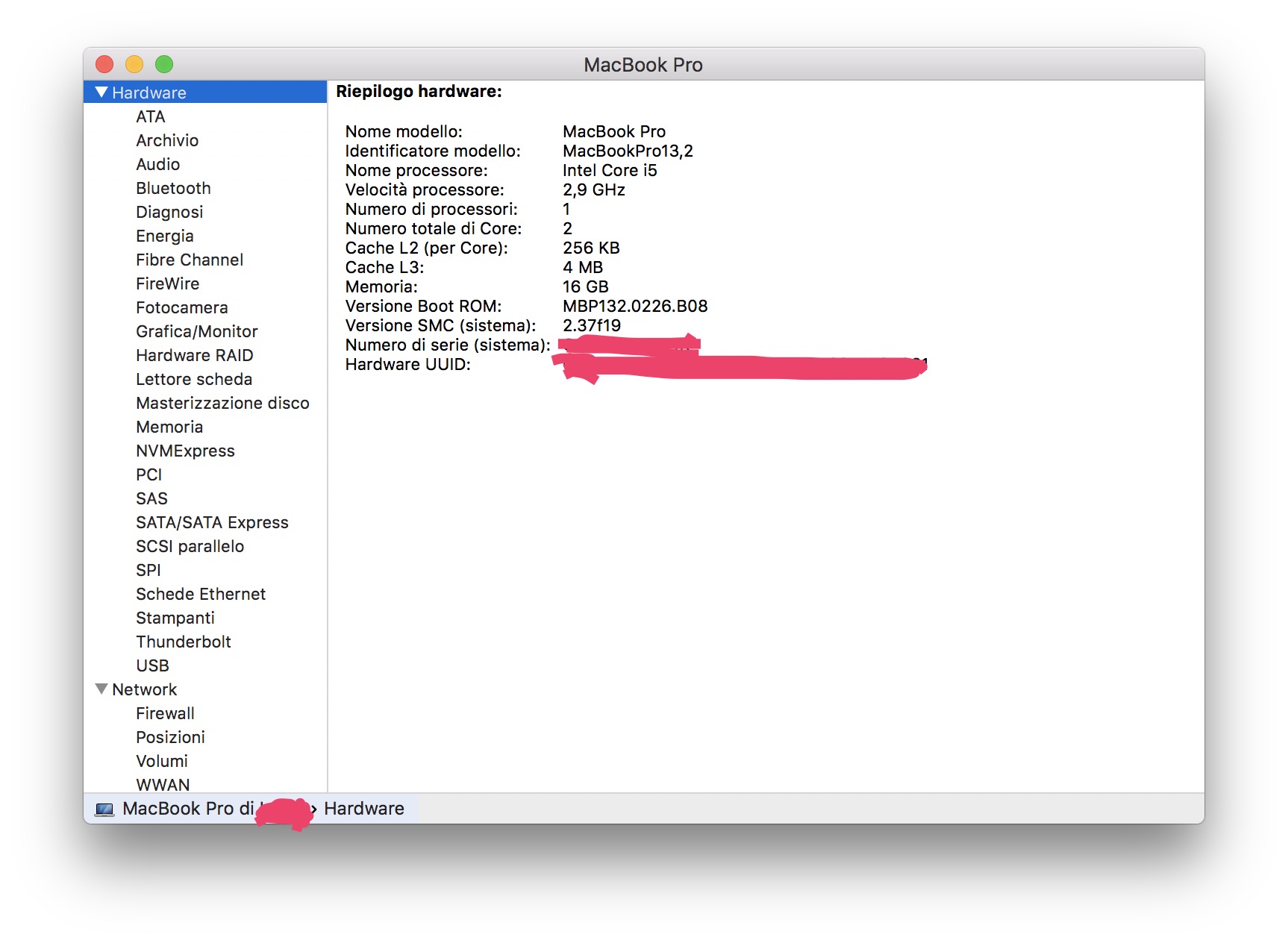

Please verify if your Boot ROM Version and SMC Version got updated.
Would you please open a bug report at: https://bugreport.apple.com
Describe what you did and what happened. Attach the error logs, etc.
You can see my Smc and Boot ROM version before and after 10.11.2 update.

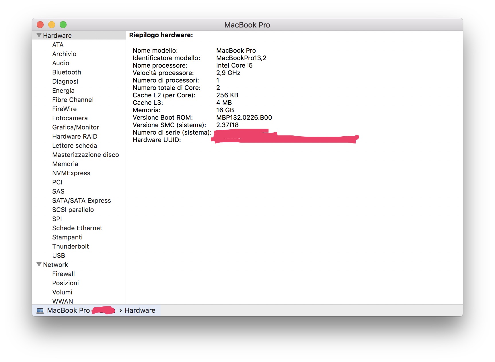

My SMC and Boot ROM were not updated yesterday with macOS Sierra 10.12.2, I don't know why.
So... I have downloaded and installed the combo update from Apple, and now my SMC and Boot ROM do have been updated and the issue is solved!!
My SMC and Boot ROM before and after installing the combo update are exactly the same versions that catalambano has posted.
Thanks!
Thanks!
