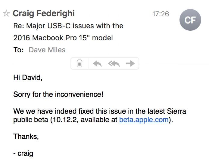

Just got an email reply from Craig Federighi confirming it has indeed been fixed in the new beta! Phew...
'Hi David,
Sorry for the inconvenience!
We we have indeed fixed this issue in the latest Sierra public beta (10.12.2, available at beta.apple.com).
Thanks,
- craig'
