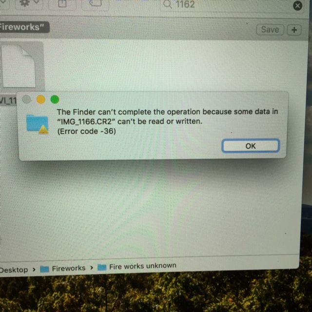

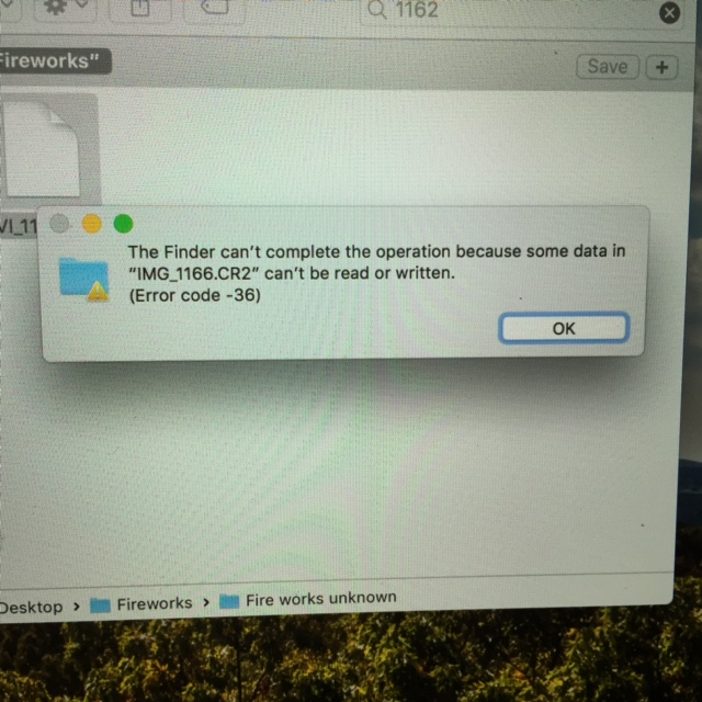

I live in a college town...my local Apple Store is used to seeing everything under the sun a college kid can do (3 large colleges within a short drive)...none of the Apple reps had heard of this nor could figure it out. They opted to not replace mine for the very reason that it will most likely happen again. In my case I was able to find the exact file that caused the crash and isolate it. Without that file it worked fine at USB-C speeds or 3.1 depending upon the drive. The second I tried copying that file to a drive it crashed. When I introduced a USB 2.0 hub it solved the problem.
Actually, the fact you're trying to copy a .CR2 file is interesting. I'm trying to sync my Google Drive which has around 500GB of.... .CR2s. However, the drive instantly crashes my machine when it tries to mount, so this is probably more of a coincidence than anything.
