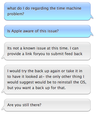

Hello from the UK, Apple over here doesn't seem to be aware of the issue:
