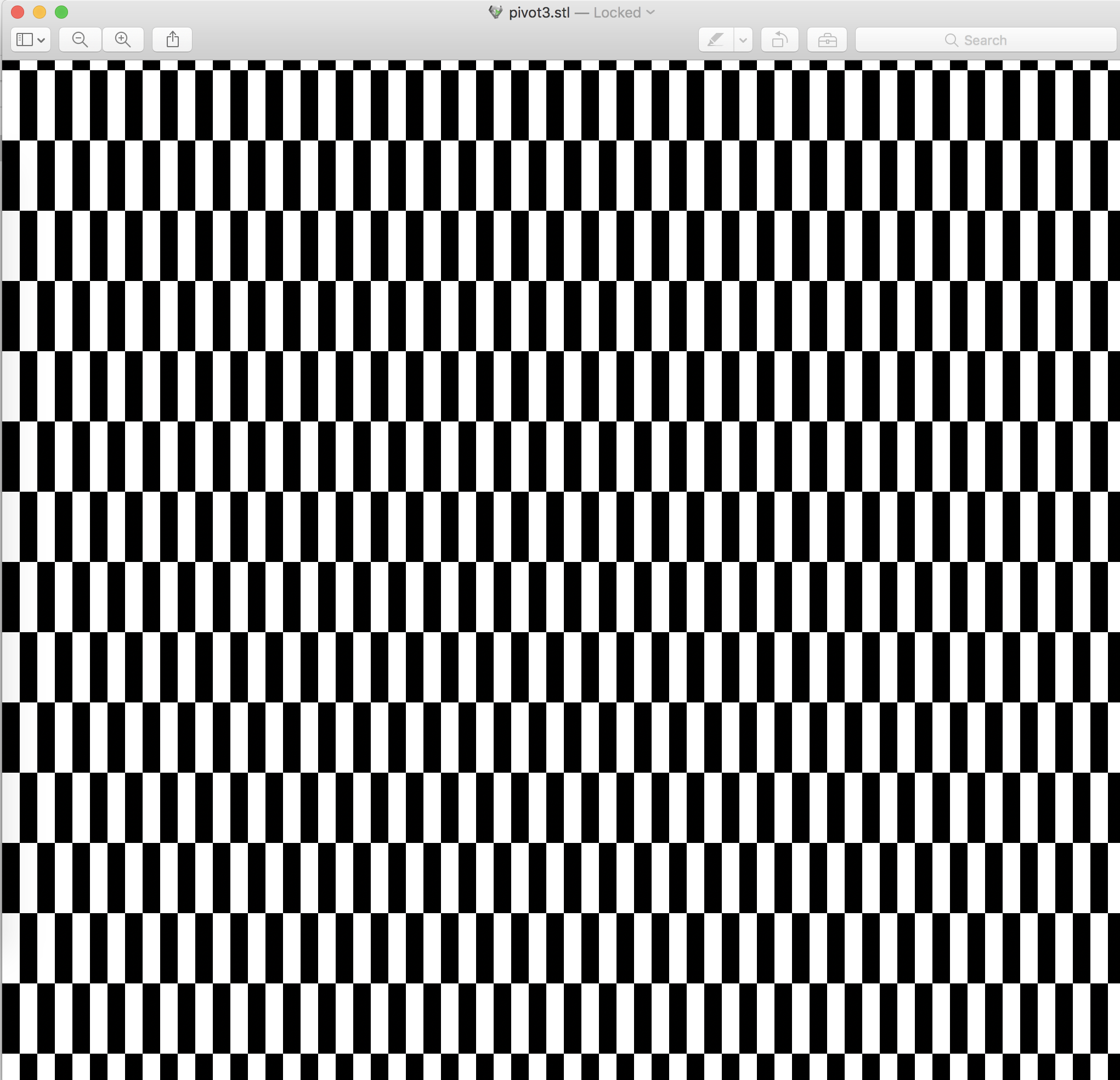

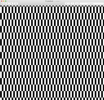

P.S. Anyone else getting the checkboard pattern in Preview when opening an STL file? Once you move the item, the checkered pattern goes away and everything appears fine until you stop moving it, this is where the window become the pattern again.
STL displays fine here, but I am on a 13 inch model with internal graphics.
I was seeing the checkerboard but can't seem to reproduce it right now. Mine was also in the preview pane of the finder window. It seems to come and go.

(On an unrelated note, I do see that checkerboard pattern in Preview with two STL files.)
