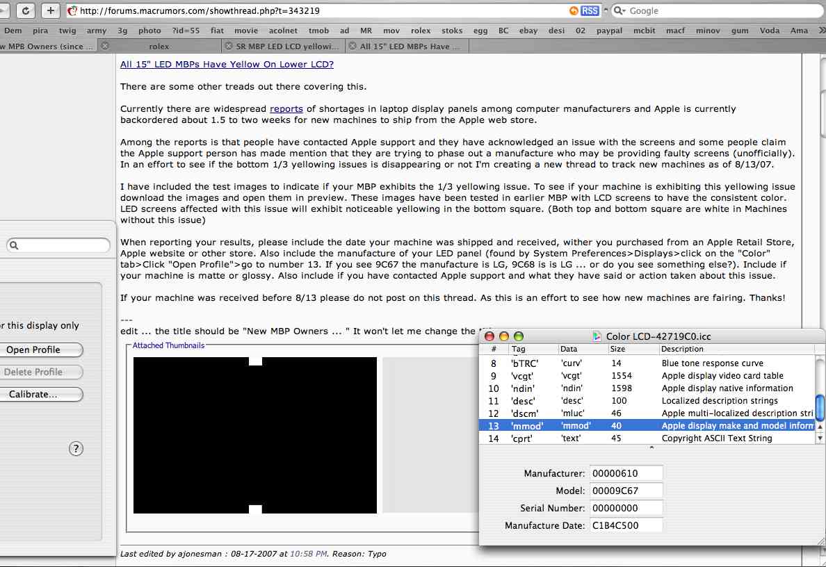

Ok... Now I'm really confused. I ran the two test images fullscreen, and the bottom square is a tiny bit darker than the top, but clearly not "yellow". Just not quite as bright a white as the top one. I'm thinking it may well just be that the backlighting is a bit stronger at the top. Is this the issue everyone's talking about?
Also, the grey test image should exhibit some yellow gradient towards the bottom overall too? I don't have that.
Is this issue more subtle on some machines?
BTW: I have a samsung screen, build week 31.
This issues hasn't been as clear as the yellow. But I know when you test the images on a 2.16 or 2.33 MBP the images are fairly consistent barring the normal color/brightness shift as you move your head around on the screen. Perhaps this is what your noticing. Hard to say with out seeing it in person, but the yellow issue is very apparent using the squares.

I would guess what you notice is a slightly varied backlight or just that your eyes are more straight forward to the top of the screen than the bottom and that you therefor get a small difference in light due to the viewing angles of TN-screens.

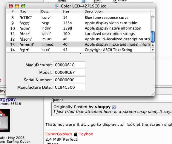

Check about this mac under the apple and then more info followed by display. Check vendor:
9c67 refers to LG 9c68 refers to samsung.

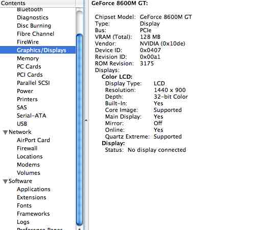

I just tried that attcahed here is a screen snap shot, it says nvidia. also above is my screen shot of 13 under profiles in system pref.

Thats not were it at....go to display...or look at the screen shot above
I have gone to display and this is what I have, I have attahed a snap shot. Can some one actually expin what I have. As I do not undertstand, thanks in advance.
It looks like you have an LG screen.
So now the question is, is it yellow at the bottom?
You have so see the MODEL and NOT Manufacturer code... From your model 0009c67, I think you have LG...
Do you have yellowing issue when you open the image in the first page of this thread in full screen (compare the white box on the top and the bottom)??
You should see it STRAIGHT on, not from the side of any other angle... In another word, you should see it with your eye sight perpendicular with your display surface.. If both of them are white, you don't have yellowing problem...

go to System>display.>color>open profile>13 that will tell you :)(9C67) is a LG
I picked mine up at the apple store about a week ago. How do i find the build week? My display is an LG and I downloaded both images and ran the test. The black image showed both white squares just fine. The gray image however seemed to have the lower white square just a tad bit darker than the top, but it was barely noticeable. I think it might just be my eyes playing tricks on me.
