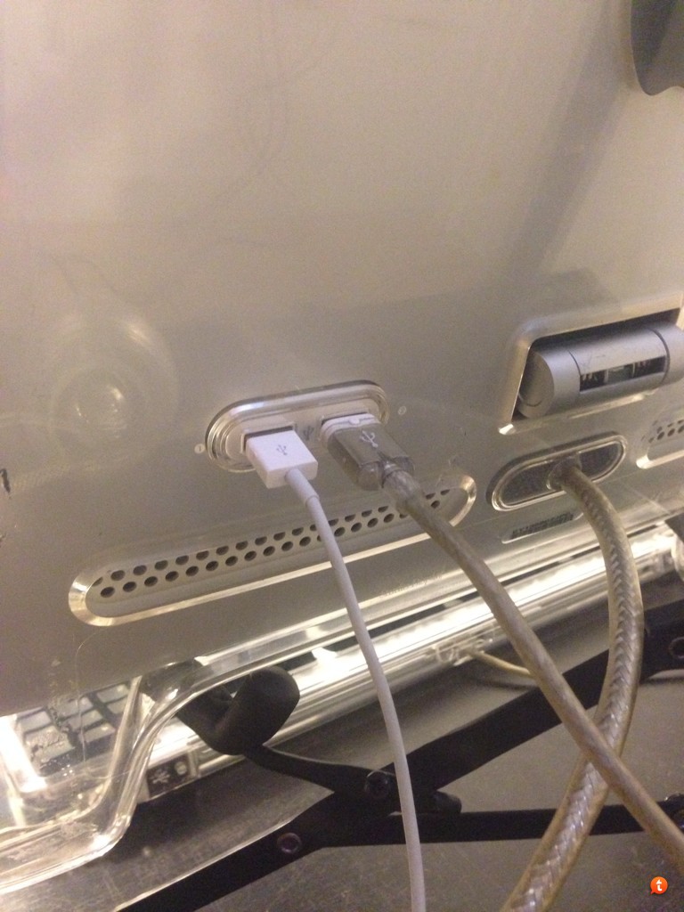

I had to search around a little about those Cube speakers. They get power, and audio, through the USB port. They are sold as working only with the USB port on the cube, which has more power than standard USB ports. You can also plug into the USB ports on certain Apple displays - those that are powered through an ADC connector.

Got them plugged into the back of my other Cinema Display and no sound. Does the amp have to be plugged in also?
Solved! I had to change the output settings. Any idea about the screen?
Try plugging them straight into the PMG4. If that doesn't work, try switching the output in Sys Prefs. I know the driver was in OS X through 10.6.3, which was Intel only, so in theory they should work with any PPC Mac running OS X (maybe even OS 9, but the driver may have only been in the Cube's version of OS 9).

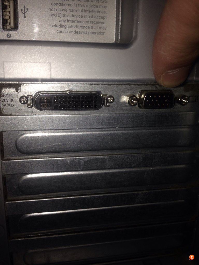

Also, that first display you pictured won't work. Your G4 looks to have VGA and ADC, those displays used the old DB-15 connector found on Old-World ROMed Macs (Beige G3s and earlier).
Cube speakers will work with any Mac with a USB port that is running OS 9.0.4 through 10.9.2, with the exclusion of 10.6.3-10.6.8. When used with standard power USB ports, the Cube speakers will not work at their maximum designed volume. Macs that can drive them at their maximum volume include the G4 Cube, acrylic Studio displays, and most Intell Macs made after mid-2007.

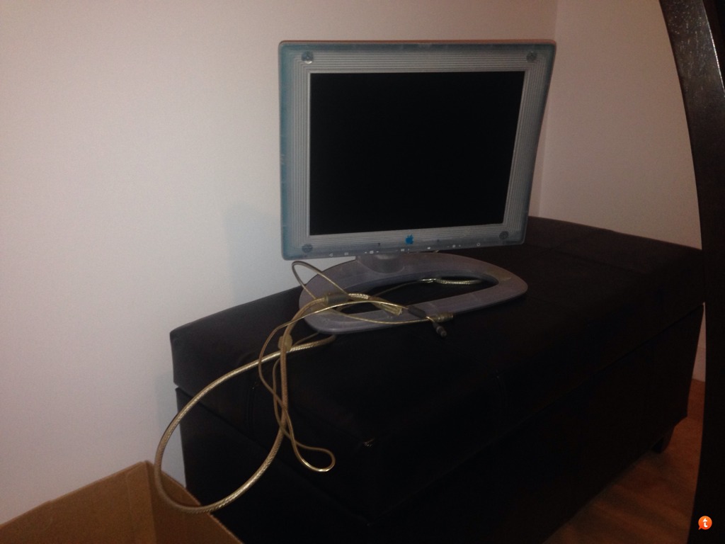

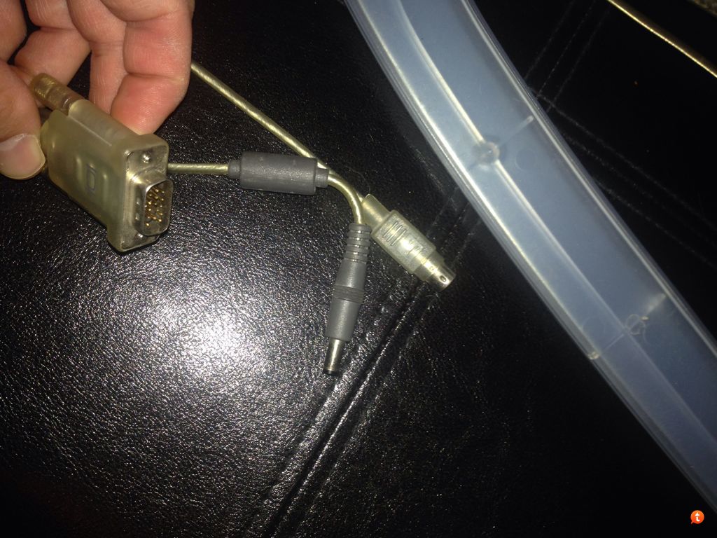

The blue Studio display you posted a picture of is the middle model of that line that has a VGA port. Your G4 has a VGA port and with a working power supply for the Studio display, it'll work with it. The ADB port does not need to be connected for it to work. Make sure the video source is set to computer, not video in.
I plugged it into the g4 vga port and nothing doing. Is it possibly it's just busted?

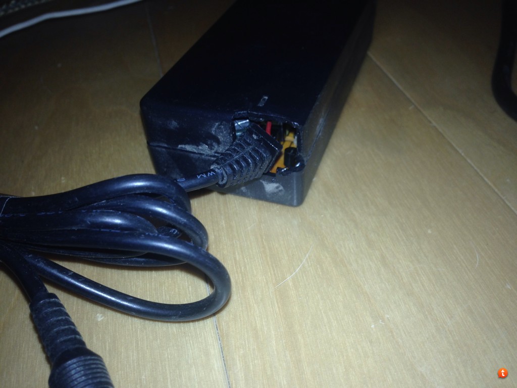

There's an external power brick for that display - 24VDC, I think. Can you measure voltage on that power supply?
It's possible that the video board in the display has given out. Be sure to try the display on other computers. It's a standard VGA connector, so should work on anything with a VGA output - doesn't need to be a Mac. (That's not to say that the video will be good, as there could be driver issues on a Windows system, but the screen should light up, and you should get _something_ generic/blocky on the screen.
Do you get ANY indication on the screen? Power light blinking or changing color?

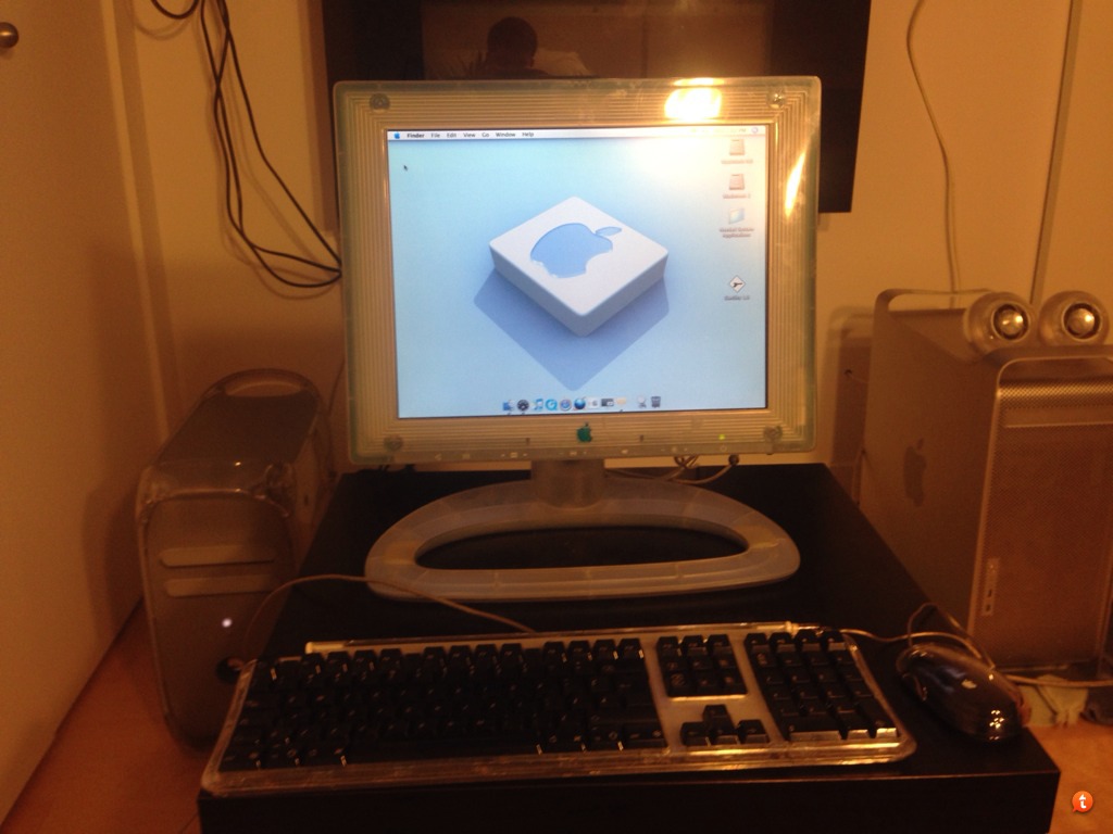

Found a powerbrick in the box I got it in but thought is was like the white apple cinema displays and didn't need it. got it working thanks!
Those old B&W Studio displays work well on any VGA computer, no drivers needed. They're rather dim and have a low resolution of 1024x768.
So far so good. The powerbrick is very damages but wires are hanging on. Screen is so cool and I'm glad I found these for sale!

Actually the speakers are connected to my g5 as I have a set of imac g4/powermac g4 speakers for this already. Just found the screen and speakers for sale and couldn't resist.
The brick is shot but works. I can feel heat coming from it and it's buzzing. Hopefully I can find something to replace it.

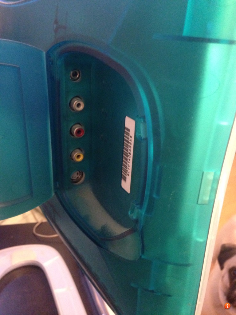

Yes, that one was to go with the B&W G3. The older model had DB-15 and ADB. The third blue Studio display is the least common. It's more black than blue. It was updated to have DVI and USB instead of ADB. It had an integrated USB port that was where the RCA video input was on the previous two models.
