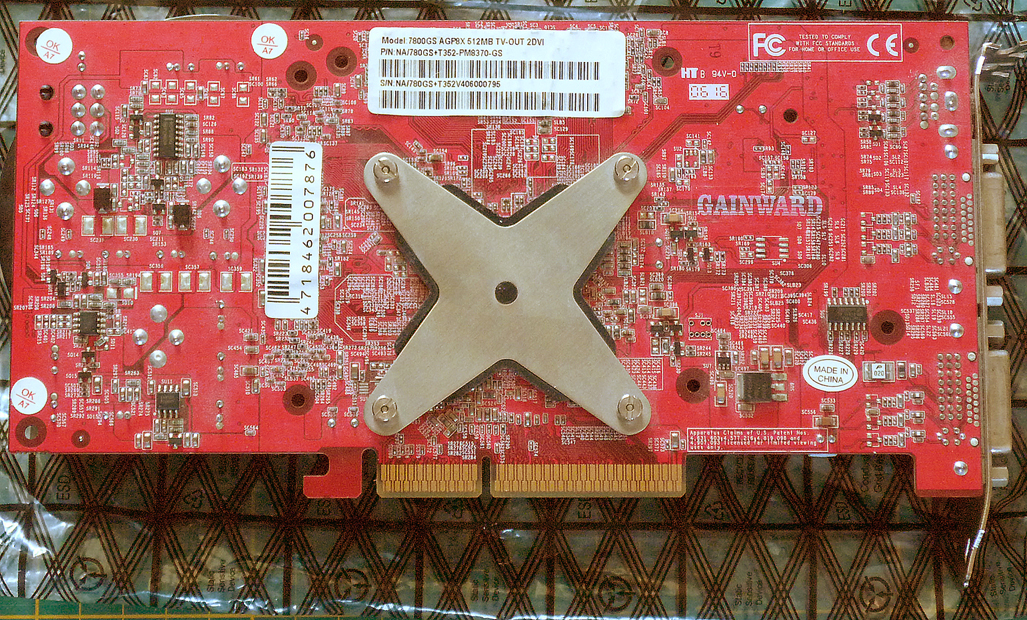

The pics show MPN: 471846200 7739, which would make this card mac flashable.
However, in the description it is listed as MPN: 471846200 7876, which would make this card not mac flashable.

This doesn't show it's rear, but in the description it is listed as MPN: 471846200 7876, which would make this card not mac flashable.

The pics show MPN: 471846200 7876, which would make this card not mac flashable.

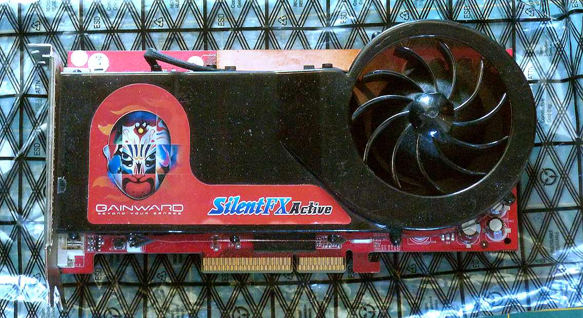

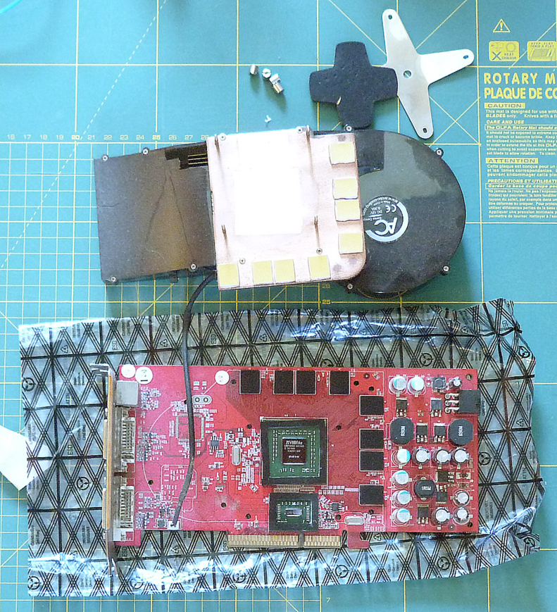

What do we have here?

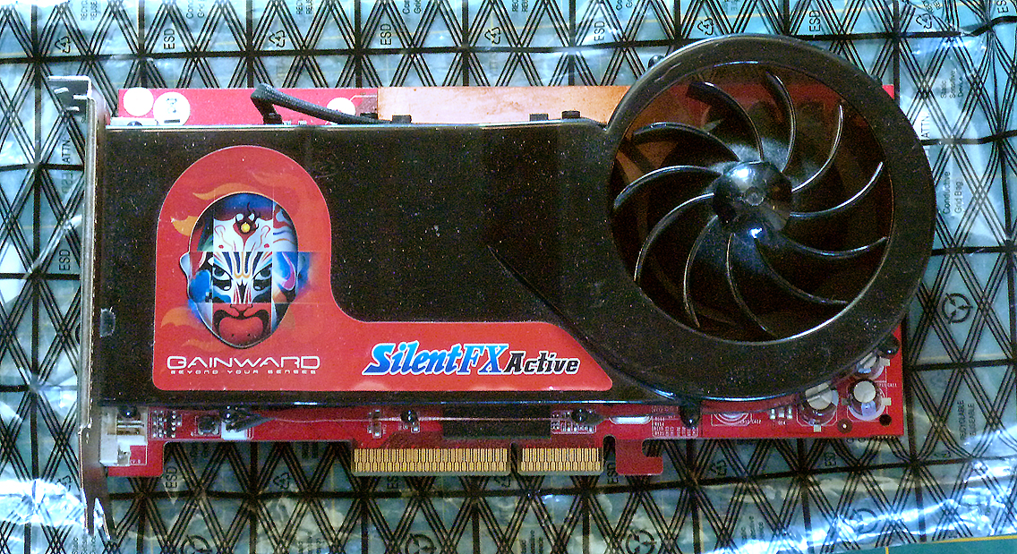

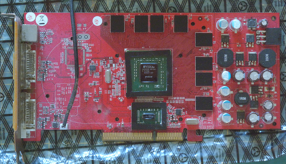

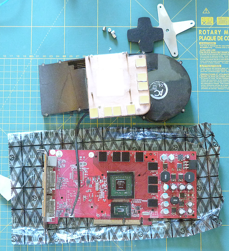

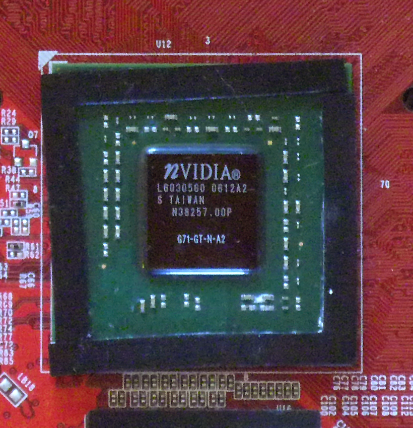

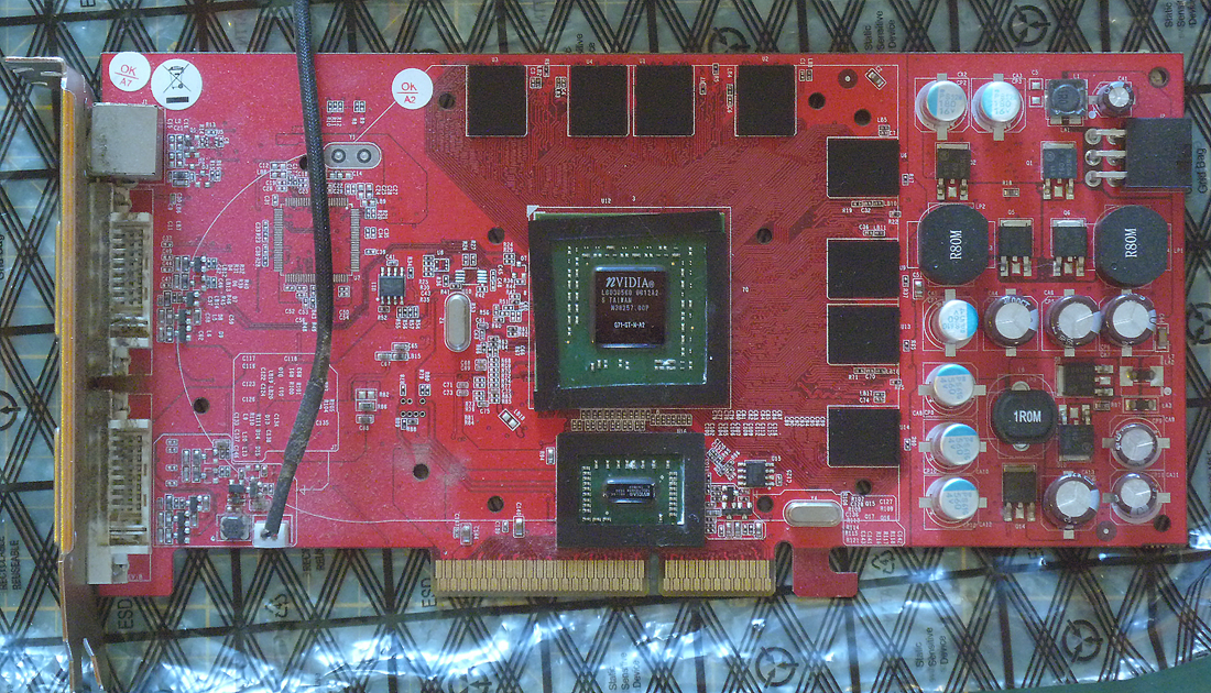

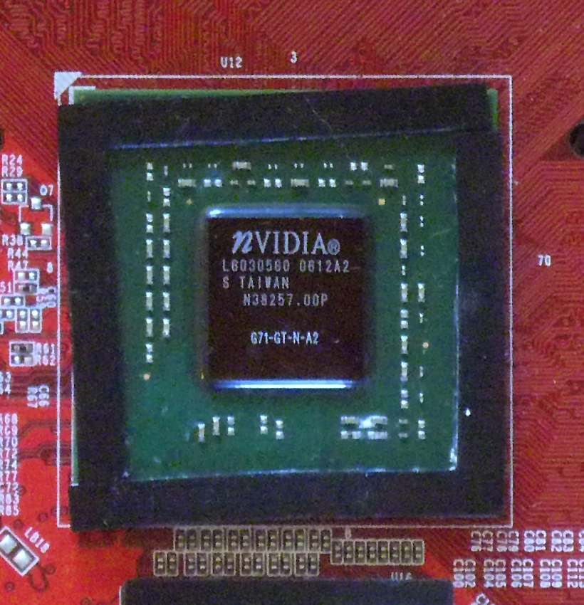

Oh wow, it's a Gainward Bliss 7800GS AGP graphics card! But does it have a G70 or a G71 chip?
Well, 7876, so that should be non mac flashable, but I've found a couple of references on teh internetz that some of the 7876 cards have G70 chips in them, so I'll just have to take off the heat sink...
The tension is mounting!
Doh!
Do you ever get déjà vu?
Hmm, it wasn't as cheap as the last one either.

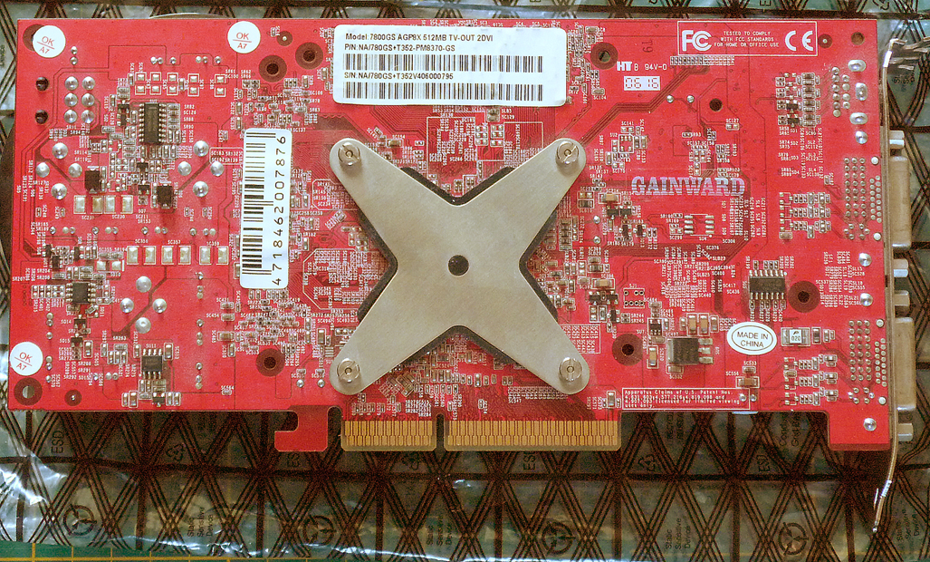

Looking at my card, it's has the bar code number ending 7876.
I can add this...
It's the later card with a different heat sink and smaller fan, looks cool, runs hotter.

Also, everyone knows that the 7800GS+ was the card from Gainward that fitted a G71 chip on a card with an AGP connecter, right?

Plus, I have found a couple of references to 7876 cards that have a G70 chip under the heat sink.
I wonder if any 8255 cards have a G70 chip hidden inside?
Perhaps even 8453 cards? Anyone know more?

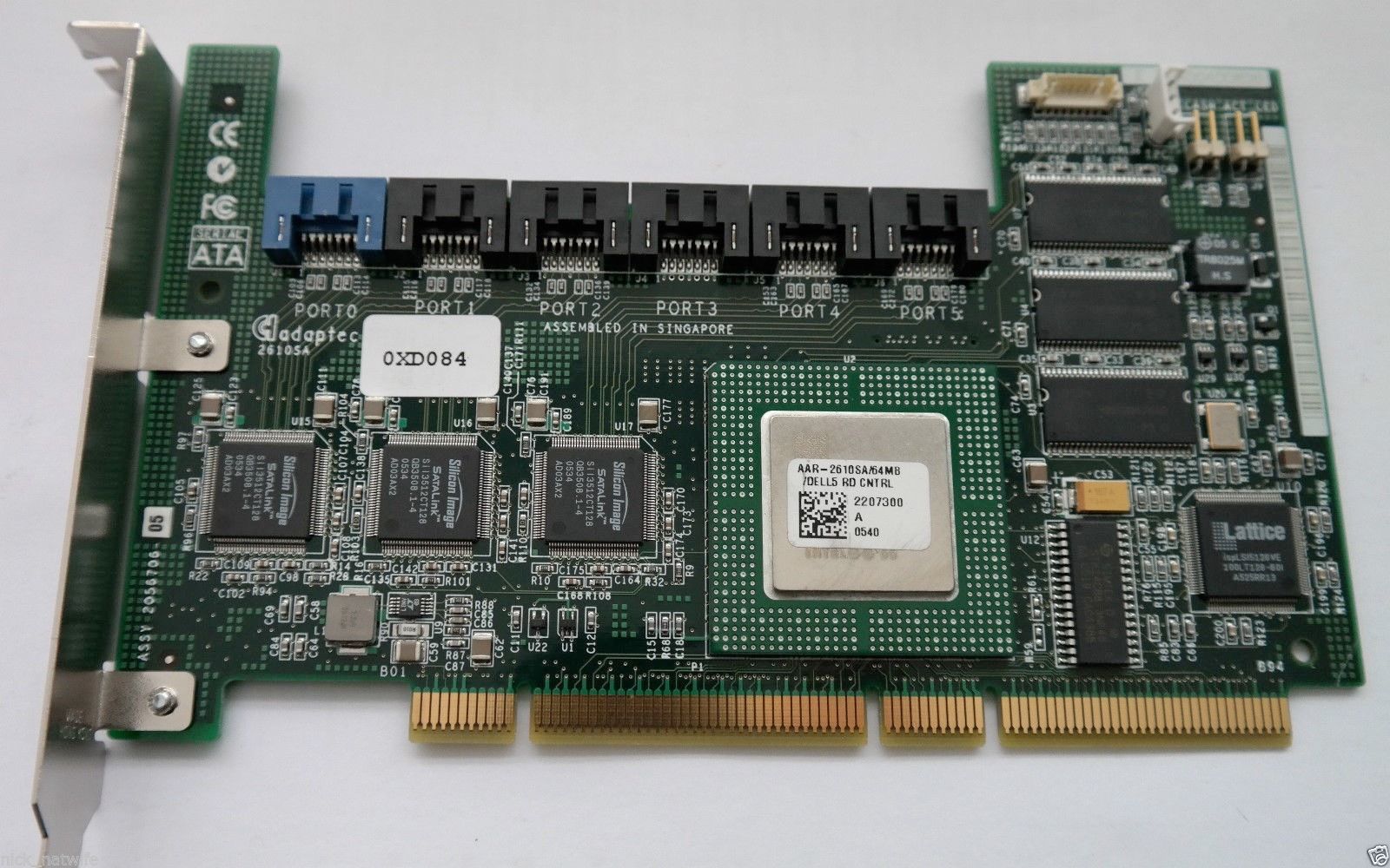

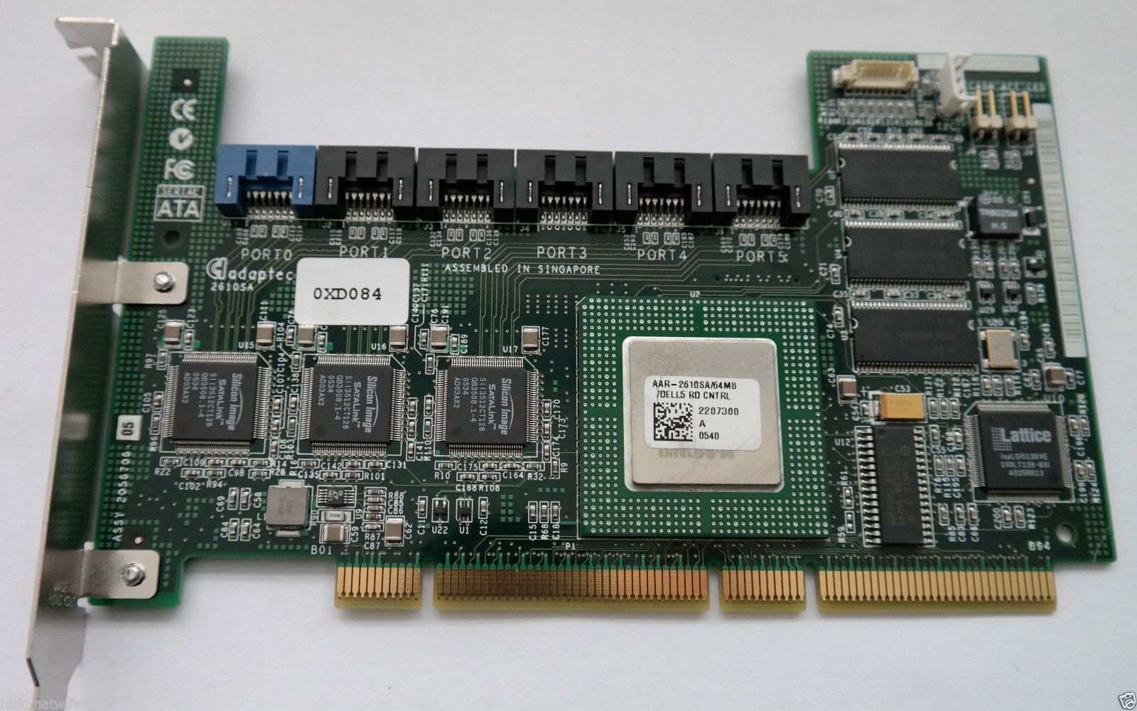

I just discovered the Dell WC192, a 6 channel SATA PCI-X card made by Adaptec. Also known as the OXD084 and OH2052.
It has 3 silicone image chips on board. Anyone know if it's mac flashable? Are there mac drivers for it?
Looking at the few pics where the numbers on the chips are clear, it looks like this uses sl3512 chips.
http://www.ebay.com/sch/i.html?_odk...I.TRS0&_nkw=Dell+WC192+Cerc+SATA+PCI&_sacat=0
http://www.ebay.com/sch/i.html?_odk...TR0.TRC0.H0.Xoxd084.TRS0&_nkw=oxd084&_sacat=0
http://www.ebay.com/sch/i.html?_odk...0&_trksid=m570.l1313&_nkw=0h2052&_sacat=58058
[doublepost=1464972111][/doublepost]This item has a sharp image, chip number is clearly legible, sl3512.
http://www.ebay.com/itm/Dell-Adapte...313753?hash=item41a4f3c699:g:LtUAAOSwQYZWx5xM

That does not work. The SIL chip interfaces with the onboard controller, which then interfaces with the computer. It is also really old, and is quite terrible.
Mac compatible SATA cards with more than two channels are tough to find, and I don't know if there are any with more than 4 channels.
The description doesn't mention it, I can read basic German and it's mostly about it being a private sale, and something about warranty. If you want to ask the seller about the product, I'm sure there's a German MR user that could help you.
