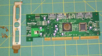

Tried a couple of SATA drives attached to the SIL3124 4-way SATA card. Some work, some don't.
Conveniently, the SSD and the WD 1Tb work fine (both blank) but the one I have with 10.4 loaded on didn't, so couldn't find out if it was bootable. I have another SATA drive somewhere, with Mac OS X on (I forget which one) I'll dig that out soon and try again.

If it is the card in the picture and you didn't flash it (sorry, if I overlooked it, in case you mentioned) and only installed the SIL drivers, then it is not bootable. I have a similar one (different PCB colour and the chip with the brown boarders is missing, rest the same) and I now and then recommended the card you pictured to some Forum members as a cheap method to get SATA.
IF you don't want to flash, you can use a SATA to IDE adapter and connect the drive to your IDE-cable, that will be faster already, since the difference is mostly in access times. (The ATA connector in the MDD will get you arround 60MB plus oberhead, while the SATA-card gets you ca. 60MB via PCI-X, too). If you are shopping for a SATA-to-IDE adapter be sure to get one with Manhattan chipset (usually they use a red PCB), I had no luck with others even from known brands like Delock.
Also be aware, that Green drives can be problematic. Some don't support sleep in Mac OS X. Some not being recognized could be, if the SATA speed has to be jumpered to lower speed (only present in WD SATA drives). Advanced format / 4k drives are sometimes problematic as well. E.G. I had luck with a SATA-III 3TB advanced fromat Toshiba (for 3TB, you have to format the drive with GUID under 10.5, it will only wrk as a data drive), but not with a 2,5TB WD Green drive, a 2TB drive from another WD Green generation had no problems, though (this was in a AGP G4).

@ Cox Orange, I didn't flash it, there is a lot of talk about flashing cards for Mac on the net, but actual How To's are almost impossible to find.
I have found a lot of old threads where some one asks "How do I flash this?" and the answer is something along the lines of "The answer is somewhere in this forum, if you can't be bothered to spend six month reading every post on ever possible thread, then I won't help you."

As for flashing SATA cards .... I'd like to, but I've found next to nothing, just you need Tiger and you boot in safe mode (then what?) and you need the correct Mac bios.
I have a SATA to IDE adapter, it appeared to work the first time I tried it and I haven't managed to make it work since. :-c

Regarding the SATA-Card. Did yours work out of the box? Or did you have to download the SIL-drivers (which makes the card work for data drives, but desn't enable boot). Drivers here http://www.drivers-download.com/en/downloadlist.php?id=72
RE flashing There is a guide with a link to the ROM here on the forum that is on page 1 (downwards) or page 2, because it gets new requests and answers now and then, but it is for another SIL chip. google "Guide to flashing SIL3112 SATA cards for mac macrumors"
There is also a Thread where I tried to gather the options, with notes. It is very incomplete and not precise, but you can start from there. https://forums.macrumors.com/threads/pci-sata-cards-what-is-the-state-of-compatibility.1650568/
Personally I didn't ever bother flashing a SATA card, because I got a Sonnet 2port and a Macally one (2 SATA, 2 eSATA and IDE) and a PC-SATA card I use for data drives.

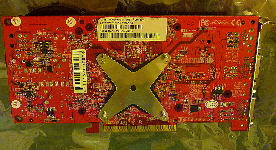

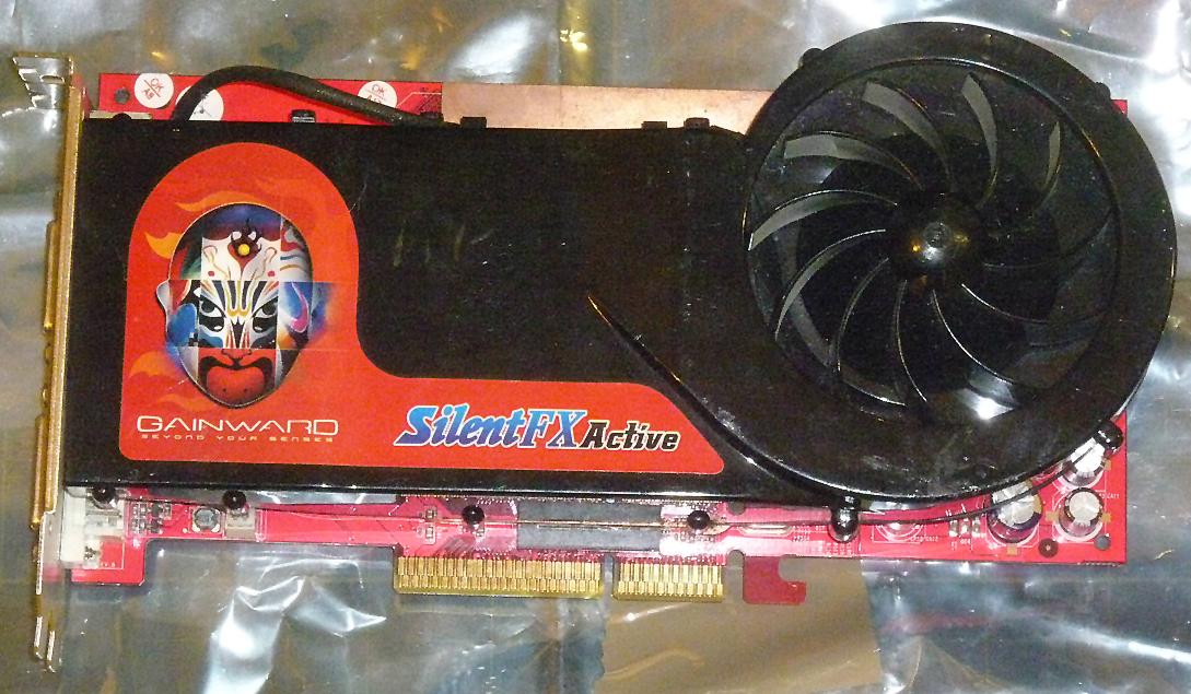

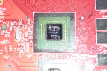

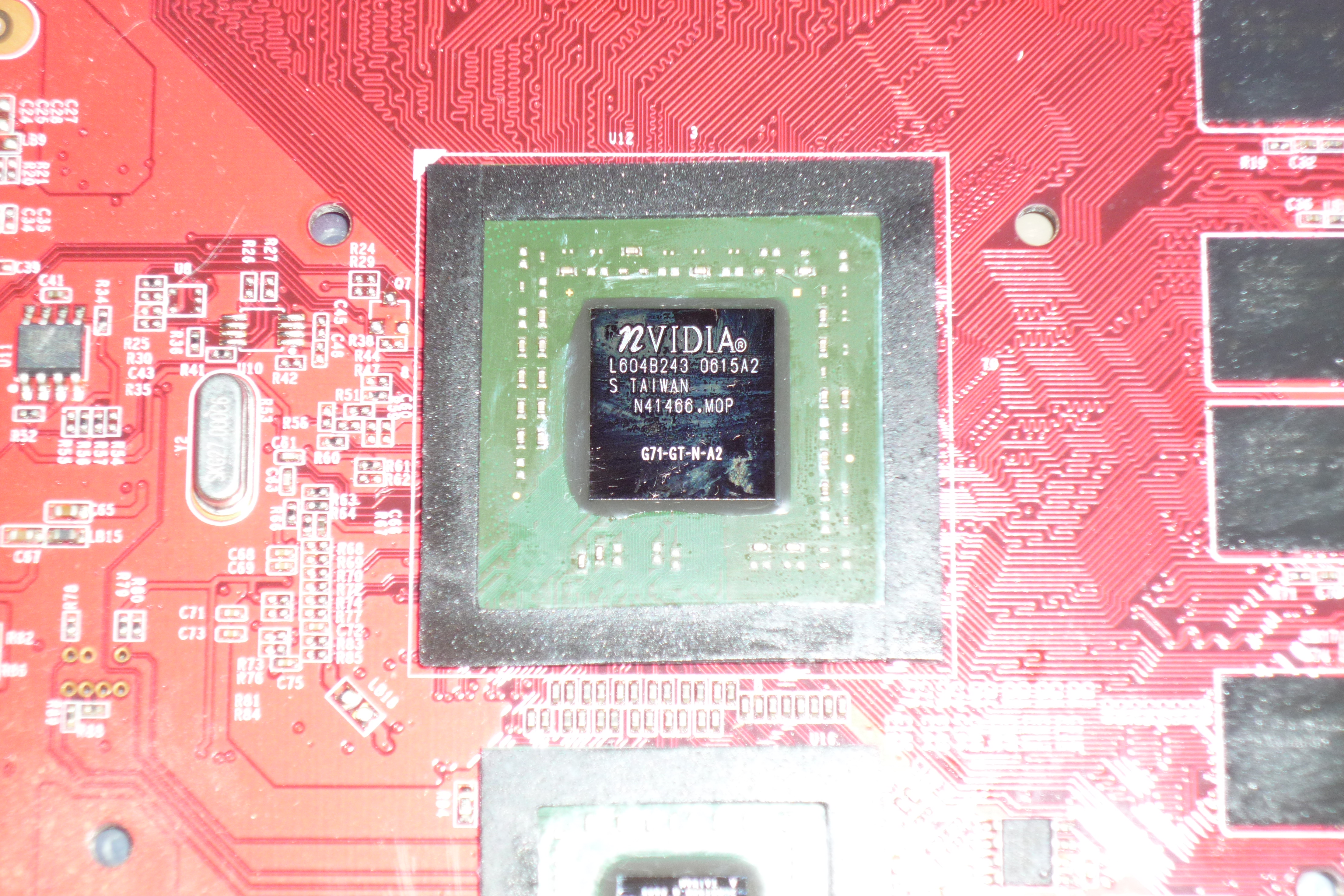

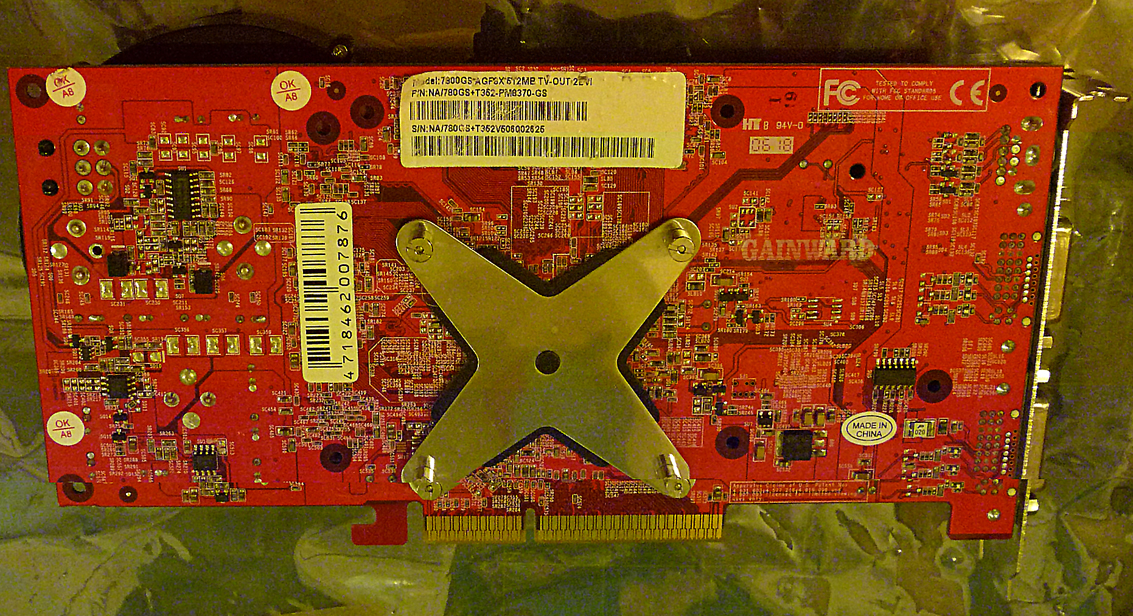

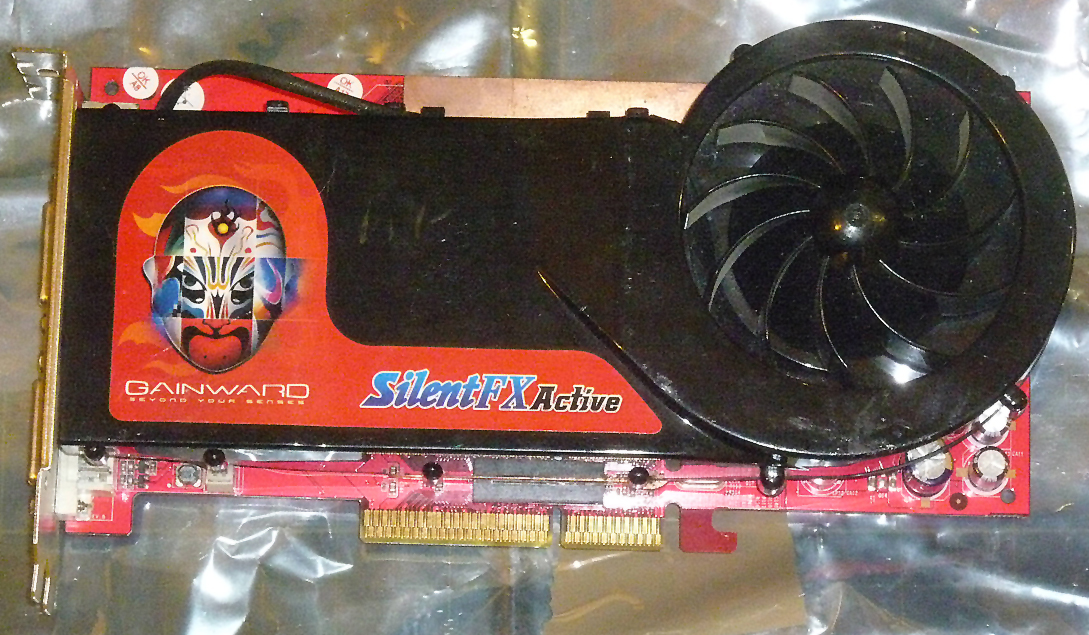

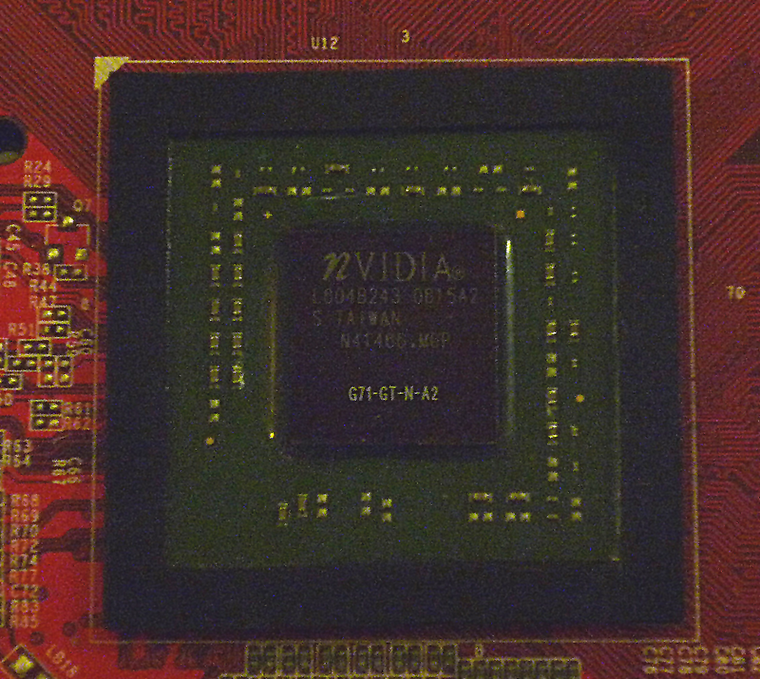

What do we have here?

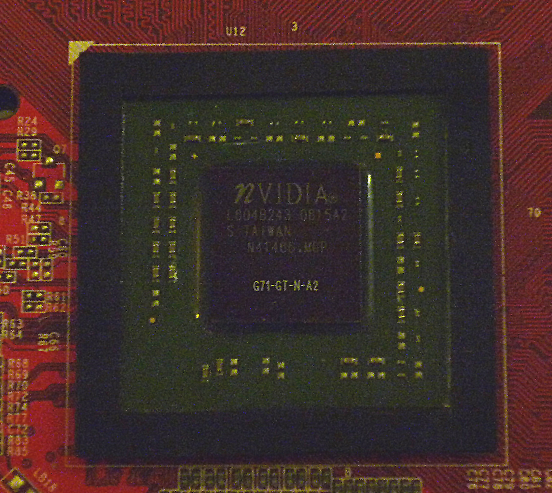

Oh wow, it's a Gainward Bliss 7800GS AGP graphics card! But does it have a G70 or a G71 chip?
Well, that's no help, I'll just have to take off the heat sink...
The tension is mounting!
Doh!
Oh well, it was dirt cheap, the seller didn't know what they had. Or maybe they did.
Anyone want to buy a used and non mac flashable Gainward Bliss 7800GS?
Something I found no teh internetz...
https://forums.overclockers.co.uk/showthread.php?t=17863200

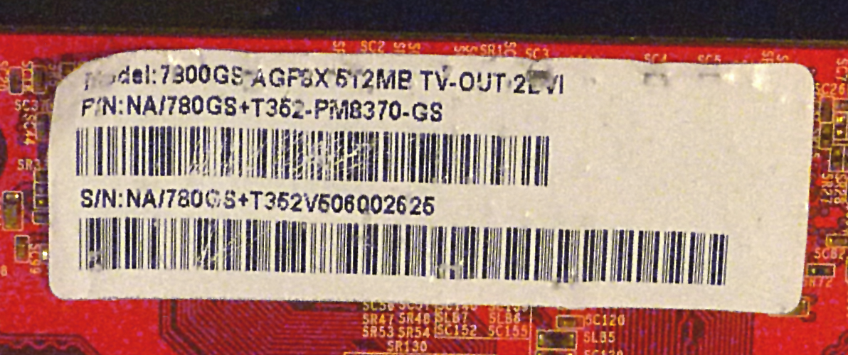

"AHA! Just found this... Typical!
There are 3 types of 7800GS:
Gainward 7685-BLISS 7800GS 256MB TV-DVI AGP
Gainward GeForce BLISS 7800GS
Chip: 7800GT
Memory capacity: 256MB 1,6ns DDR
Clockspeed Core: 375MHZ
Clockspeed Mem: 1200MHZ
Pipes: 20
Gainwards barcode: 471846200-7685
Gainward 7739-BLISS 7800GS Silent 512MB
Gainward GeForce BLISS 7800GS AGP 512MB
Chip: 7800GT
Memory capacity: 512MB 1,4ns GDDR3
Clockspeed Core: 425MHZ
Pipes: 20
Gainwards barcode: 47846200-7739
Gainward 7876-BLISS 7800GS Silent 512MB GS+
Gainward GeForce BLISS 7800GS GoldenSample AGP 512MB
Chip: 7800GT
Core: 450MHZ
Mem: 1250MHZ
Pipes: 24
Gainwards barcode: 471846200-7876"
Looking at my card, it's has the bar code number ending 7876.
Err, I hadn't really thought about an amount, cost me a little under $20 shipped.
Here, I usually see these cards for sale for over $70, and usually that's PLUS shipping!
IDK if it works (in a PC) or not, I haven't tried it.
I reassembled it after removing the heat sink, using Arctic silver thermal paste on the two main chips, but nothing on the ram.
I planned to test it on the flashing PC, but that's still a collection of unassembled components. Last weekend I was busy helping a friend, so it didn't happen as I had planned. This weekend, maybe a trial build up?
(still don't have a DOS boot disk though)
As for price, I was thinking maybe shipping plus $10?
I'll look into shipping costs.
