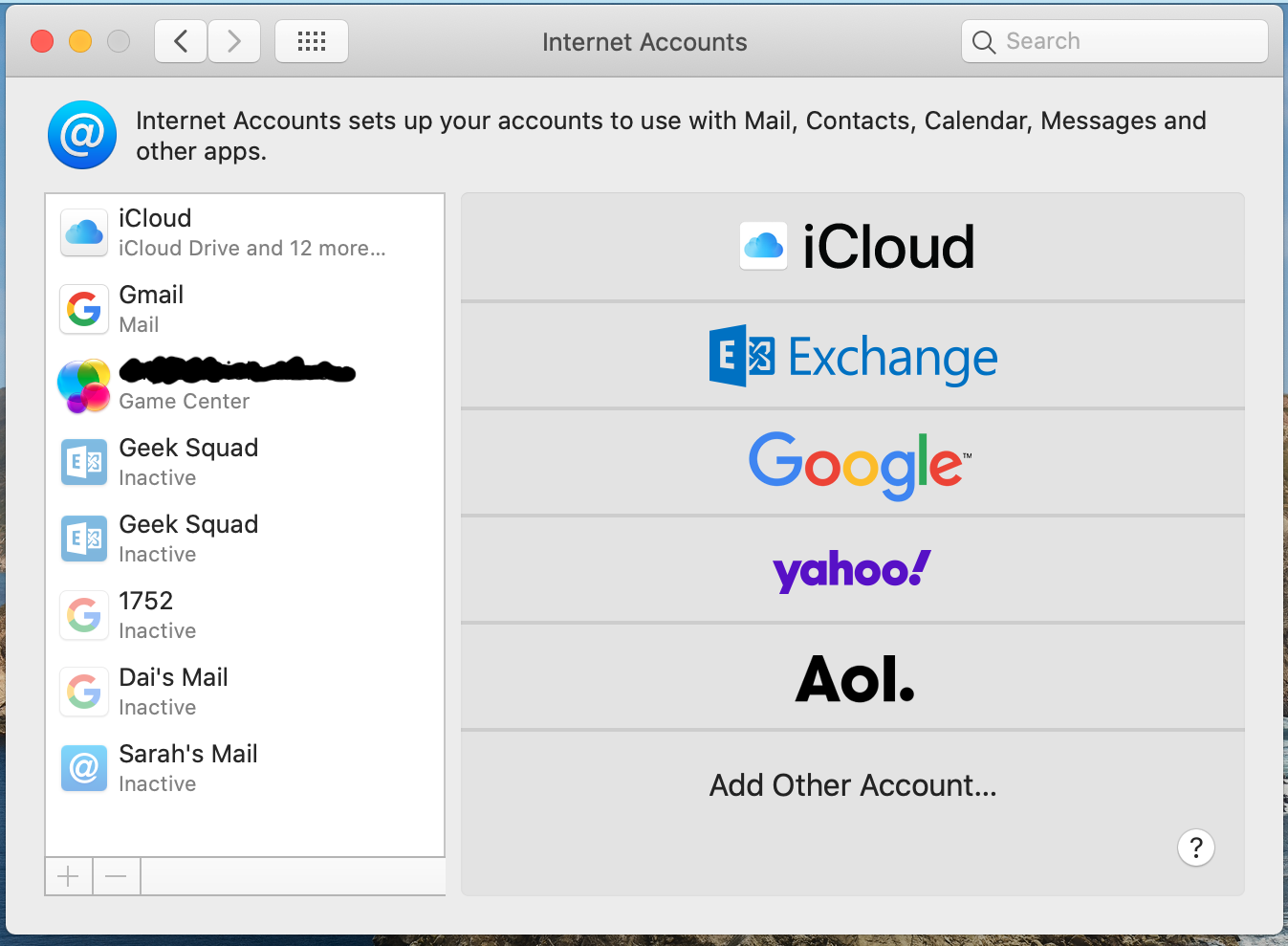

Set my new Mac up as new this week, so I could leave some old accounts behind as I no longer work for the company they were associated with, however every time I set my Mac up I get all these old inactive accounts pre-populated in my mail account settings (see attached screenshot). They're a mix of different account types too.
How do I stop this from happening? This has been an issue for years for me, but only now is a bigger problem because the accounts don't even work anymore since I've left the business.
Obviously they're linked to my iCloud account in some way, but these accounts aren't set up on any other device that I'm currently using. Apple or otherwise.

They're synced via iCloud keychain, but it happens inconsistently. You can just highlight the accounts you're not using and click the minus sign at the bottom. Eventually they should go away from the keychain sync.
Eventually, yeah ... I am still getting accounts randomly appearing from years ago. I wouldn't hold your breath.
Thought this too, however I went through a stage late last year where I had zero Apple devices active, and subsequently found out that by having no devices active, your keychain data gets purged.
When I got back to Apple devices, my keychain was empty with no passwords present. But these old accounts are still there.
Guess they're determined to stick around.
