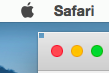

What about Brightness? Why I can't change it? And sleep? Why I can't wake up my machine after it went to sleep? Anyone knows how to FIX this type of window glitch?
Download "No Sleep" from the Mac Apple Store. It's the only workaround. The sleep/wake/brightness should be managed by the frame buffer kext. I see that if I modify the brightness in Lion Yosemite reports that number of bars (so it does read the value in NVRAM). But the brightness level is always at max. My only hope is that it has something to do with the boot.efi not communicating correctly, that could be fixed. Otherwise with the vanilla OS and these kexts I am afraid there is no solution.
Regarding the little glitch in the Messages window corner.. I dunno. It is there. But Messages works just fine (after you set the NVRAM). It isn't something to lose the sleep over.
