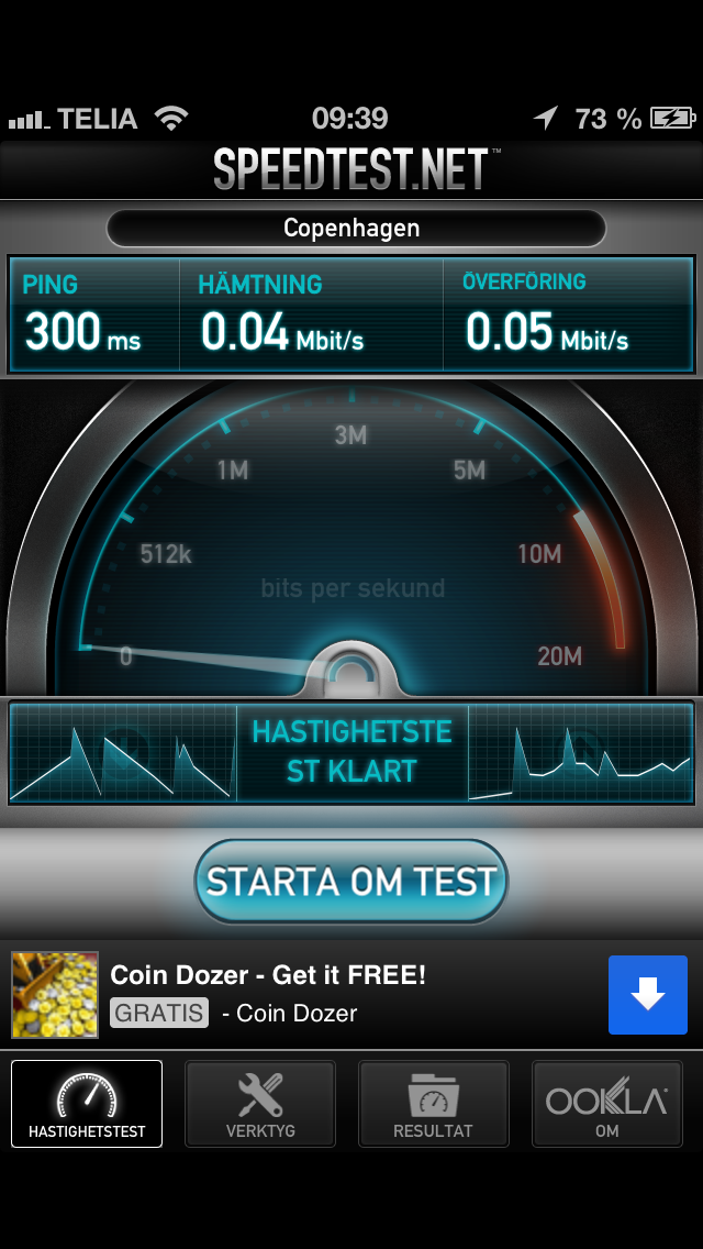

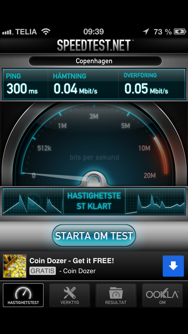

Ive managed to get mine working at present, configuring my 2nd router on my home network with WPA only, not WPA2. Seems to be holding up so far.
Why should we be having to go through this though? Its a complete joke to be honest.
sweet.. 😡
Edit: now that wifi is blasting again ... my God whatta Phone 😀
