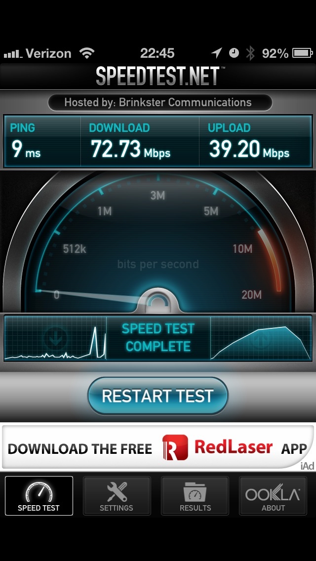

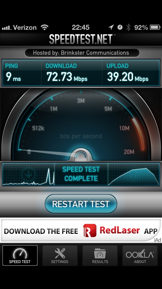

My launch iPhone 5 had WiFi issues. Could only get about 1-2 Mbps down. Interesting enough, my upload speed seemed normal... about 4-6 Mbps up.
Today I got a replacement from the Genius Bar that seems a lot better. Look:
From my iMac:
From my iPhone 5:
From my iMac:
From my iPhone 5:

Please post an update if your issue returns. Also what is the beginning part of your new phone's wifi address?
Great outcome. Please do post which chip you have.

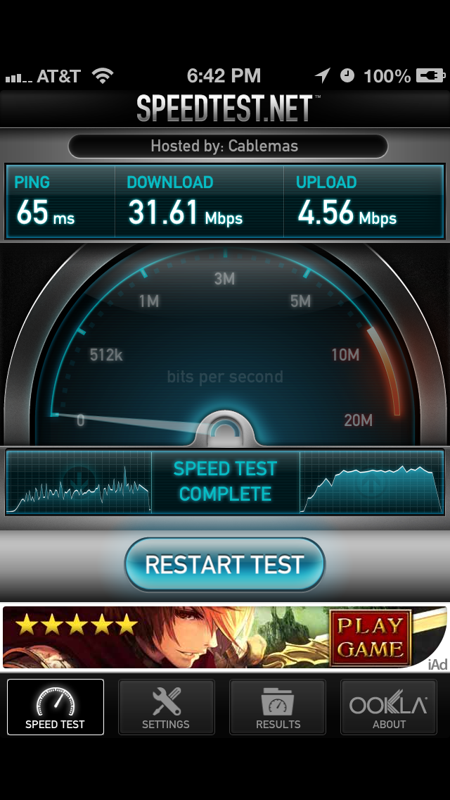

No speed issues here. AirPort Extreme on the 5ghz band.
98:b8 here and I am able to get 31 Mbps down on WiFi...
