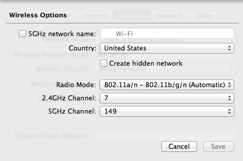

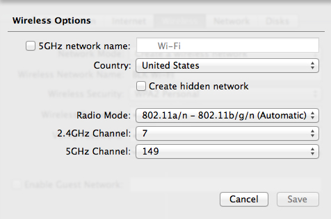

i've had extremely slow wifi since upgrading to iOS6 on my 4S, read tons of threads on the net and tried a kajillion different things. today i finally fixed it!! here's what fixed my slow wifi...
opened up Airport Utility app for the Airport Extreme went to Wireless settings, clicked on the Wireless Options button and changed the settings to this (see pic below).
i downloaded an app from the net called iStumbler which shows all the neighbors routers and what channels they are using, based on that i selected channels that were not in use. before i did this i had both the 2.4ghz & 5ghz channels in Automatic.
wifi on 4S went from .5 mbps back up to normal which is 25 mbps 🙂
