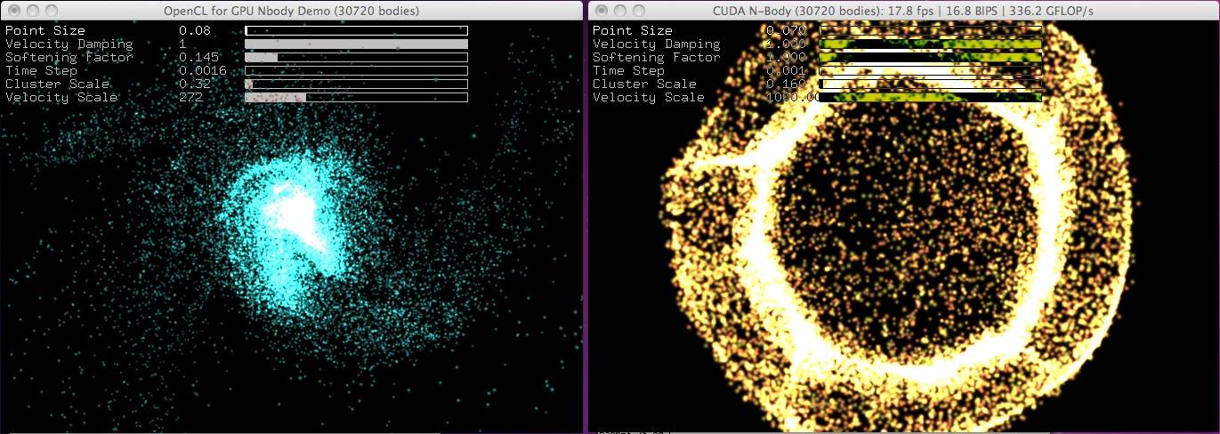

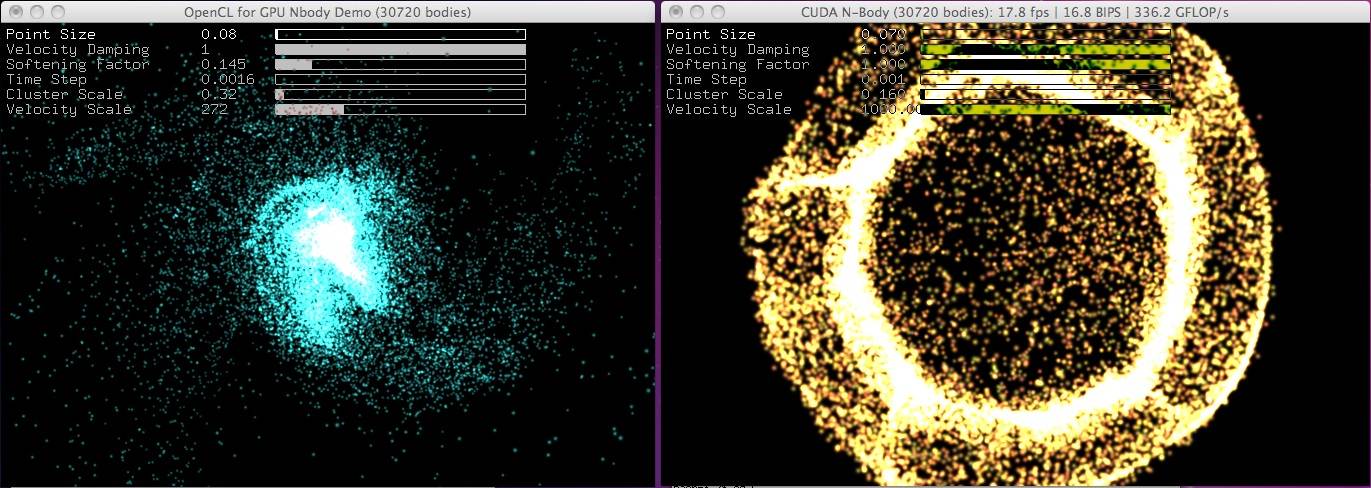

I cannot resist posting this shot. nbody running under both CUDA and openCL together. one on each of a Mac 285 and injected PC 2G 285. It's a measure of just how good netkas' injector is!

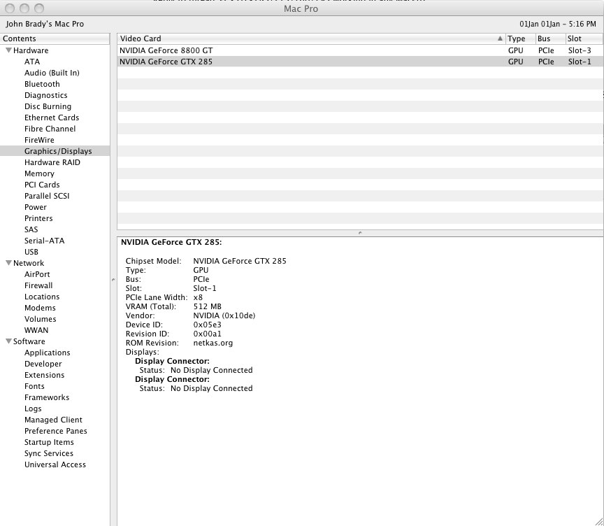

So I've got a GTX 285 card in my 08 Mac Pro with the Mac 8800GT as the helper card.
The GTX285 is in slot one and the 8800GT is in slot 3.
But in the info as per the attached screen cap the GTX 285 is showing up as being in an 8x slot, it is also showing 512mb despite being 1gb and it's not showing the attached screen.
Is all that normal, and is there a way to check what the speed actually is and the real memory amount being used.
It is definitely more capable than the flashed 4870 I had in my last Mac Pro. It can comfortably run COD4:MW at 2560x1200 where the 4870 struggled a little bit, so I'm assuming it's doing ok.
Not to mention it being a hell of a lot quieter than the 8800GT

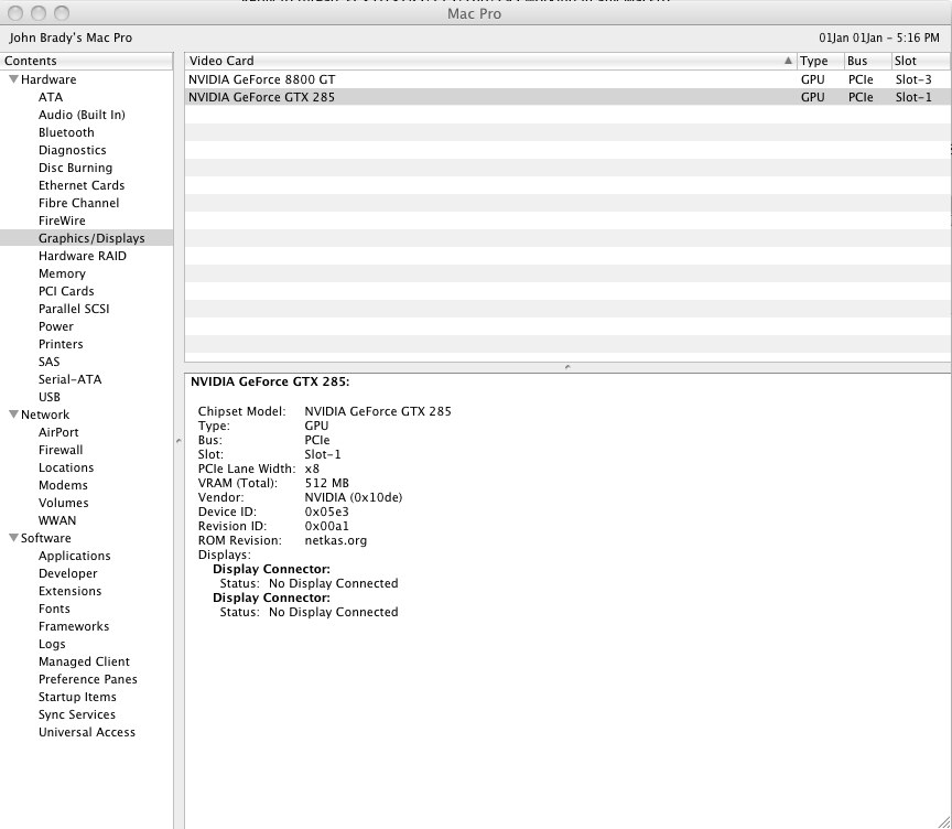

The memory question has been dealt with here before, you will need to read the thread completely.
The 8X slot thing is interesting, I have found that this will sometimes change between boots.
Ultimately, benchmarks are going to answer the important questions.
