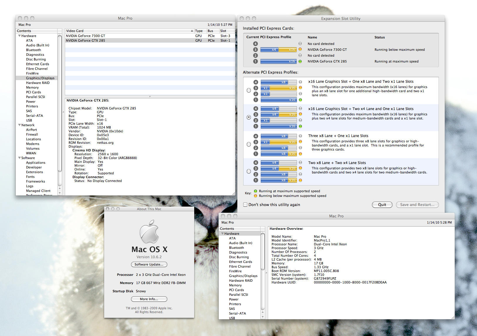

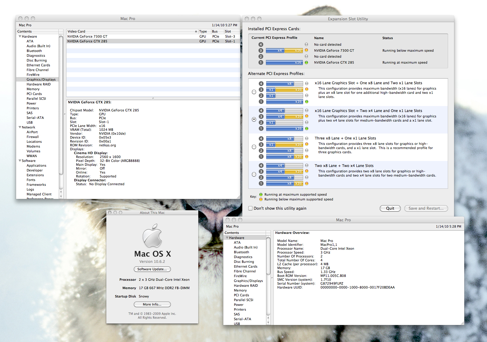

Confirmation this still works in 10.6.2
As there seemed to be doubt as to whether Netkas little trick still works....I tossed in a GTX285 yesterday and gave it a shot.
Works fine...makes COD4 playable at the same "High" settings that an 8800GT CHOKES on.
The RAM shows up with correct amount because I patched the patch.
GTX285 running on a First Gen. Nice card and a nice trick, courtesy our dear friend Netkas.

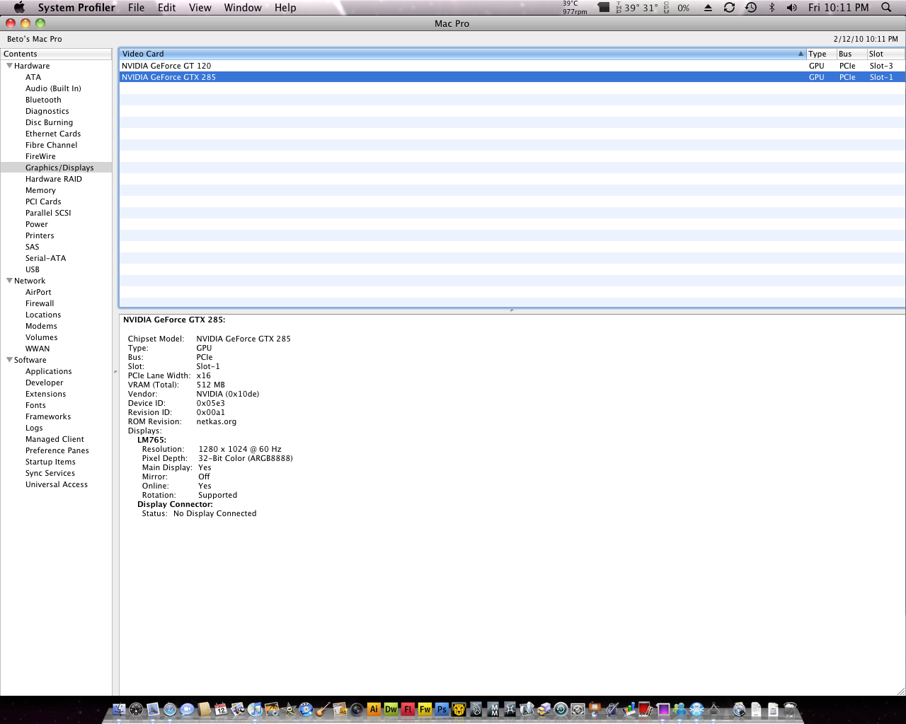

I installed the netkas injector, now my GT120 and my GTX285 are living happily on my MacPro4,1 but system profiler doesn't show core image/quartz extreme enabled on the gtx 285 but it does on the GT120 What gives??? Also how can i verify cuda is running? Im running 10.6.2
