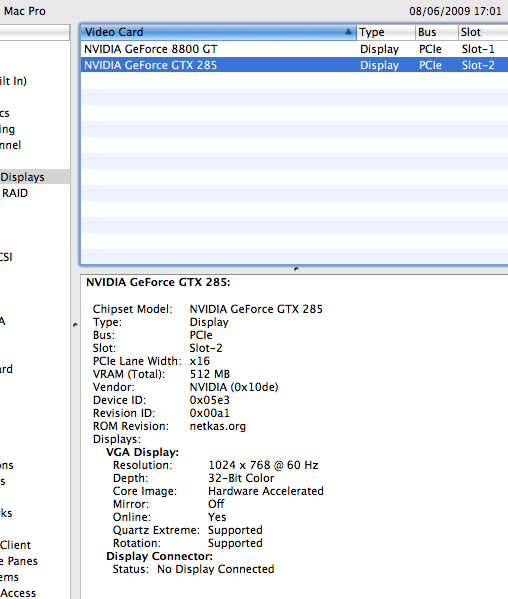

woot, just got right nvcap(same as for 8800gt_mac) from somewhere, will make an injector in few mins, anyone willing to test ?
Netkas is genius - official
Macenstein lives - OpenGL etc to follow. n.b. VRAM funny but we are nearly past caring

seems like kext fails to read vram size of unPOSTed card, in this case, it gets VRAM,TotalSize from plist, you can edit plist of aty_init and change there Vram,totalsize value in nvidia section (use property list editor from xcode ).
its little endian 32-bit value there, in your case, you need to multiple value by 2.
